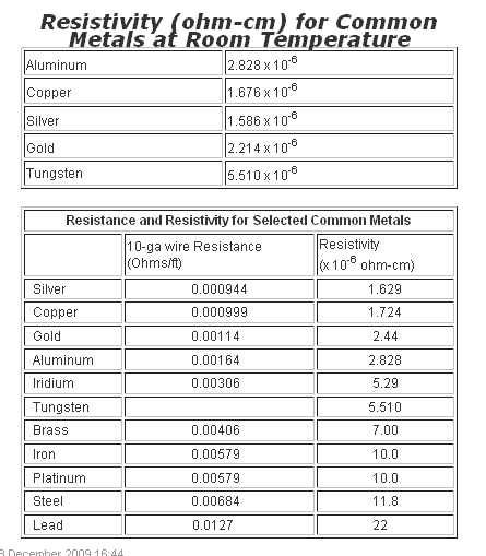

| Quote: | Bob,
I'm not sure where you got those "relative resistivity" numbers below, as I've always seen metals and other substances' resistance described as Ohms/meter. However, I checked the resistance of silver over copper and compared them to your numbers below (15.9/17.1), and the ratios are the same. |
There's a fist full of ways to describe the relative
resistance of materials. Obviously, it's a volume thing.
A bar of copper 1" square and 10' long will show a much
lower resistance than a .1" square that is also 10' long.
Any chart that speaks to relative resistivity of materials
will be incomplete without building definitions around
the samples for which the numbers are cited. For example.
Here's a chart I found on the 'net . . .
http://tinyurl.com/3w4m4kp
[img]cid:.0[/img]
Some resistivity charts have been published using copper
as a baseline and assigning it the value 1.0 with all other
metals compared to copper. Similar charts have been made
with silver having the base-line assignment of 1.0. MOST
such charts are used to calculate the ratio of RELATIVE
resistance between two different materials.
The chart above does us the service of adding a cross-section
that's well known, like 10AWG wire. Note the similarity
of this value to the resistance for copper wire published in
the 'Connection. VERY close to 1 millohm/foot.
RESISTANCE is always a point-to-point measurement like
from one end of a resistor to the other, two different
points in a circuit, one end of a wire to another. The
value observed may be the sum effects of many resistances.
RESISTIVITY always speaks to the volumetric resistance
of a homogenous but otherwise single material . . . like
a bar of brass, copper or stainless steel.
I just want to point out that gold should be in there between copper and aluminum. Gold is widely used in the electronics industry to plate connector pins and sockets, on integrated circuits to connect die to pins and pads, and on circuit board pads. No doubt there are countless other uses for gold in electrical circuits.
Eric's fat wires are a great trade off between resistivity, weight and volume. It's one of the best simple ideas to come out of the aerospace industry. My hat off to Eric for being one of our vendors!

Without going into detail of units etc, the relative resistivity of common
conductors is as follows. The best common conductor is silver, with copper a
close second. Stainless is waaay down the list. A smaller number represents
a better conductor from a purely conductive viewpoint. (The smaller the
number the less losses) Best to stick to copper conductors wherever feasible
with the possible exception of Eric's copper clad aluminium for very long
heavy runs. ( http://www.periheliondesign.com/fatwires.htm )
Silver 15.9
Copper 17.1
Aluminium 26.5
Brass 64.0
Mild steel 180
Stainless steel 720
Nichrome 1500 (used for heating elements)
Bob McC

Thank you very much, Ron. I checked out your website and found one link to a "relative resistivity" chart that I really like. It's really a relative conductivity chart, which is of course the reciprocal. It shows copper to be 100%, and it compares everything to it. Silver, for example, has a conductivity of 105%.
I really like this chart and info below it. It says that although brass has a large percentage of copper, its conductivity is degraded much more by the additive metals than the percentages of them in brass. I never use brass for electrical conduction, although it can be used for RFI shielding.
