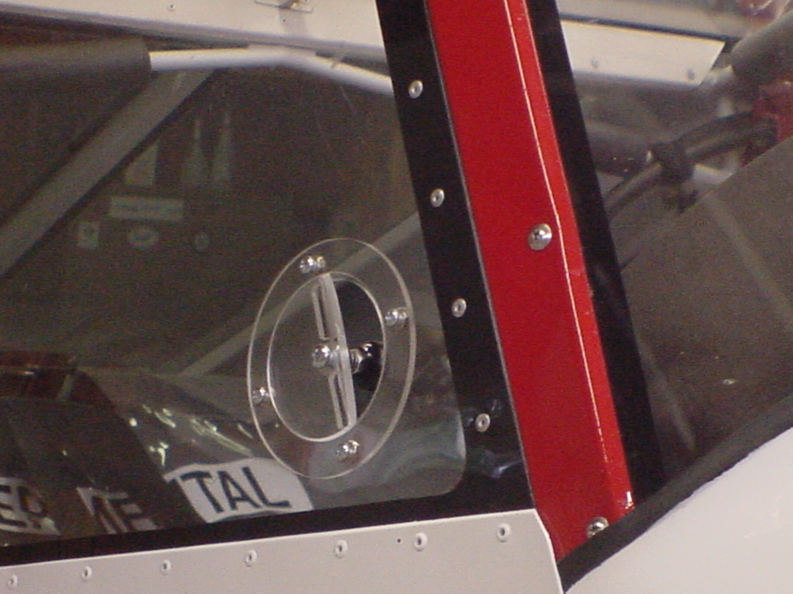

PostPosted: Sun Nov 14, 2010 5:22 am    Post subject: Re: cutting windshield Reply with quote
I really like the idea of keeping a plywood template. What I've done to add to the windshield is to mask off about a 1 inch edge along the inside of the windshield and door windows. Then spray flat black paint in order to give a clean sharp edge. Looks great!
 Filesize:  699.99 KB
