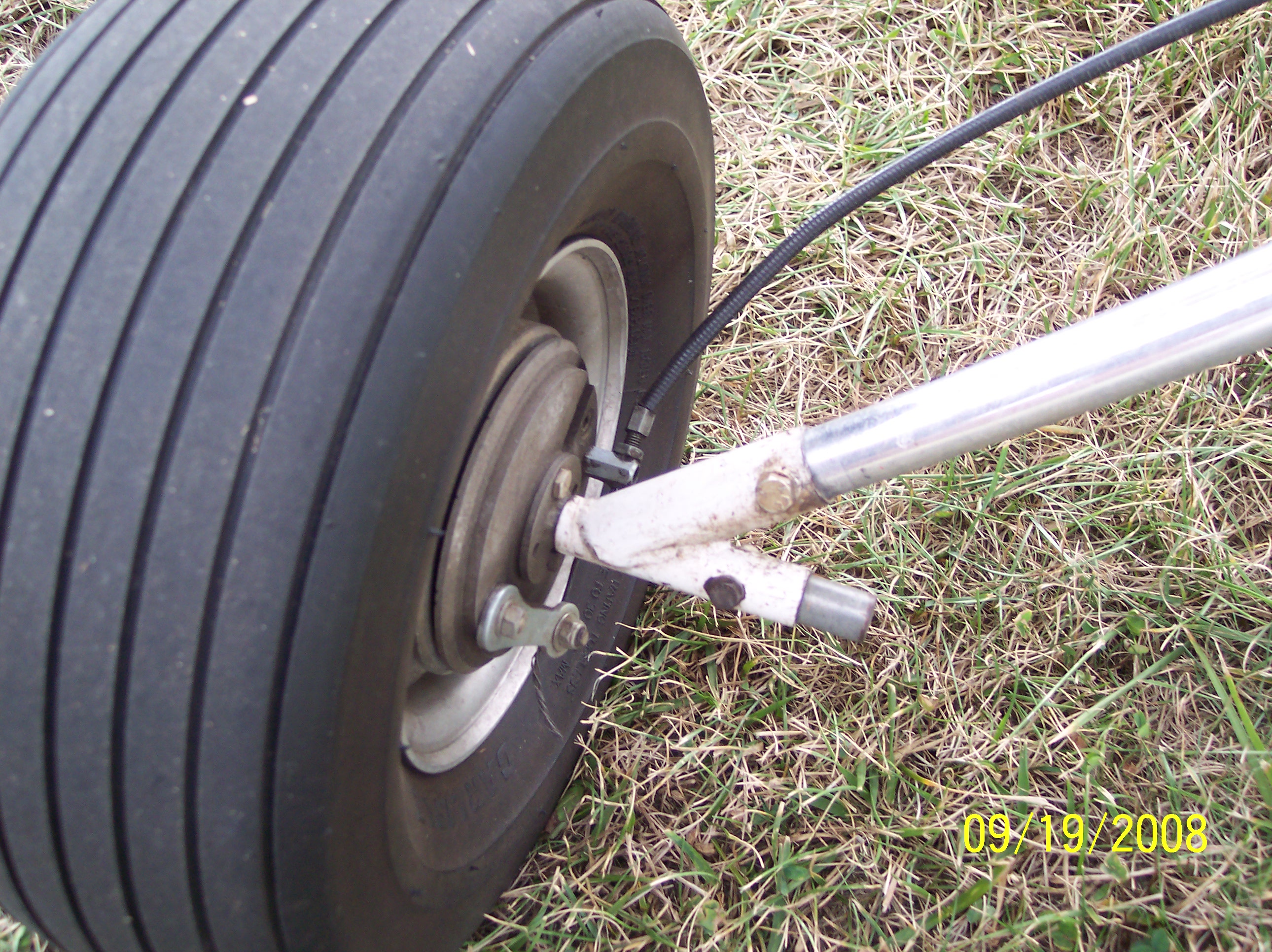

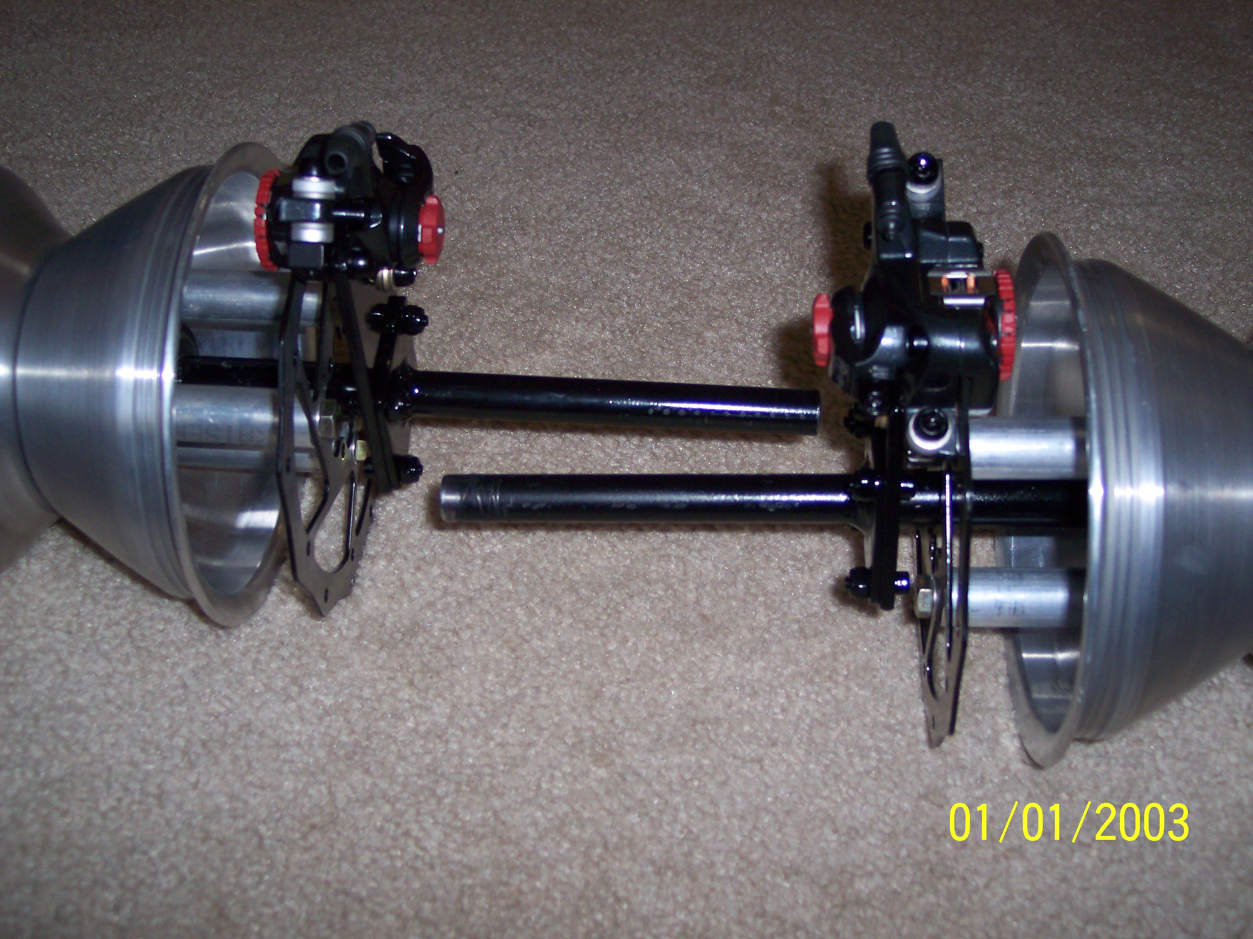

PostPosted: Wed Oct 20, 2010 5:43 pm    Post subject: Re: Another wheel question Reply with quote
What is the correct toe in and will that be with the tail wheel on the ground or elevated a bit? Ready to install my brakes with the new style axle to leg attachments on my Firestar KX. I am thinking no toe with tail on the ground and when the tail comes up there will be some? Any tips would be great.
Thanks The existing tires appear to be toe out until the tail comes up then they appear straight. It seems to handle fine on the blacktop and grass.

PostPosted: Thu Oct 21, 2010 6:40 am    Post subject: Another wheel question Reply with quote
be great.
Dennis
The instruction manual for my mark III says " the wheels should be
aligned as shown: Parallel with the centerline axis of the airplane. If
you must err, err on the side of having the wheels toe out a bit. Do not
have any "toe-in""
I know that there has been conversation on the list that toe in is better,,
toe out is better,, straight is better...
Which is the best maybe I don't know,,,, but the above statement is from
the kolb instruction manual. Take it for what it is worth. My mkIII works
well on pavement.
Boyd young mkIII
mdnanwelch7(at)hotmail.co
PostPosted: Thu Oct 21, 2010 7:33 am    Post subject: Another wheel question Reply with quote
> Boyd young mkIII
Boyd, Dennis, group,
  I recall (clearly) the last time this subject came up.  I had set my own "toe setting"
within a few days of the previous discussion.  I set my newly-built steel gear legs to
have slight toe out.  This is what the Kolb manual said, so that's what I did.
  I read somewhere a long time ago that a taildragger airplane should have slight toe-out.
The thinking is that if one wing is raised, the remaining rolling tire will try to drive AWAY from the
raised wing, causing it to lower.  In the fast and furious events of a raised wing landing,
whether this really makes a difference, I don't have any idea.  But that's the theory.
  I also remember John H said he had slight toe-in, and Kolbs like a little toe-in.  If that
is true that Kolbs like a little toe-in;
A) he'd probably know, more than anyone else
OR
B) a little toe-out, a little toe-in, or straight may not make any noticable difference
whatsoever.
  I think the latter may be the truth of the matter.  Go with a straight toe setting,
and you won't know the difference.
  From my math calculations, I came up with a 2 degree toe-out for each tire, on my plane.
I think if I were doing it again, I think I would set them straight and not think about them again.
To look at them, they appear to be straight.
  If I remember correctly, measured at the front of the tire, if straight were zero, toe-in would be
about an 1/8th", and toe-out is about an 1/8th".
  I'd go with the Kolb recommended setting....set them straight, but if you are going to err,
don't err, just set them straight!!!
Mike Welch
MkIII,  getting closer all the time
jbhart(at)onlyinternet.ne
PostPosted: Thu Oct 21, 2010 9:35 am    Post subject: Another wheel question Reply with quote

PostPosted: Thu Oct 21, 2010 10:58 am    Post subject: Another wheel question Reply with quote
works
well on pavement.
Boyd young mkIII
Boyd Y/Gang:
My mkIII also performs well on pavement with 800X6 Air Tracs. I set mine up
neutral, but there must be a tad of toe in because the gear will spread when
pushed backwards.
Rock House, OR
PostPosted: Thu Oct 21, 2010 11:03 am    Post subject: Another wheel question Reply with quote
Mike W/Gang:
Based on the type of landing gear legs on Kolb Aircraft, toe out will cause the main gear to spread, especially on pavement, if they are toed out. This will cause increased drag and slow take offs, plus accelerate wear on the tires. On grass, the Kolb probably could care less which way the wheels point.
Rock House, OR
Mike Welch
