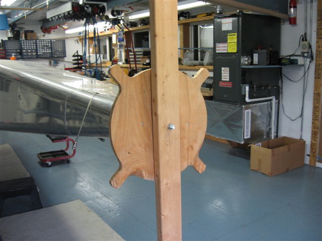

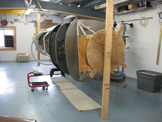

PostPosted: Wed Sep 01, 2010 2:33 am    Post subject: A Rotisserie Reply with quote
Simple rotisserie rotates on two 1/2" bolts. Work standing or sitting.

gaillard.peck.ctr(at)nell
PostPosted: Wed Sep 01, 2010 7:55 am    Post subject: A Rotisserie Reply with quote
Nice. Thanks. Gail Peck
