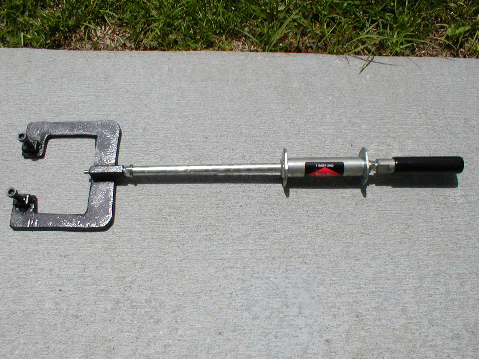

Holy cow Roger ! That is about the "cheesest " puller I have seen but if does the job then thats great. I have one I cut out of 1/4 inch steel sheet with a plasma cutter and attached it to a small slide hammer.It works great!
Anyway Johann you can buy one from California Power Systems if you want for about $75. Lockwood and LEAF also have them but I think they are higher. This of course is if you don't want to make one
      Dick Maddux
      912UL
      Milton,Fl

Hi Dick
Could you post a picture of your puller?
Carl

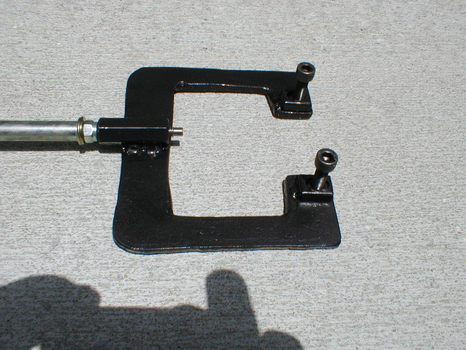

PostPosted: Wed Jul 21, 2010 4:00 pm    Post subject: Pulling a 912ULS Gear Box Reply with quote
Carl,
Here are some pictures of my homemade gear box puller.It is cut out of 1/4steel plate with a plasma cutter.
      Dick Maddux
      912UL
      Milton,Fl
