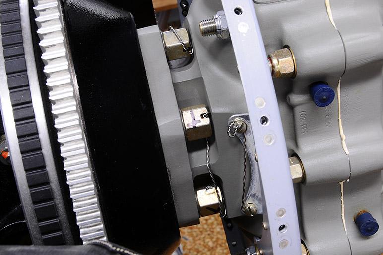

Does anyone have any close-up photos of how they safety wired the prop bolts on a Hartzell CS prop? You have to run the safety wire though those roll-pins. What a pain. If you have to pull the torque up from the bottom, it seems impossible to actually set twist. Maybe if I twist both ends first... Hum...
Anyway, some pics would be most appreciated!

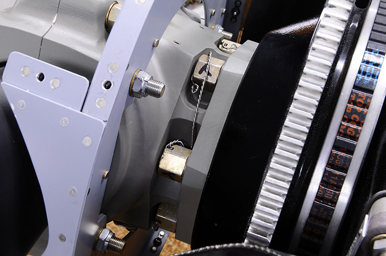

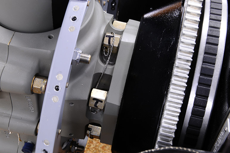

Well, okay, so it wasn't quite as hard as I thought. It was still a pain though! Here are three pictures of the safety wiring I did on the Hartzell CS Prop bolts (photo of each pair of bolts). What do you guys think?
