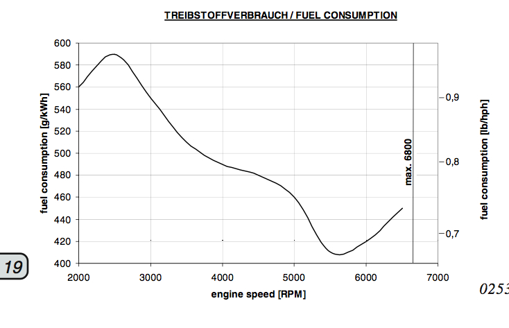

When you all are contributing info on fuel burn, need to include power
setting, i.e., engine rpm. There is a great deal of difference in fuel burn
on two and four stroke aircraft engines at low power settings and higher
power settings. To me, 75% power is normal cruise. Seems most of the
others who have contributed info on fuel burn, cruise much slower.
John,
If you equate 75% power as 75% carburetor slide opening, the 447 will be
running at max power. This is due to the fact that the Bing 54 carburetor
is over sized for the engine. I found that the 447 will top out at 6,200 at
about 34% with the throttle at the 34% position.
If you equate 75% power relative to rpm, then .75 x 6,200 gives a cruise rpm
of 4,650 rpm. From my flight log, I pulled out the data shown below. All
of these flights were from and to Perryville and Painton, MO. You will
notice that all of the rpms listed are greater than your 75%. The rpm/rpm
indicates that a different rpm was set from the to and return flights. This
difference as due to the gps indicated ground speed and the expected gps
arrival time. If I had a head wind, I would crank in more rpm, etc. to get
to the meeting on time.
Date Fuel MPG Time RPM GPH MPH
(gal) (min) Ave. Ave.
12/19/99 5.5 19.6 119 5,200 2.8 54.5
02/20/00 5.5 19.6 126 5,400 2.6 51.4
09/17/00 4.9 22.0 104 5,800 2.8 62.3
05/12/01 5.5 19.6 114 ?,??? 2.9 56.8
06/23/01 5.5 19.6 111 5,600 3.0 58.4
08/19/01 6.0 18.0 112 5,200/ 3.2 57.9
6,200
10/07/01 5.75 18.8 101 5,600 3.4 64.2
11/04/01 6.00 18.0 107 5,700/ 3.4 60.6
5,600
02/17/02 6.75 16.0 112 5,200 3.3 57.9
Averages 5.71 18.9 112 5,550 3.06 57.9
I hope this is enlightening.

75%power would be a difficult measurement to acquire accurately. Static prop thrust wouldn't even be accurate due
to inefficiencies with no forward motion. The only real way to do it would be on a dyno with no prop.
If you had a magic strain gauge between the prop and hub you could get something useful in flight.
On mine I just pull back a few rpm and settle for it.

If you equate 75% power as 75% carburetor slide opening, the 447 will be running at max power. This is due to the fact that the Bing 54 carburetor is over sized for the engine.
Also note that this carb, like MANY others, has no linear relationship between throttle-slide movement and cross-sectional area of the throttle bore opened.
Butterfly carbs have a similar problem.
I thought there was an 'official' definition of 75% power. I don't recall for sure but it seemed like it was something like 100% rpm, then back off 10% rpm.

I flew all my two strokes at 5800 rpm cruise.
My 582 powered mkIII cruised 80 mph at 5800 rpm and burned 5.5 gph.
My 447 powered FS cruised (can not remember the cruise speed) at 5800 rpm
and burned 3.5 to 3.75 gph.
My ULII02 powered US cruised (can not remember the cruise speed) at 5800 rpm
and burned 3.5 gph.
My 912UL powered mkIII cruised 85 mph at 5,000 rpm and burned 4.0 gph.
My 912ULS powered mkIII cruises at 88 mph at 5,000 rpm and burns 5.0 gph.
I flew/fly all my two and four stroke engines at aprx'ly 75% power. They
all were happy at that power setting and the airplanes and I were too.
John,
From being on the list for a few years, I questioned your 75% power cruise
statement because it countered my impression of how you flew your planes. I
checked with http://www.rotaxservice.com/rotax_engines and using the numbers
proved from the various engine model spec sheets this is what I found.
engine max hp max hp .75 max .75 max |John's hp % max
model (cont') rpm hp rpm | rpm (dev') hp
582 65 6,500 49 5,300 |5,800 61 94
447 40 6,500 30 5,200 |5,800 37 93
912ul 79 5,500 59 4,000 |5,000 74 94
912uls 95 5,500 71 4,200 |5,000 89 94
Approximately 75%?
Jack B. Hart FF004

71 hp divided by 12 hp per gal per hour...comes to abt 5.9 gals
hour... Seems a bit high...I am guessing that the 912uls burns about
5.5 gals hour at 75 % power? Herb

Rick,
You are correct about it not being linear over a wide RPM range but it is close enough for first order estimates at any reasonable cruise RPM.
There is usually one most efficient engine rpm, i.e., the rpm at which the engine produces the most amount of power for each ounce of fuel consumed. Attached is an image from a Rotax 2-stroke manaul showing how the BSFC varies with RPM for the 582. Notice that it is most efficient at about 5,700-5,800 rpm. This assumes a correct prop loading among other things. Since the number I quoted is really only valid at or near normal cruise RPM, where it is most efficient, the efficiency drops off somewhat on either side of that RPM, as you can see on the cruve. BUT the BSFC and the known fuel consumption with a little arithmetic does give a rough estimate of the HP being produced during cruise at any altitude. The RPM alone is not a very good prediction of HP being produced over a wide range of density altitudes, at least not as good as fuel consumption in normal cruise rpm range.
 Filesize:  130.47 KB
 Viewed:  13980 Time(s)

That makes sense... if it's 0.6 lb/hp-hour, then at 3.3gph (cruise at 5700 rpm) my Cuyuna should be producing 33hp... a wee bit more than 75% power...
