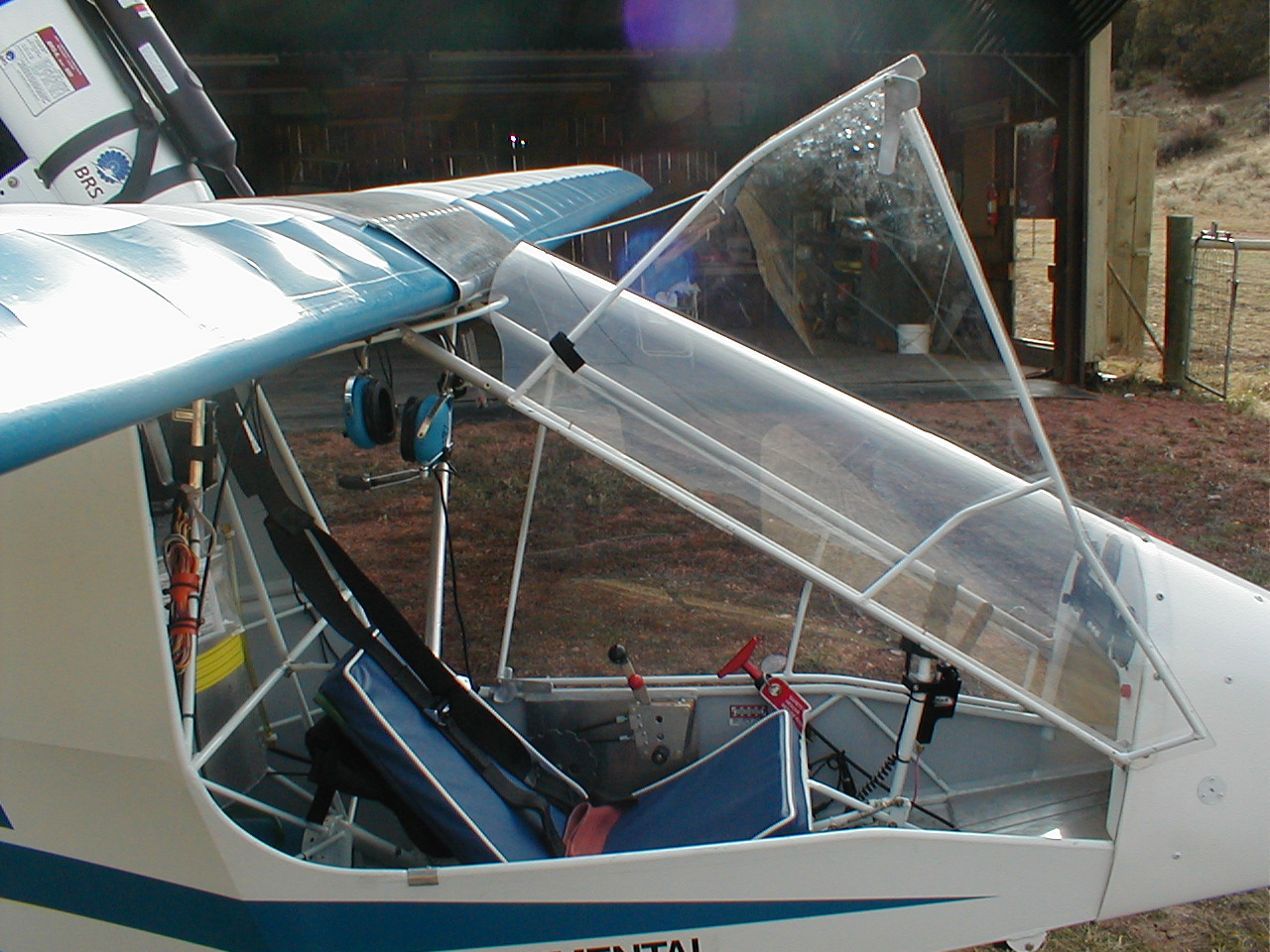

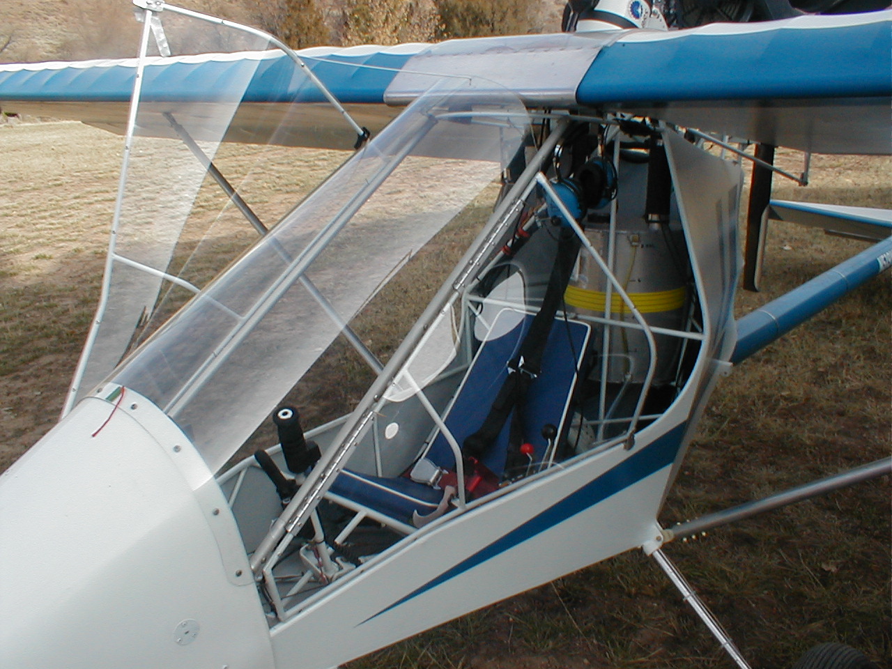

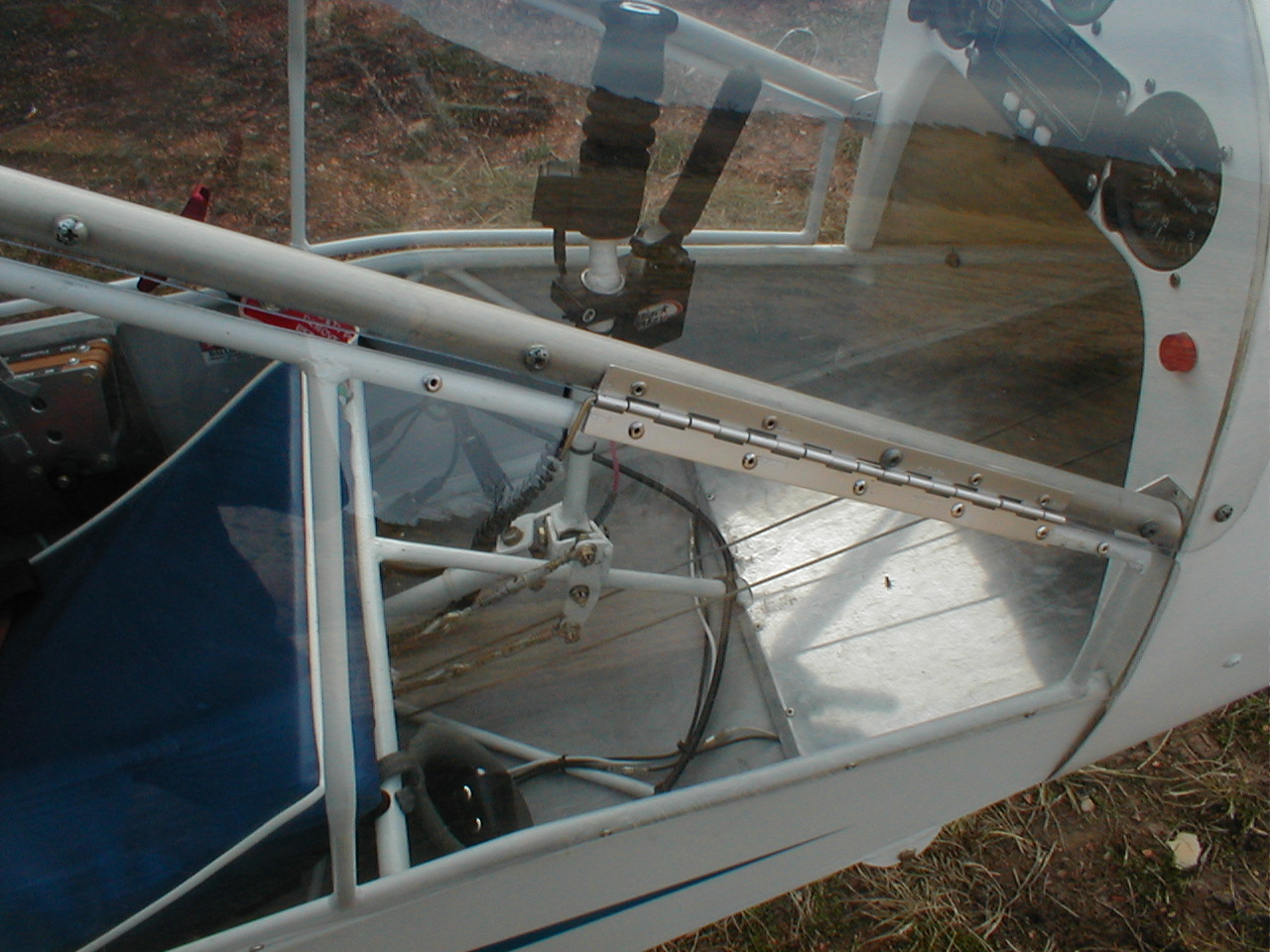

Here is how I built my enclosure for a original firestar. I can take both doors off in seconds. It also has hand holds to grab above head to make easier to get in, I'm 215 lbs so I need all the help I can get Smile I attached some pics, hope it helps. Brian Arrow

PostPosted: Sat Feb 27, 2010 7:43 pm    Post subject: Firefly full enclosure Reply with quote
The original Firestar top longeron was straight from one end to the other.
I noticed yours is drooped in the front, similar to the FSII.

PostPosted: Sat Feb 27, 2010 8:14 pm    Post subject: Re: Firefly full enclosure Reply with quote
Yes it is, I lowered the sides when I restored it for easier entry. Also did the wing mods with the alum angle/.035 LE & TE/wing tip mod/lateral bracing. Here is my site with photos of rebuild you can see all the the mods I did. www.brianskolbfirestar.comlu.com
