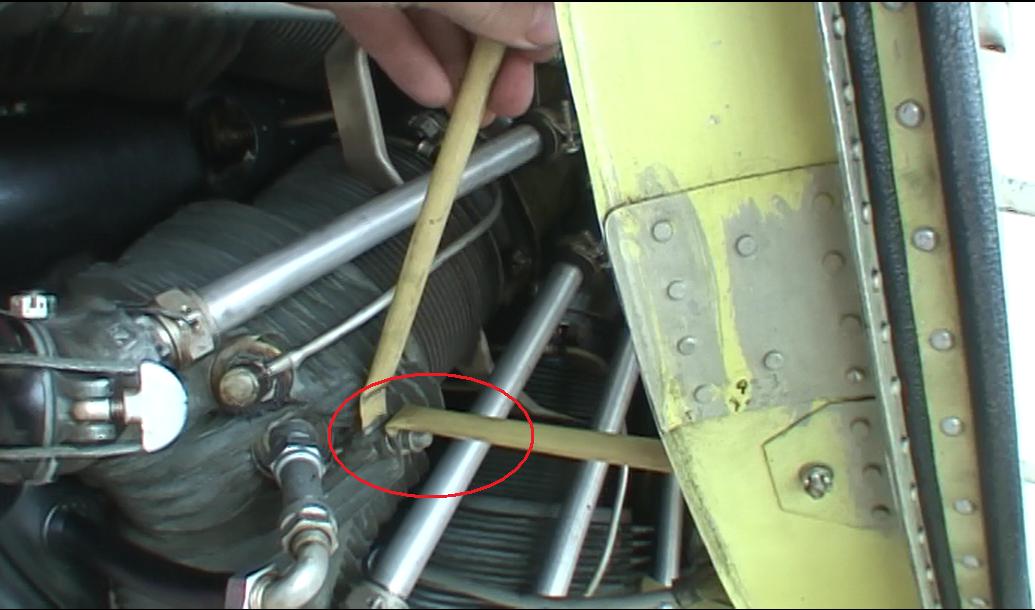

Hello gang!
Hey any advice on how to repair this gill attachment bar?
Or how to replaces them... I'm talking about the thingy that holds the bar in place and that connects to the engine pistons. please see the attached picture.
It broke during a 8 G vertical pull.
JC

JC,
You can make the "thingy". It's not that hard. The "thingy" is just an aluminum tube that has had its ends squeezed and bent, than holes drilled at the ends. Its kind of important on how long they are and angles of the bends, but super dup per wise. Any A&P could make one of these "thingy" in less than an hour. HOWEVER I happen to have some of those "thingys" that I could not use when I replaced the gill system on CJ-6. 8Gs???? Man that must have hurt.

PostPosted: Fri Jan 29, 2010 7:27 am    Post subject: Re: Gill attachment replacement/fix Reply with quote
8 G's? I'd continue to look for broken things and loose rivets. Especially at the belly, center of the wings.
Plus if that was my airplane, from that picture, I'd say I was out of oil. Wink

PostPosted: Fri Jan 29, 2010 7:36 am    Post subject: Gill attachment replacement/fix Reply with quote
What kind of aircraft did you put the 8g's on ?

PostPosted: Fri Jan 29, 2010 8:01 am    Post subject: Gill attachment replacement/fix Reply with quote
JC,Send me the length (there are 4-5 different ones on each set of gills) I most likley have them in stock.  8 g's??  You may need more than just a shutter standoff rod...........

PostPosted: Sat Jan 30, 2010 8:22 am    Post subject: Gill attachment replacement/fix Reply with quote
I have the new outer ring w/seal in stock for the CJ6, but you would have to change out the metal plates which hold the ends of the gill vane pivot rods.  The CJ6 uses a T type end on the rods, while the Yak uses a C/S straight slot type end.  Other than that difference they are the same.

PostPosted: Sat Jan 30, 2010 7:02 pm    Post subject: Gill attachment replacement/fix Reply with quote
Sierra Hotel… I just found a source for the YAK-50 gill axles.

PostPosted: Sun Jan 31, 2010 10:17 am    Post subject: Re: Gill attachment replacement/fix Reply with quote
I think the "thingy" connected to the "piston" broke during an 8 G landing.

PostPosted: Sun Jan 31, 2010 7:54 pm    Post subject: Re: Gill attachment replacement/fix Reply with quote
Thank you all for your suggestions!!!
I will try to briefly reply to everyone:
I apologize for not knowing the proper term for the part that I’m seeking (I still don’t)…
The plane is a Yak-55 (build for 9 G’s), and while doing Vertical rolls I normally do the initial pull at 7 or 7.5 G’s. In this Particular time I heard a metallic ping, discontinued flight and after taking the cowlings off I saw the ā€œGill Barā€ broke at the base.
I was also wondering if there was something that looks sturdier (like some 52-TWs) as
Doug suggested.
I’ll have to go next weekend and measure them and I may need a couple.
The nice looking seal on the outer ring came with the plane… sorry 

PostPosted: Sun Jan 31, 2010 8:03 pm    Post subject: Gill attachment replacement/fix Reply with quote
Hi Doug Thank you very much,
Let me take the measures next week, how much are the ones that you have?
JC
