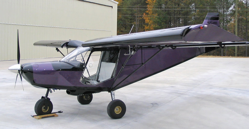

PostPosted: Tue Jan 19, 2010 5:44 pm    Post subject: C of G and a heavy nose... Reply with quote
Hi Ross,
Not sure of your configuration, but you might put the radiator back
under the belly a ways and move the 18 lbs or so that far to improve
your center of gravity.
I've attached a picture of an installation that does exactly that, tho
he's not using a Subaru, the installation is clearly the same for 601 or
701 with an EA-81.
My site shows the installation of this radiator on my engine page.
See attached image too.

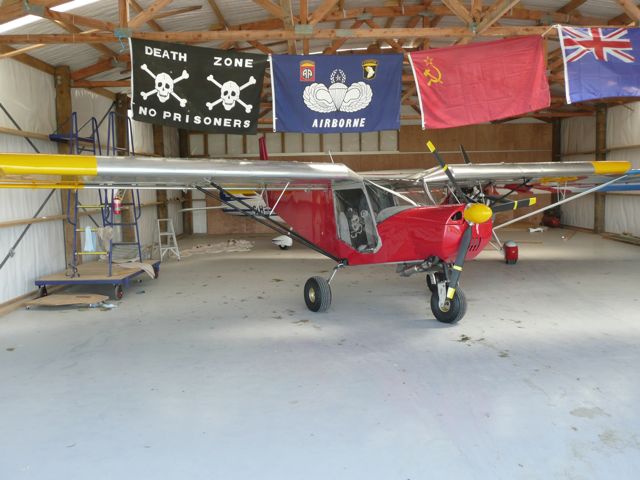

PostPosted: Tue Jan 19, 2010 8:18 pm    Post subject: Re: C of G and a heavy nose... Reply with quote
Some pre painting photos that'll show the layout... Thanks for the elevator info John..

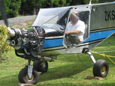

PostPosted: Tue Jan 19, 2010 8:19 pm    Post subject: Re: C of G and a heavy nose... Reply with quote
and some more....

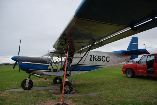

PostPosted: Tue Jan 19, 2010 8:21 pm    Post subject: Re: C of G and a heavy nose... Reply with quote
and now
