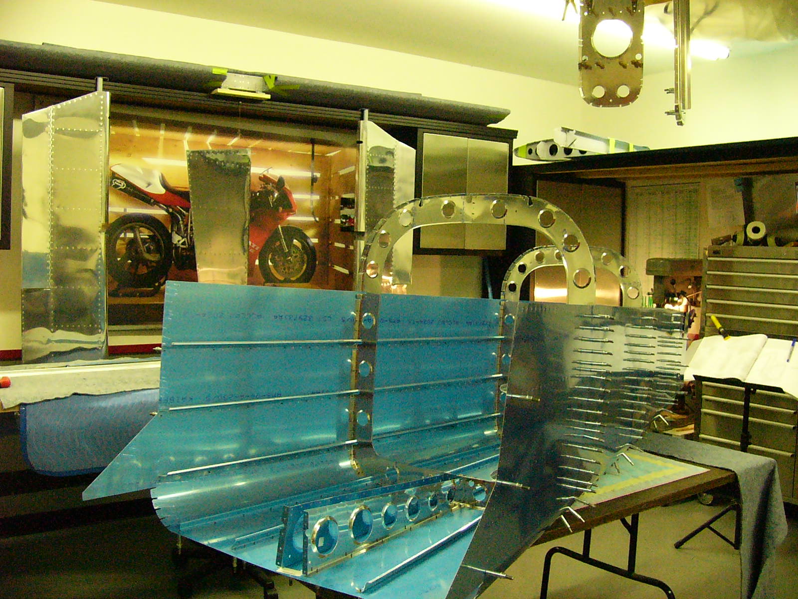

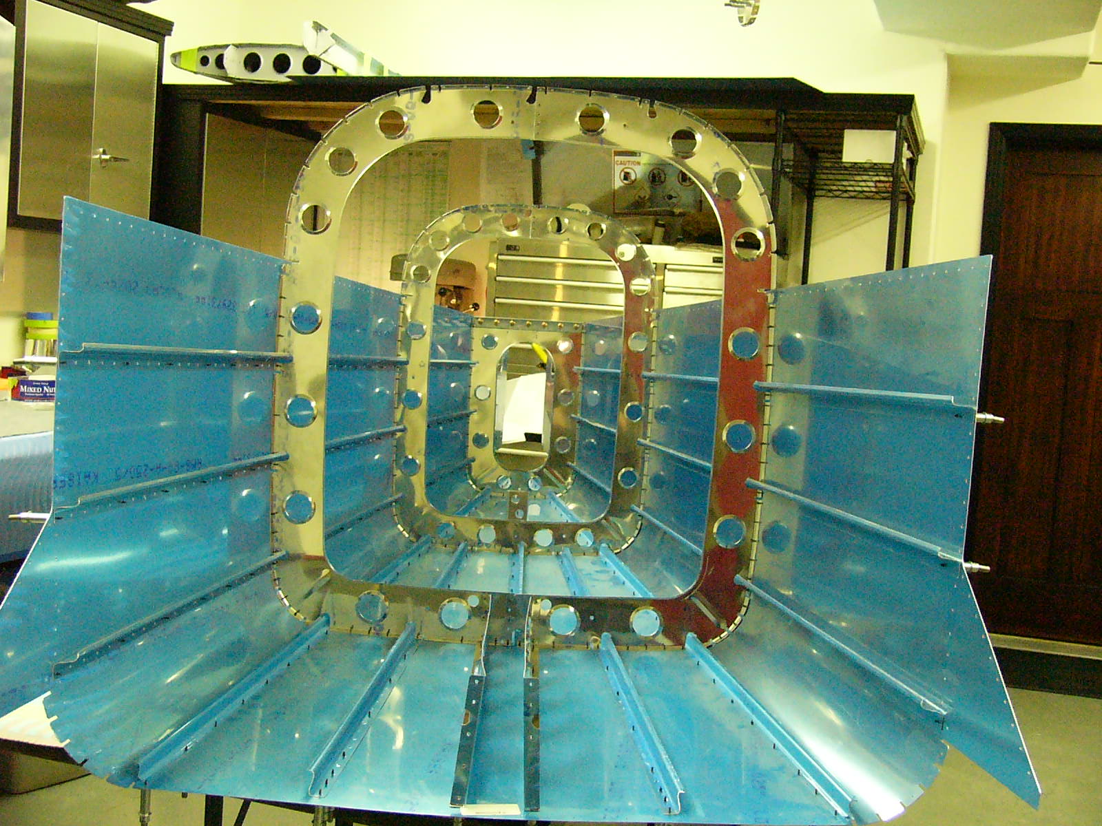

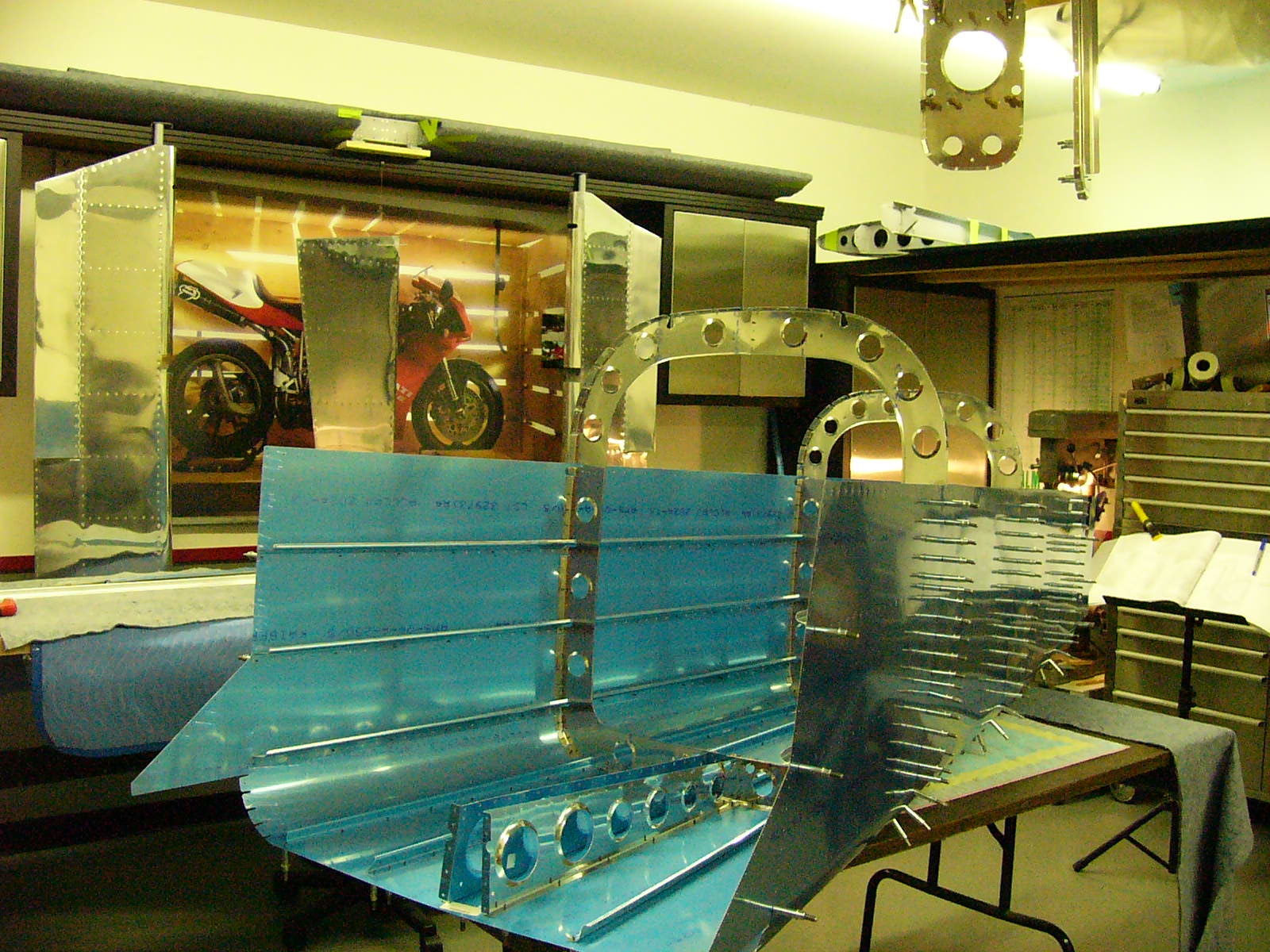

I haven't put much effort into engine choice. All I know for now is that an IO-540 is the ticket and they cost a bunch of money. What I will share with you is that building the RV10 is a lot of fun. I got kit 450 for my birthday gift. I like to think of it as: kit number four fifty, for my 50th.
I too am here in Portland. Handy to Van's close by. I was able to will call the kits in my van.
Couple pictures of my progress attached.
Best wishes, you'll enjoy the project.
