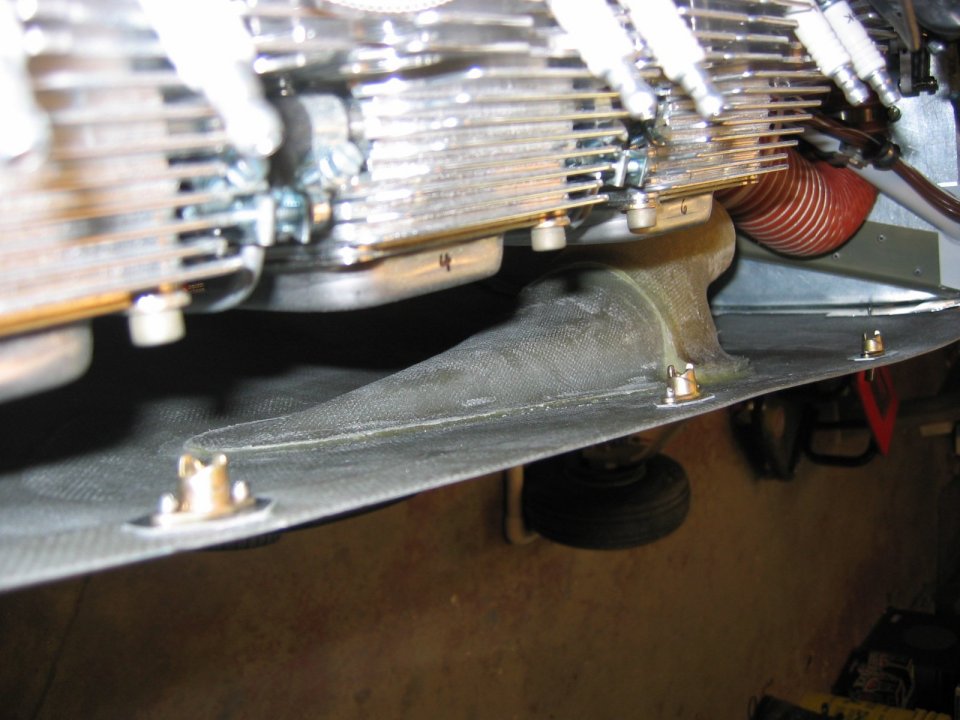

PostPosted: Thu Oct 08, 2009 2:56 am    Post subject: Re: Firewall Forward Kit from Jab USA/Camloc Fasteners Reply with quote
Mike,
I did just what Pete mentioned and spaced the camlock body away from the lower cowl with a piece of .032 aluminum. It worked great. Picture attached.
