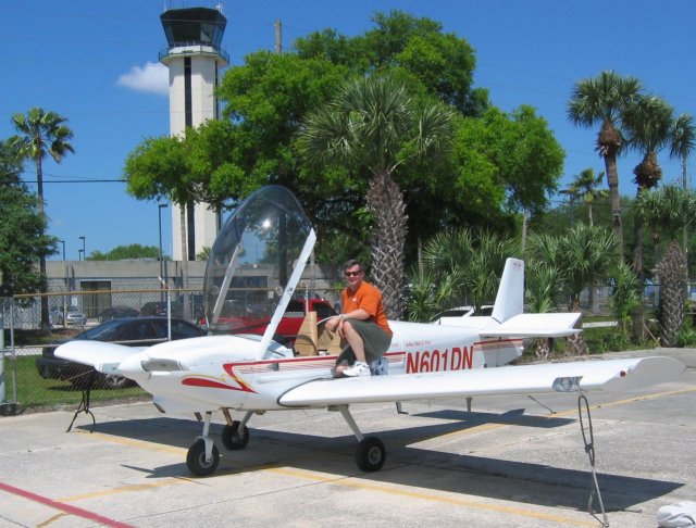

I have some experience teaching people to fly the Zodiac as I’m a CFI and used my Zodiac for a while as a teaching platform. A repeatable characteristic among those who fly high(er)-wing-loaded aircraft and are transitioning to the Zodie is their heavy-handedness on the controls. This generalizes from private pilots to ATPs. In fact, there were two other CFIs I couldn’t sign-off to fly the Zodiac because they couldn’t land it – an almost unbreakable PIO near the ground for both. They were the instructors who spent most of their time in twins. It’s clear (to me) there is a certain kinesthetic sense required to fly the Zodiac which is conflict with those built up in other GA airplanes. This seems to be borne out from the insurance stats. One-finger control to press on the stick to change attitude followed by trim is the drill I would often use.
Another “quirk” of the Zodiac is the location/height of the gear (I’m referring to a 2007 AMD airplane) and the angle of incidence of the wing (lower angle of incidence, not like the 650 is now or the 601 was earlier). This combination requires a deliberate rotating of the airplane for takeoff. Without the rotation the airplane will just continue down the runway never taking off. Given the weight distribution wrt the gear location, the deliberate action required to rotate is too much stick for maintaining the nose angle one wants for climbout. Thus, it almost immediately results in a nose-too-high attitude once the airplane leaves the ground.
The challenge is ensuring folks don’t panic at this point and shove the nose down (gotta ensure you box the stick with your hands!). That can result in a “good belt workout” at a critical altitude. If one takes off at 60 knots, there’s enough kinetic energy in the airplane for a nice easy correction.
love the plane,
Doug
Near 400 hrs in N601DN

Doug,
I flew your airplane when it was based at CAMS Flight in Florida for a checkout prior to flying mine on it's first flight. It was great to have a 601XL available so close to Sun-N-Fun when I attended in 2008. My favorite picture here at work my me next to your beautiful airplane with palm trees in the background.
I was pleased that the Instructor there was very thorough in describing the pitch control of the XL. I had heard about pitch sensitivity on the forums and was glad to see he was on top of it. The checkout went smoothly as a result with me careful not to get into pitch PIO.
Of the small handful of rides I have given to pilots and non-pilots, it is the certified pilots that I am most watchful of. I have briefed them all about the pitch sensitivity prior to relinquishing the stick. The non-pilots have been very good at keeping to small movements. This is probably due to their unfamiliarity with flying, in general, combined with a bit of apprehension (dare I call it fear?). Most of the pilots start ham fisting it right away. I do not have much of a stomach for negative G's and have immediately grabbed the stick on several occasions to tame them down.
 Filesize:  77.81 KB
 Viewed:  22993 Time(s)

David,
I'm glad you were able to be introduced to the Zodie in my airplane; and
thanks for the kind words about it.
Best of continued good fortune to you and your airplane.
