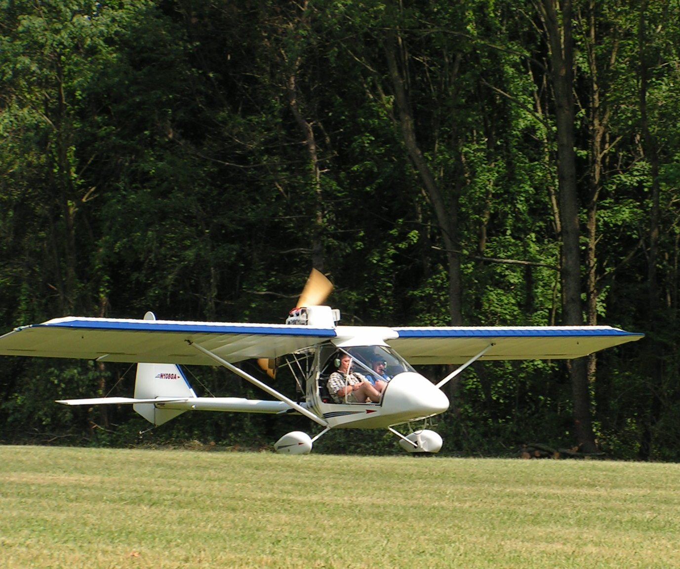

zeprep251(at)aol.com Guest
Posted: Sun Jul 05, 2009 3:10 am Post subject: oil Usage |
Lynn
It,s a pusher,the rear of the engine is covered by a molded fairing that smooths airflow into the cooling shrouds.I have only one picture on the computer to send but maybe it will show enough to explain the set-up
G,Aman

Lynn Matteson
Joined: 10 Jan 2006 Posts: 2778 Location: Grass Lake, Michigan
Posted: Sun Jul 05, 2009 9:37 am Post subject: oil Usage |
Gary-
I guess I'd have to see where the oil collection bottle is in
reference to the airflow to know if it seemed right for your
installation. However, someone with the same setup might chime in and
help you out. I just re-read your original post, and I'm not sure if
you're indicating a problem or not. If all the expelled oil ends up
in the bottle, that seems right to me, unless you think TOO much oil
is being expelled by the engine. Just keep in mind that if the vent
overboard is in a high airflow area, maybe a vacuum is being formed
and helping to draw oil out of the engine.
Posted: Sun Jul 05, 2009 12:23 pm Post subject: oil Usage |
Lynn,
Oil collection bottle is directly behind my seat on the floor of the fuselage.The last of the vent exits thru the floor on the bottom.It extends 1 inch below the bottom and is cut at 90 degrees to the pipe.I could place a short piece of 1/2" copper tube, cut at a 45 degree angle facing forward, in the tube which could slightly pressurize the system.I have had a modified PCV valve in the line 2 inches from the oil stick for some time now,hoping to put the crankcase in a partial vacuum,letting air out but not back in.This slowed the rate of oil loss but perhaps not for the reason it was installed.It may be just giving the oil a place to collect or to ubstruct its movement.
I can easily test the collector bottle for vacuum, for there is a 1/4 inch line installed from beside my seat thru the lid to near the bottom of the bottle to evacuate collected oil with a vacuum pump. If that test shows vacuum,I will try the angle vent to reverse it.The PCV valve will not let the crankcase be pressurized but could eliminate vacuum in the vent system ahead of it.
I'm pretty sure that not all of the missing oil from the engine ends up in the collector, but it does not leak externally at all.If it burns it,it burns it,and I can live with that.I would just like to keep the collector dry as possible.
Thanks for the input.I'll let you know what I find.
