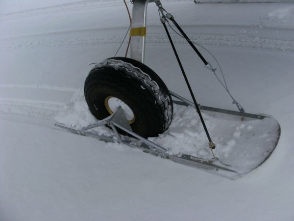

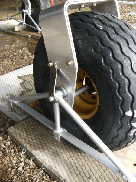

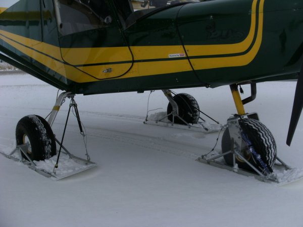

Hey Lynn and Pat this link is from a 701 builder with some home built skis
on Yahoo, and here are a couple of messages... this is what he had to say:
"hi all took some time but the new skis are installed and tested
perfectly this past weekend. performed very well on the snow which b/c
of the recent thaw surface was very dense and hard. i can pull the
plane with one finger on prop on top of this stuff. because of the
cant in the main gear the outer edge of the ski is lower then i would
like but still performed very well on the grass.all skis are 15" wide
mains are 48" long and nw is 36" top speed was down about 5mph and is
noticable less responsive to full throttle up. A mushy 4ooo rpm to
5200 in flight, the engine responds like normal but the asi is a
little slower to catch up. climbout was still impressive as ever.
total weight of all hardware is 60 lbs. so not so good for passenger
carrying but at least spent 2hours sipping around doing t & g's with
the bunch of hanger buddies only able to watch from the snowbanks.
will post some pics soon but will look like carbon copies of the ones
listed at zenith."
"just uploaded some photos. mains are 14 x 48 x 1/8 alum sheet with a
3.5" incline. 2- 1 x 2" rails on 12" centers stitch welded with a 15 "
wide sheet of 1/8 uhmw popriveted to bottoms. an bolts for mounting
hardware and clips. rest of the cable, bungii and hardware is local
building material. the nw pivot is a shouldered bushing machined to
size witha 5/16 x 2 an bolt and locknut. the "s" brace is a just in
case support. I can remove the ski without touching the nw axle. tail
wheels are hockey pucks board and oilite bushings pressed into."
http://groups.yahoo.com/group/701builders/photos/album/995817052/pic/list
Let me know if you can access this link, there are some pics there of the
skis...

The photos and text came through loud and clear, Ron, and thanks.
His skis are similar to my old ones, in that they let the tire
penetrate (in my opinion) too far, and he has the "cheese slicer"
effect going for (against) him. I can't imagine this arrangement
weighing 60 lbs, either, but it DOES include a nosewheel ski, which I
don't have the equivalent of for my tailwheel....haven't found the
need for it yet.

Ron C Yes C photos are great. It looks like you put carpeet on the tops of the skis. There is a diamond pattern on thetop of the ski. What is that?

SadSad "hi all took some time but the new skis are installed and
SadSad tested perfectly this past weekend. performed very well on
SadSad the snow which b/c of the recent thaw surface was very dense
SadSad and hard. i can pull the plane with one finger on prop on top
SadSad of this stuff. because of the cant in the main gear the outer
SadSad edge of the ski is lower then i would like but still
SadSad performed very well on the grass.all skis are 15" wide mains
SadSad are 48" long and nw is 36" top speed was down about 5mph and
SadSad is noticable less responsive to full throttle up. A mushy
SadSad 4ooo rpm to 5200 in flight C the engine responds like normal
SadSad but the asi is a little slower to catch up. climbout was
SadSad still impressive as ever. total weight of all hardware is 60
SadSad lbs. so not so good for passenger carrying but at least spent
SadSad 2hours sipping around doing t & g's with the bunch of hanger
SadSad buddies only able to watch from the snowbanks. will post some
SadSad pics soon but will look like carbon copies of the ones listed
SadSad at zenith."
SadSad
SadSad "just uploaded some photos. mains are 14 x 48 x 1/8 alum
SadSad sheet with a 3.5" incline. 2- 1 x 2" rails on 12" centers
SadSad stitch welded with a 15 " wide sheet of 1/8 uhmw popriveted
SadSad to bottoms. an bolts for mounting hardware and clips. rest of
SadSad the cable C bungii and hardware is local building material.
SadSad the nw pivot is a shouldered bushing machined to size witha
SadSad 5/16 x 2 an bolt and locknut. the "s" brace is a just in case
SadSad support. I can remove the ski without touching the nw axle.
SadSad tail wheels are hockey pucks board and oilite bushings
SadSad pressed into."

I don't think those are carpet.....they look like paver blocks to me,
Pat. Look closer and you'll see that where the diamond pattern is,
there is no ski attached to the hanging brackets. And these aren't
Ron's skis....he was just posting the link.

Ron, Yes, photos are great. It looks like you put carpeet on the
What is that?

Lynn C Jeeez... I must be going blind. The ski isn't in the picture C just the mounting bracket.That is a patio block. Come to think of it I just had trouble passing the eye test on my medical exam. Hell C I usually can't take it and close my eyes when I get close to the ground anyway.
Pat Reilly
Mod 3 582 Rebuild
Rockford C IL
[quote] From: lynnmatt(at)jps.net
Subject: Re: Ski Size
Date: Tue C 3 Mar 2009 17:00:32 -0500
--> Kitfox-List message posted by: Lynn Matteson <lynnmatt(at)jps.net>
I don't think those are carpet.....they look like paver blocks to me C
Pat. Look closer and you'll see that where the diamond pattern is C

> SadSad Hey Lynn and Pat this link is from a 701 builder with some
> SadSad home built skis on Yahoo C and here are a couple of
> SadSad messages... this is what he had to say:
> SadSad
> SadSad at zenith."
> SadSad
> SadSad http://groups.yahoo.com/group/701builders/photos/album/

hello lynn: its odd that you guys are talking about my skis. i got some of my inspiration from looking at the picture posts of yours. The originals idea came from robert nelson in the zenair .com posts of skis. http://www.zenithair.com/stolch701/7-photo81.html library #81...His are of the blue 701 at the top and about 2/3 down the list. I emailed him for info and he supplied me with some spec and more pics. .some others on the site show a guy standing on his skies so i got some relative sizes from that. I was just winging it as to the sizes. I just now did some calculations and came up with just under 2lb /sq in at full load. The pictures are just after traversing a 6' deep snowdrift. The plane sank about 8" but was able to hold the nw higher with rpm and backstick. I walked back through the same drift and sank past my knees. My size 12'vs couldnt hold up the 200lb hulk.there is a fair amout to cheese slicing and the wheels protrude about 2". the home field is grass with many short hops to pavement so i wanted both.
yes the other pic is of the nw ski under construction detailing the machined pivot separate from the nw axle....including pavers in the hanger
