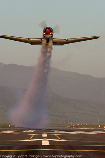

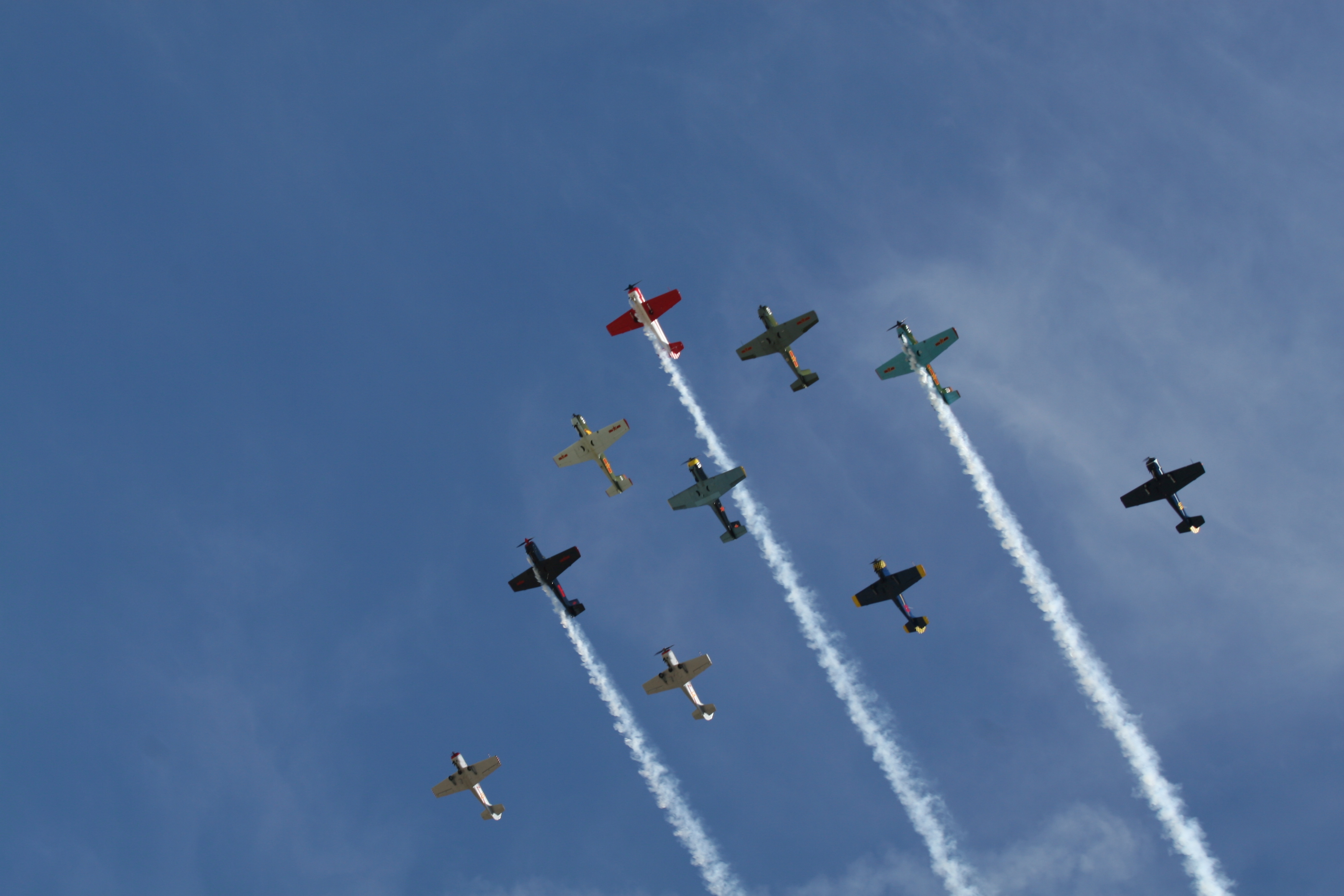

I've attached a few pics. The first one is my CJ with Blackwell's system
(dual injectors) and the other one is a formation shot. The Yak-50 (still
for sale) is in the middle. Blackwell system on the right, and another
system on the left.
