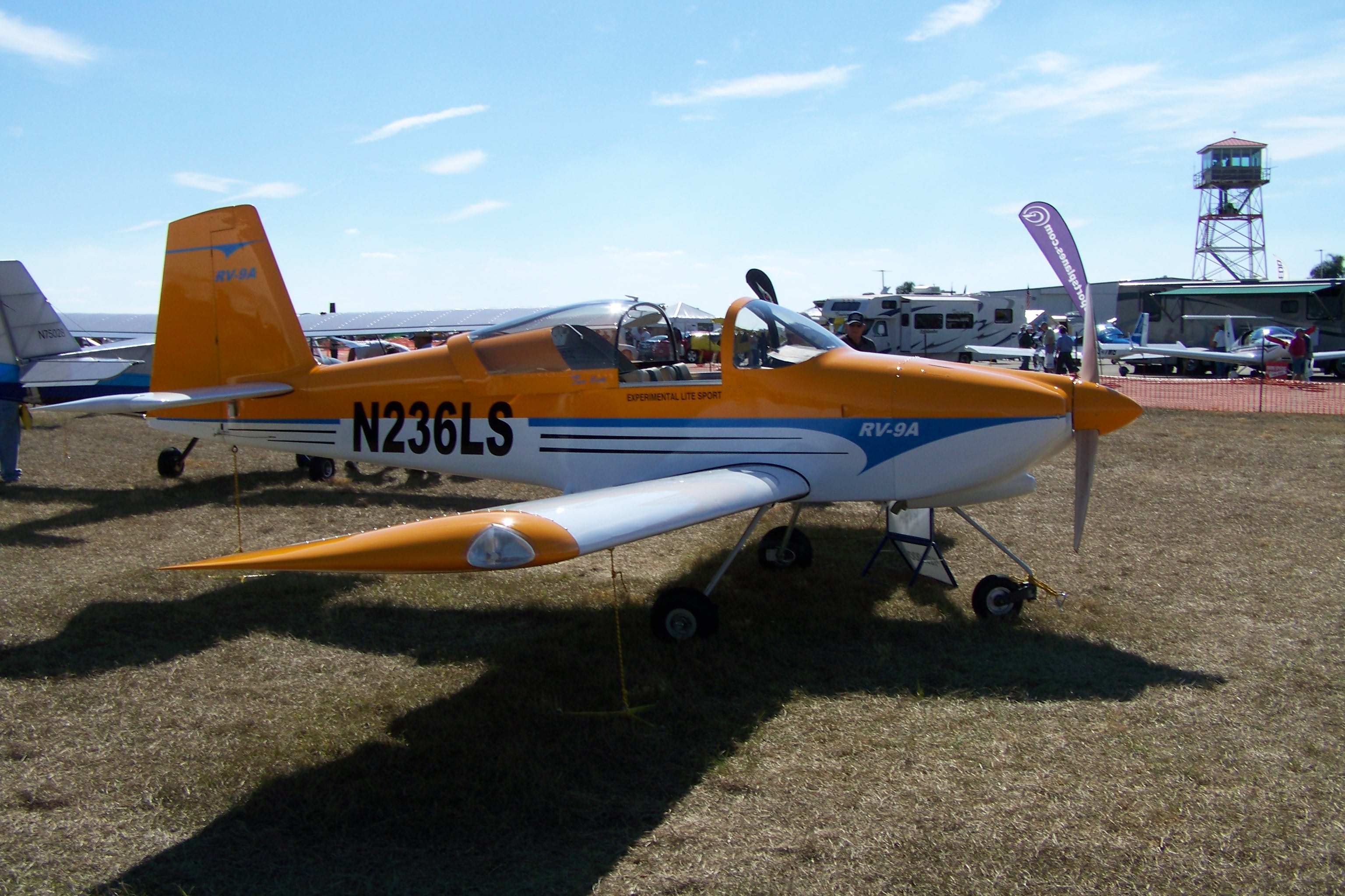

Saw an RV-9A being promoted as a Light Sport at the Sebring Light Sport Expo. The plane had a Lyc. 0-235. The numbers don't seem to add up to qualifying as an LSA. Anybody seen this? Doesn't seem to leave much room for payload.

There was a bit of controversy about this bird on the vansairforce.com forum. The planes stated empty weight is 903lbs, so that gives him a 417 lb useful load. He had to over-pitch the prop to keep the speed low. No wheel pants or fairings either.
With 2 FAA sized folks you can carry a little less than 13 gal of fuel for an engine that burns about 6+ gal an hour You get all of the RV costs, but none of the performance. Personally, I think he crippled a beautiful bird. Why anyone would do this is beyond me, but hey it is experimental aviation. Very Happy
Jon
P.S. I would really like to see what that plane weighs when measured with some aircraft scales Shocked
