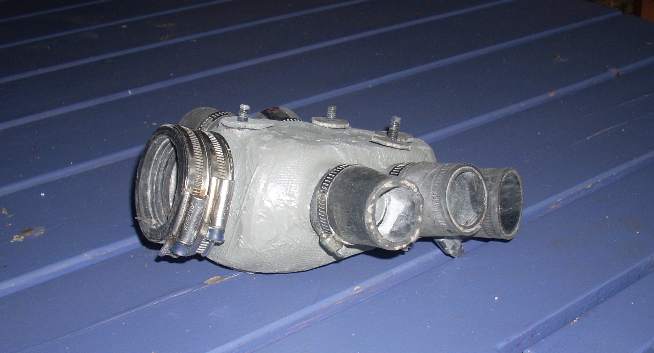

Lynn my tests were done on the ground in static runs. You could try the
throttle movement test on the ground for comparison.
I think after many hours of ground runs the last test I did with the plenum
proves that resistance in the Jab collector is affecting performance, as
follows:
1. Breakdown at WOT is caused by an unrestricted rush of fuel to the
end of the plenum to #1 and 2. In use of the tapered plenum there is only
one way to stop spectacular engine breakdown at WOT and that is by fitting a
full width baffle 35mm wide and 30mm from the entry inside the plenum.
2. The baffle neutralizes the effect of the butterfly so that the last
1" of throttle has no effect. The baffle is acting like a partly closed
butterfly downstream. Without the baffle, throttle increases power up to the
point of breakdown ie there is no dead throttle.
3. Similarly the last 1" of throttle into the Jab. collector has no
effect but because of internal losses there is normally no breakdown at WOT,
only #1 and 2 go rich.
My tests were conducted on the ground static. I am using a 55 X 72" prop. on
the Quickie which climbs at 1500FPM and cruises at 170KTS at 2950RPM WOT.
You can appreciate why I am trying to make sure the engine is doing it's
best. The engine is still very tight when hot. It has done about 50hours.
Peter

I'm a bit confused by your description of the rush of fuel to the end
of the plenum to #1 and 2. It seems like the fuel must be being drawn
to those cylinders by vacuum from those cylinders. Do you suppose
this is because the fuel is not being atomized enough, and is
"clumping" together and cannot break apart to go to #3 and 4? This is
hard to visualize/imagine for me. I guess I do not understand your
description of the "tapered plenum" and how it works.

Lynn
The prop is 55 dia X 72 pitch.
The 500KG gross Quickie is a fast 2 seat low drag Rutan canard design and
rated at 200MPH when powered by an 0-200. Performance is similar to a
Varieze but with a shorter take off roll. The J 3300 advertises an extra
20HP and I am looking for the extra air speed but not satisfied the engine
is performing to full potential.
Feeding from a Jenvey throttle body with two injectors at WOT I am getting
much the same problem as referred when the Bing is fully open. Rough running
and according to my plugs it is caused by a surge of fuel to #1 and 2 at the
end of the plenum. With the plenum the rough running is extreme and causes
breakdown. With the Jab collector the effect is masked by losses in the
collector. As referred before I can fix the problem with the use of a large
baffle but this restricts the effect of the throttle and there is a loss of
power. There appears to me to be a similar loss in the Jab collector.
Therefore I don't think it is a Bing problem but based on the tests I have
done with a tapered plenum I think the problem is due to the design of the
plenum (also the Jab collector) by attempting to feed from the end and with
outlets along each side. By contrast if we look at the 0-200 the feed is an
updraft central between the four outlets and with equal length headers this
makes for uniform distribution over the full power range.
Near WOT when the butterfly is near level the Bing (and the Jenvey) fuel/air
charge although atomized the fuel droplets have sufficient energy to travel
to the end of the system and over richen #1 and 2.
The reason to taper the plenum is to attempt to get a uniform pressure
gradient along the axis allowing for expansion of the charge at each pair of
outlets. Take a look at a Dyson vacuum cleaner. It works well for air and it
works well when bench tested using water in a pressure paint spray gun but
apparently not for the fuel/air charge at the higher velocity under WOT.
When the butterfly is deflected further to reduce throttle the turbulence is
increased and the charge is more evenly distributed. Using the plenum
without the internal baffle I found that the butterfly position is critical
and the breakdown is sudden and complete.
I also tried with fuel pressure increased to 60PSI for better atomization
but without success.
Hope that helps, I tried to attach a pic of the plenum which does not look
very pretty but is sexy on the inside.
Re engine hours you are right I have spent too long on the ground
experimenting.
Peter

Joined: 20 Mar 2007
Posts: 197
PostPosted: Thu Jan 15, 2009 3:02 pm    Post subject: 3300A - Full Throttle Roughness Reply with quote
Andy,
That is a very informative post.
I have been testing with a twin injector throttle body feeding an
unobstructed plenum, then for comparison feeding the Jab collector. My
fuel/air mix should be better, in fact I tried 60PSI for greater
atomization, but the charge entered the plenum and too much of the fuel
carried through to over richen #1 and 2 near WOT.
This is an issue independent of the splitter or the type of turbulence.
I think it is happening because near WOT a proportion of the fuel droplets
have enough energy to accelerate through the plenum (or the collector) until
they reach the end.
This is similar to the principle used by Dyson when dust is separated from
the air stream by using it's kinetic energy in a cyclone.
After endless tests I think the problem is due to the fact that we have an
end fed plenum (or collector).
I plan to reconfigure my plenum for bottom feed similar to the 0-200, but
headers will still be unequal and it will not be easy to target the charge
for uniform distribution between the 6 outlets.
Peter

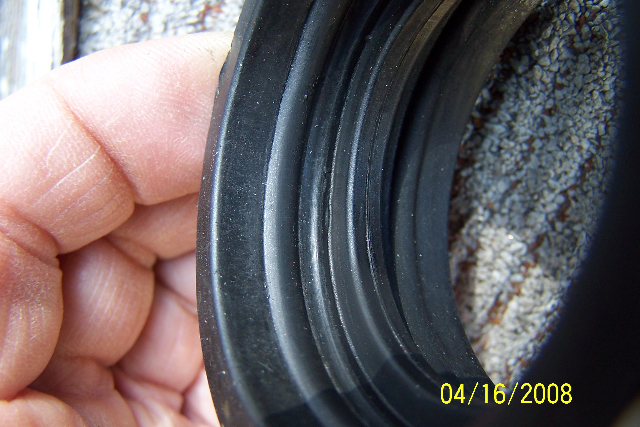

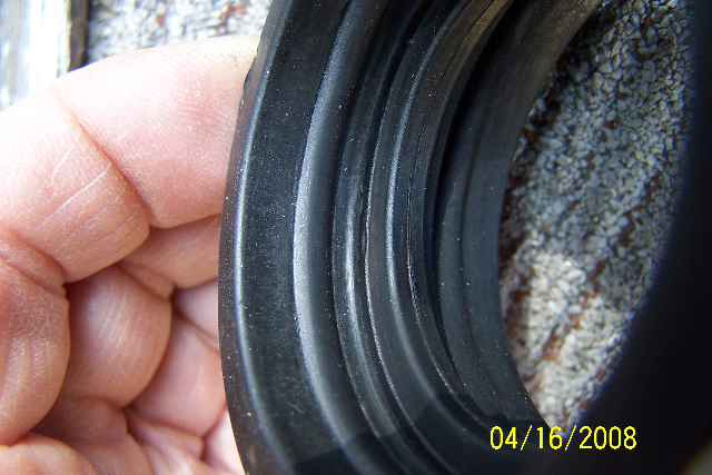

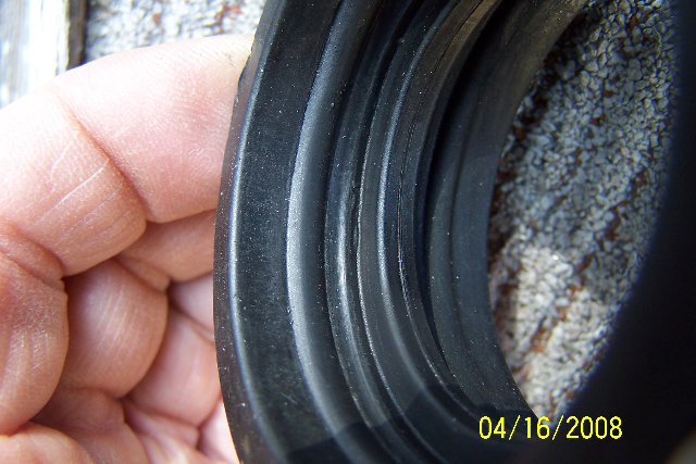

Lynn Matteson
Posts: 2778
PostPosted: Fri Jan 16, 2009 3:12 am    Post subject: 3300A - Full Throttle Roughness Reply with quote
But do you remember, Andy, when I reported back in about April of
last year that my rubber coupler had a built-up ridge that filled
this gap? I mentioned this and you said that the coupler supplier
must have made this change in the later models. Here is picture of
that ridge. It is the square-ish ridge between the two humps that fit
into the grooves of the carb and the intake adapter.
It is a bit hard to visualize because of the coupler being all black,
but it's there. I show this to let folks know that maybe by changing
to this style coupler that maybe some of the imbalance might be
modified in their engines if they presently have the coupler which
doesn't have this "gap-filling" ridge. What do you think?

ago, and
the source of the analysis is impeccable. Now that we have
comprehensive
engine monitoring and EGTs on all cylinders, it's easy to see these
effects
through the rev. range as you fly. Even better are monitors like
the GRT
Horizon/EFIS instrument which can graph EGT in real-time so you can
see the
effects of mixture distribution at different power settings.
As I suggested in the post a while back, we found some success by
inserting
a filler-ring made of rigid plastic (about the same consistency as the
coupler) which would fill said gap and provide a smoother bore. It
wasn't a
complete fix, but definitely improved mixture distribution.
Ideally, the
carb delivering into a plenum about 30% of the engine's cubic capacity
should give a better opportunity for fuel and air to mix, but space
and
neatness of design precludes this. Jabiru's original plenum on the
2200 and
very few 3300s wasn't a success as the fuel in liquid state would
tend to be
thrown to the front of the plenum and then run along the walls and
up the
front two intake tubes, so the front cylinders were richer than the
back.
Now, if the intake tubes protruded into the plenum by a few mm, the
liquid
fuel wouldn't run up 'em, would it?
The experts at Jabiru were fed all this information at the time,
but no
doubt had better reasons than me for keeping the design, and why
not? It's
theirs!
Andy
