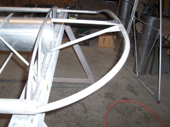

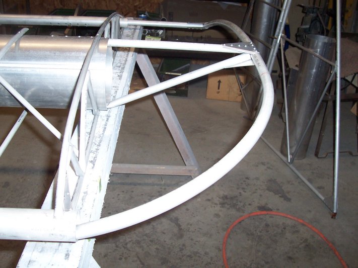

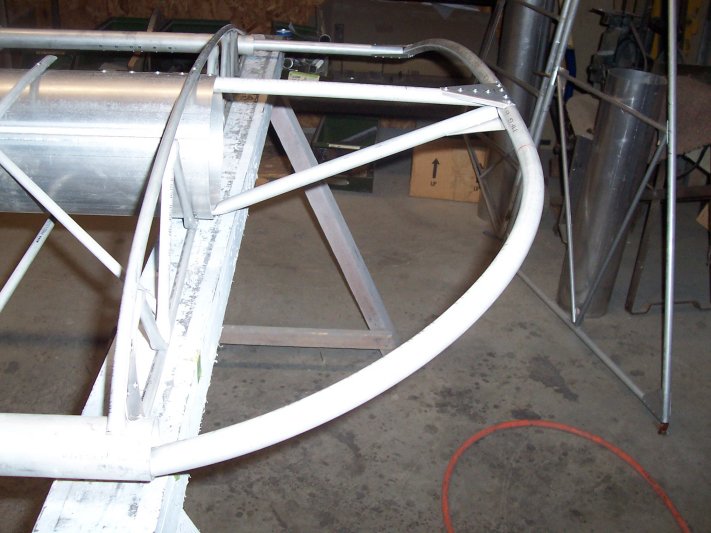

As you are aware, I HAVE extended my wing spars, to accomodate droop tips. I chose to extend the outer tip of the spar by using a chrome moly truss and various alum. tubes for triangulation bracing. This method has provided a very strong 22" extension. Scott (icrashrc) used a similar method to extend the end of his spar, to also add droop tips.
Although I think is "possible" to extend the spar at the root (as you descibed), I wouldn't consider it without destructive testing and some engineering calcs. If the splice were to fail at the root, the results would be predictable...bad!!
Yes, as stated, the loads on the inner portion of the spar are in compression. Plus, the spar is also in a bending stress, which would create a shear on an inner extension. It is my opinion that if you add any length to the spar, it should be at the tip.
With regard to failure of my spar extension truss design, I doubt it!! Once it was bolted on, and reinforced, it feels rock solid. To calculate the G forces at 6 G's on just the 22" wide extension is an easy affair. A quick calculation says each extension should be able to support
around 225 lbs, for a 6 G force. 225 lbs wouldn't even get it's attention!!
I think the general concensus here is to add on to the tip. It is reasonably easy, and can provide for a strong platform for droop tips. IMHO!!

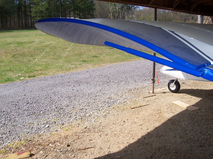

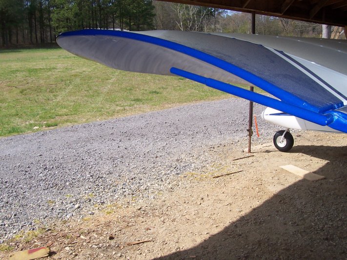

It is my understanding, from Nick's emails to me directly, that he intends on installing droop tips.
Although he didn't state that, I'm pretty sure that's his plan.
With regard to your comment about lift escaping off spanwise from the end of the wing, I definitely agree
with you. One of the biggest factors that I believe contributes to this is the high incidence angle of
the Kolb airplane's wings in flight. While this attribute may give Kolb's airplanes their fantastic flying performance, it also proves that the lift produced by the wing goes through quite a high pressure gradient difference (in other words, the air really gets squished going under the wing). The fact that the stall speed
on the factory Xtra went from 30 MPH to 26 MPH, by installing droop tips proves this.
In my opinion, all this seems intuitive! If we were able to watch a wind tunnel test of a "high incidence
wing's wingtip lift loss", I think the results would be predictable, and obviously apparent, too.
For SOME flyers, altering the original design to include thing's like droop tips or VGs, serves their flying
needs in some way. Whether it their own limitations, their landing field, or whatever they deem necessary, they seek a slower landing wing. That is NOT a bad thing. SOME pilots do NOT see any need whatsoever to alter the original design, and are quite satisfied with the performance and flying characteristics as they are, unaltered! Great!! To each his own.

PostPosted: Mon Jan 05, 2009 8:53 am    Post subject: Extending the wing spar... Reply with quote
Mike W:
incidence angle of
proves this. > Mike Welch
The only thing the new Xtra wing has in common with Homer Kolb's wing is the
shape of the airfoil. The new wing is longer and was flown, initially, with
no bow tip. So...we can't compare it to the wing I am flying with, which
has Homer's bowtip that has worked since he designed it. Had we put Homer's
wing tip on the "long" wing, we probably would have reduced the stall just
as much. I don't know for sure, but it would have slowed it down more than
the squared off wing.
As far as high wing incidence in flight, that depends on airspeed. High
speed - it flattens out. Slow down and the tail rides lower increasing wing
incidence.
The reason Homer designed a lot of wing incidence into all his airplanes,
except the Sling Shot, is the design of his landing gear and the way the
aircraft sits nearly level on the ground. Homer designed them this way
because he wanted the added safety of requiring higher airspeed for lift off
and landing for low time Kolb pilots. Without the increased wing incidence,
it would take a lot of runway to get going fast enough to fly off in a level
attitude.
I have never changed Homer's wing design because what he came up with is
hard to beat. The wing tip is his design and serves to provide his aircraft
with the great performance and gentle flight characteristics that they have
always been famous for. I fly off a 750 ft airstrip and have been for 25
years. I fly in some very short, unimproved, unfriendly strips that most
pilots would not consider. My fat mkIII breaks in ground effect as the ASI
is coming through 30 mph. How accurate is that ASI? I don't know.
Probably about as accurate as the ASI in the new Factory MKIIIx I tested
last year.
Just a guess, but I think a lot of folks want to change the Kolb wing tip
because it looks cooler. Personally, I don't care if it looks like it does.
What I like about it is it works, and has worked since Homer designed it.
Remember, any time one changes one part of a proven design, it usually
affects other aspects of flight performance. For example: You may reduce
the stall speed, but lose some of the gentle stall characteristics in the
process.
VG's??? If you need them, fly with them. Up until now, I have not been
able to determine that the increase in performance and safety is worth the
effort and expense of installing them on my mkIII. Never said they do not
work. Just don't help enough to go to the effort...
My old airplane has been proven in flight for many hours and years. I never
hesitate to put up against other Kolbs, in the air, to compare "real world"
performance.
BTW: I don't have any aerodynamic engineering expertise. I am just an old
pilot that has experienced a lot of time in Kolbs in a lot of situations. I
have a great deal of respect for these airplanes, have made a lot of
mistakes, and am still learning how to fly them almost every time I go up.
mdnanwelch7(at)hotmail.co
