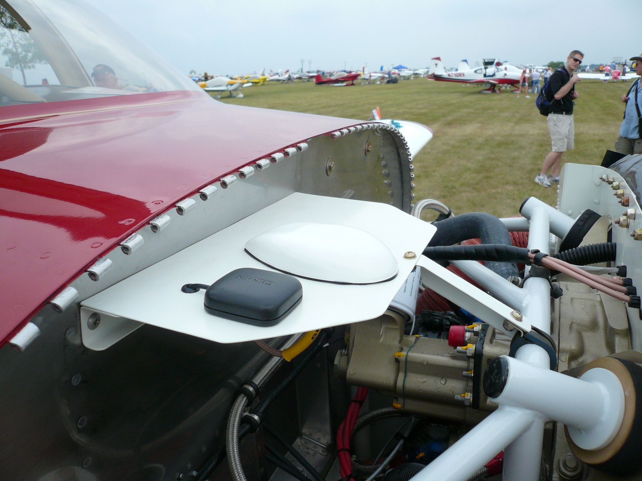

here is one installation. The inside job seen at OSH on 2007. I was told by th avionics shop that it will reduce the life of the antenna, so I went with two on top of the dash

I think 'maybe' should be used instead of 'will'. The heat in the
glareshield area on a sunny day can get pretty high too. I don't think
that area in the picture gets as hot as folks think (but I have no data)
because most of the engine heat goes out through the cowl exit in
flight. If baffled good. after shutdown, convection should take most of
that heat and exit through the inlets. I'm in the habit of opening up
the oil filler door after I park and really don't get much heat exiting
there (but I think any help is good!). Heat isn't kind to electronics,
especially semiconductors, but semiconductors have 'matured' over the
years and are increasingly more tolerant of heat. Someday I'll try and
measure the temps ...... but those 'somedays' seem to take forever!!!
