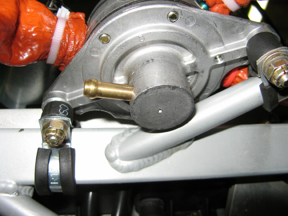

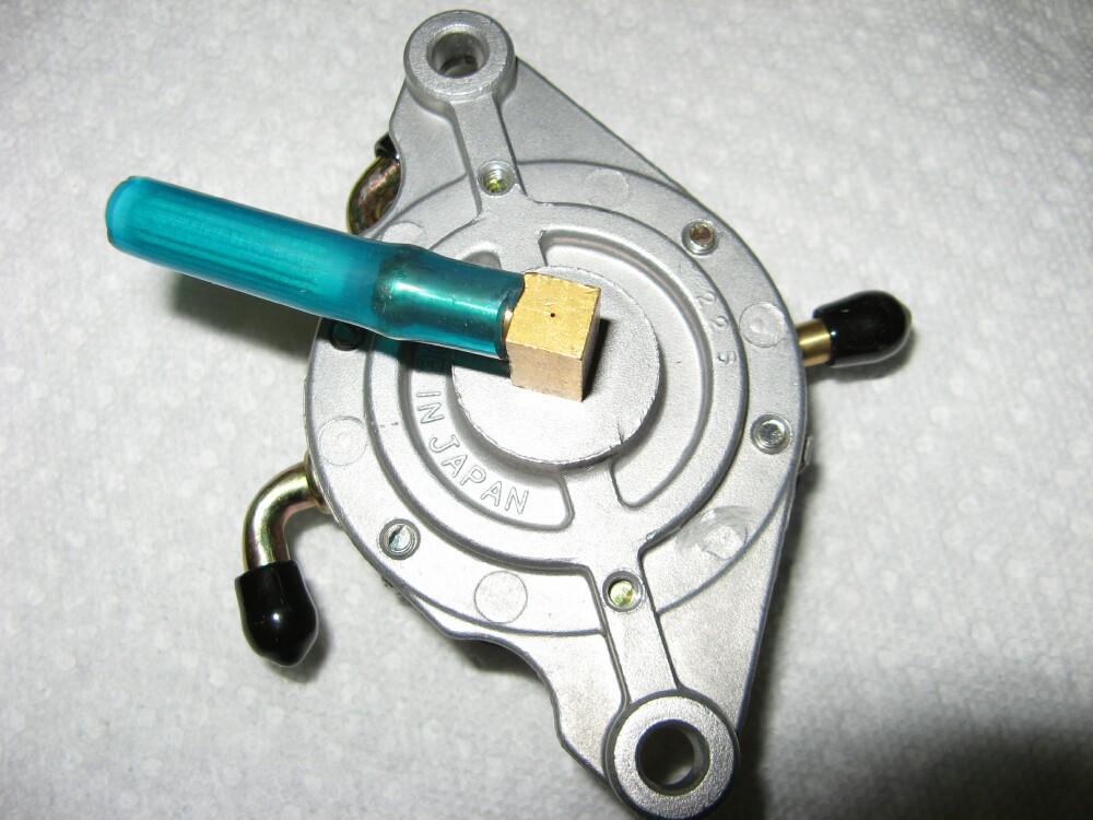

Pat, attached are a couple pulse pump pictures. One with a brass pulse line fitting. The tiny vent hole is in the center of the square brass fitting.
The other is mounted horizontally on my Kitfox motor mount. The pulse line fitting is part of the pump casting. The hole is in the same place in the fitting.
The one with the brass fitting is a genuine Rotax part, I think. It came with my engine. I had it mounted on the fire wall with a 22 inch pulse line. It pumped fine but leaked oil out the vent hole. I thought the pump was faulty.
I purchased the cast fitting pump from CPS. It did the same thing. I moved the mount closer to the engine pulse port as shown in the picture with a six inch pulse line and the leaking stopped.
The first pump that I received from CPS did not have the vent hole. He said they drill the holes themselves and that one must have been missed.
The aircraft engine version of the Mukunie pulse pumps are the only ones that have the vent hole. Pumps for snowmobiles etc. do not. Some of those have found their way onto aircraft.

Tom C Thank you very much for the photos. My brass fitting has the vent hole in it. That is a very small hole. I guess it doesn't matter how the pump is oriented on the firewall C the hole is dead center no matter how you rotate the pump. Why would there be an oil leak with a longer vacumn line?

Tom C Thanks for the tip. I won't have to spend time trying to figure that out now. I am going to rebuild that pump. It has been laying around for awhile. I will rotate the top plate when I rebuild it and be able to shorten that run from 12" to around 8".
Pat Reilly
Mod 3 582 Rebuild
Rockford C IL
Subject: Re: 582 fuel pump
From: nahsikhs(at)elltel.net
Date: Thu C 1 Jan 2009 12:31:36 -0800
--> Kitfox-List message posted by: "Tom Jones" <nahsikhs(at)elltel.net>
> The fuel pump�mounting location requires about 20" of hose. I am going to use hard tube to shorten the run. Hose requires me to loop around 180 degrees. I don't think I can twist the square brass inlet port to allow access from the other side.
Pat C you can rotate the plates that make up the fuel pump. Take it apart and you will see that you can put it back together with the pulse port fitting pointing where you want it to. It is pretty simple inside C you can't put the plates back together wrong. If you take out the diaphrams and rubber parts place them on your work table in an order so you can tell where they came from and you can put them back in where they belong.
