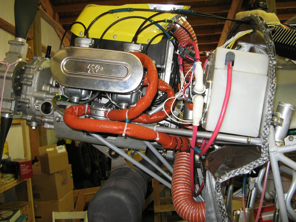

Heres what the 503 installation looks like in my kitfox. Anyone with more ideas or comments I would like to hear/see them.

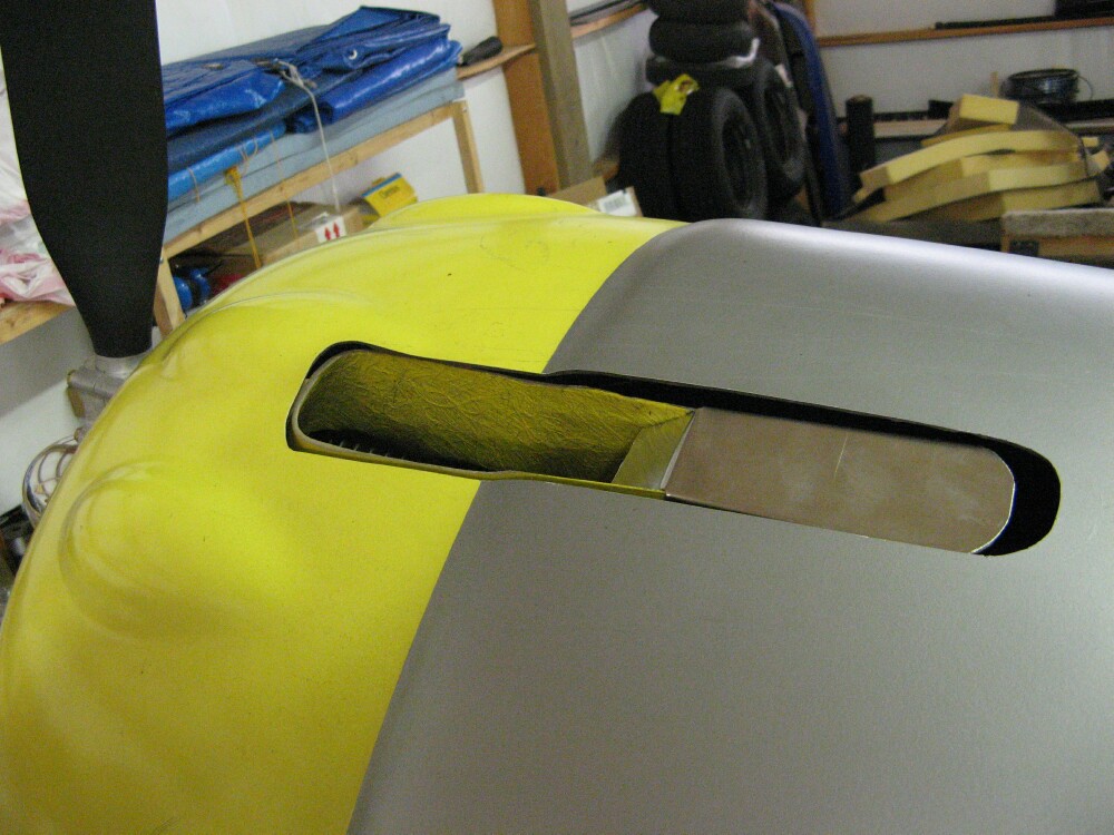

Thanks to the ideas sent to me I built the heater and tested it today. I just put a restrictor plate on the hot air duct and 2" scat hose through the firewall between my feet. It's a 10 big dogs breath heater. The CHT's behaved just fine. I like things simple so there are no contrlos, just put the restrictor plate on for the winter and take it off for the summer. I could make a couple different sized restrictor plates for when it gets real cold I guess. ground adjustable only. Pictures attached.

PostPosted: Sat Nov 15, 2008 5:55 pm    Post subject: 503 cabin heater Reply with quote
Tom,
If you did it the way that I think you did then all you will have to do is make a alum fitting that goes through the firewall with a swing gate inside the fitting to either open or close the gate. Attaching your scat tubing to the new fitting.
Larry C, Oregon
