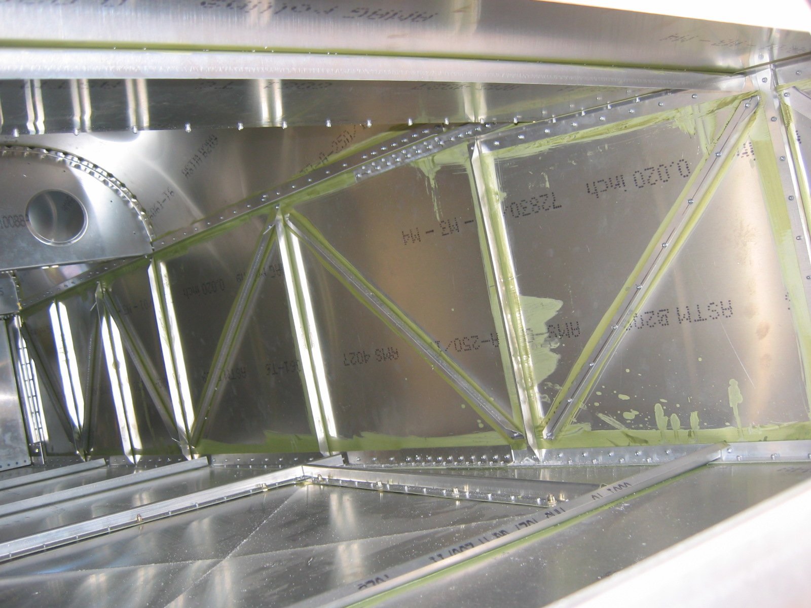

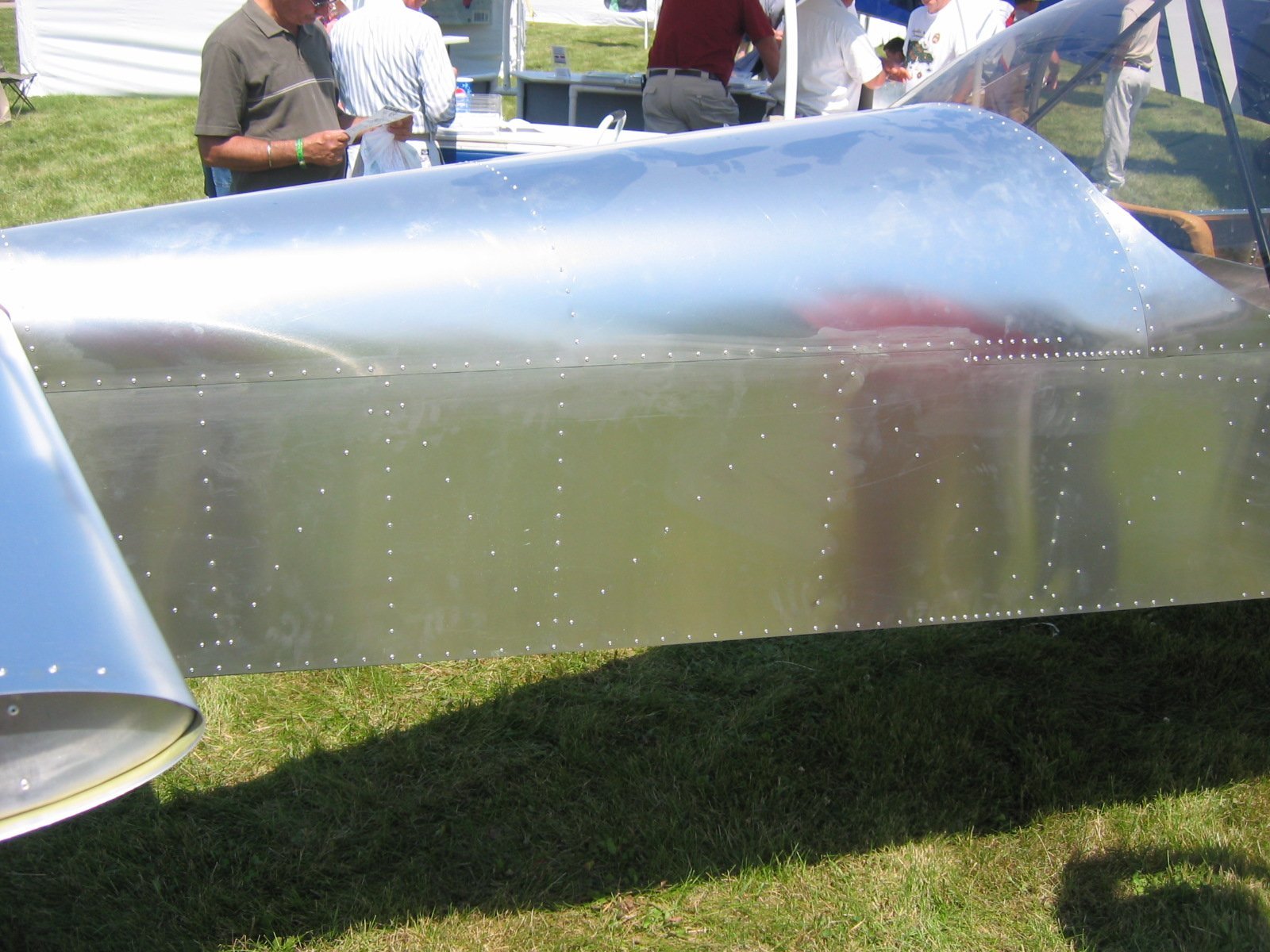

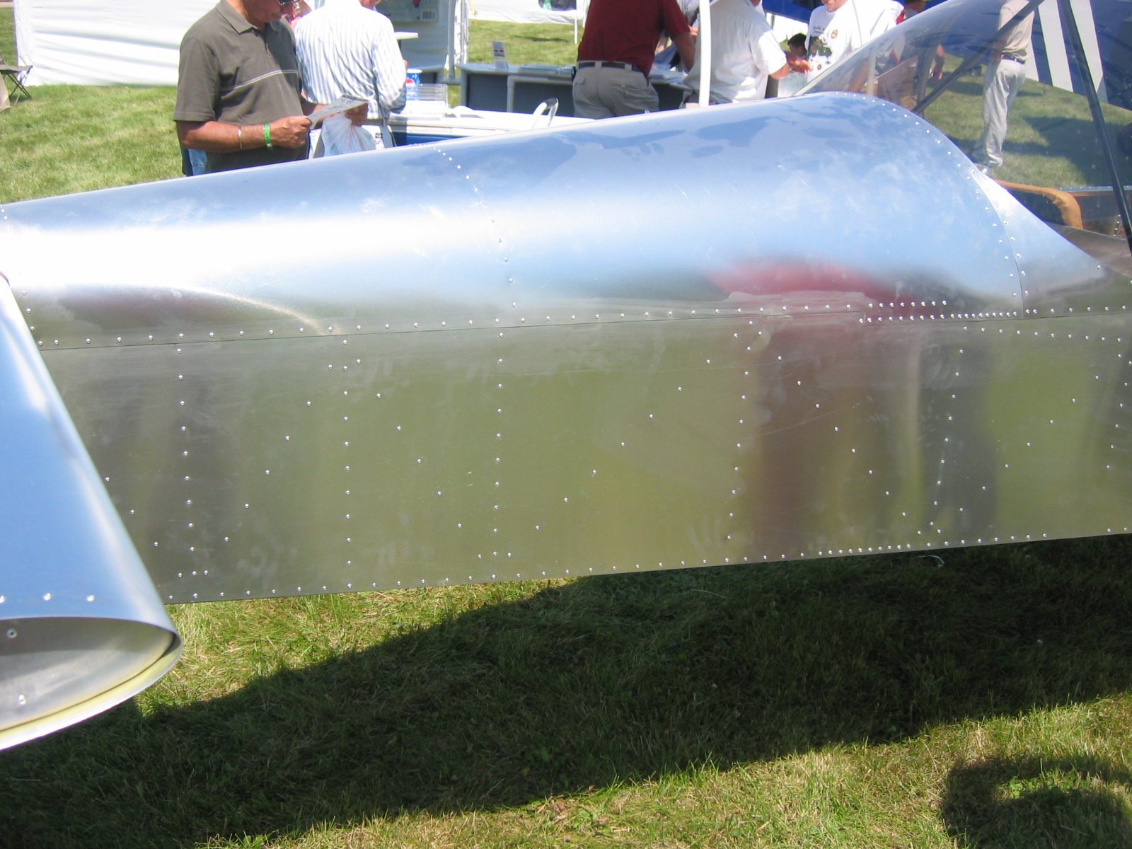

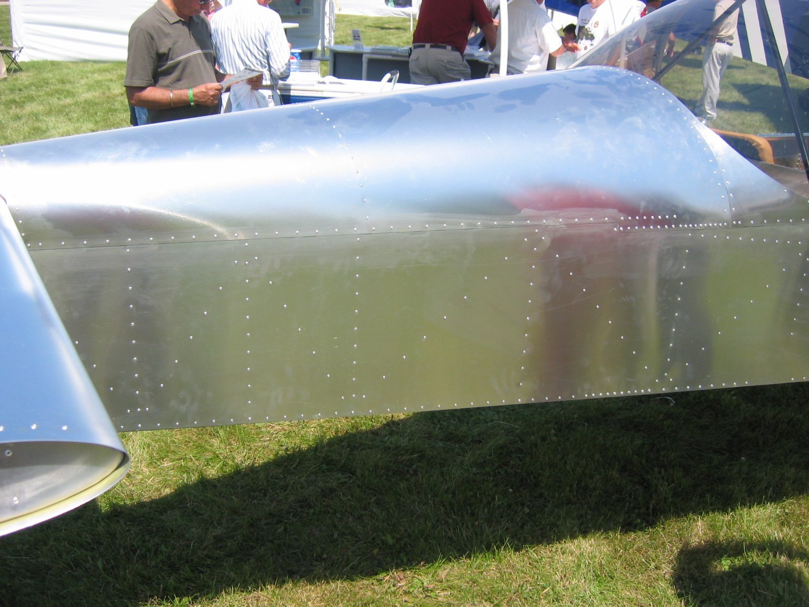

Here are pictures I took, at Oshkosh, of both the outside and inside of the 650's fuselage.
I hope this helps,

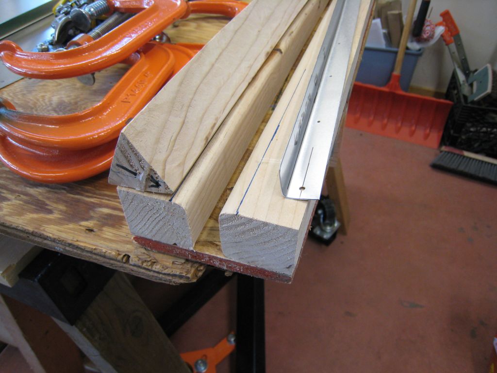

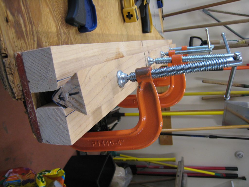

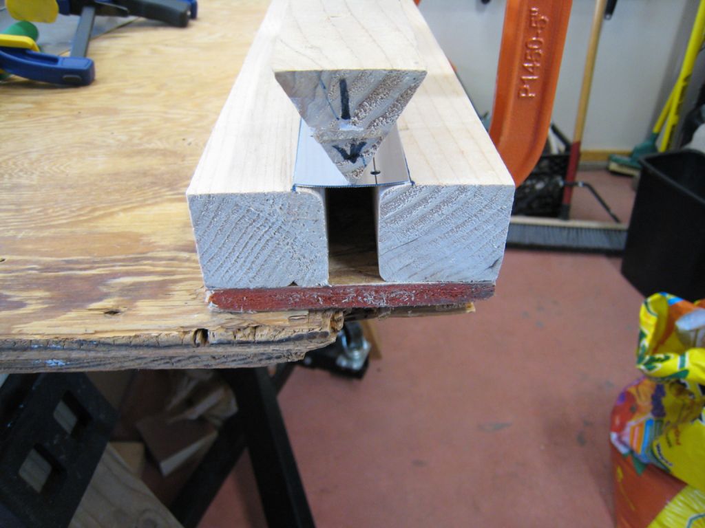

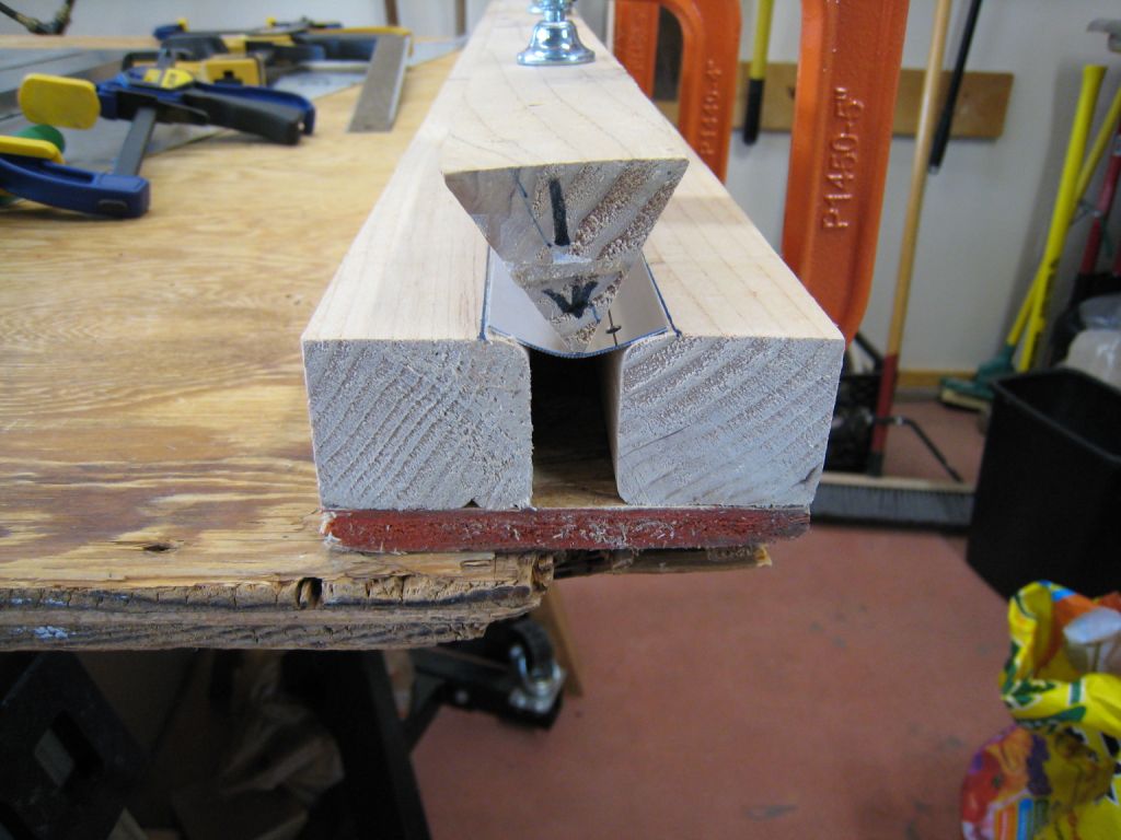

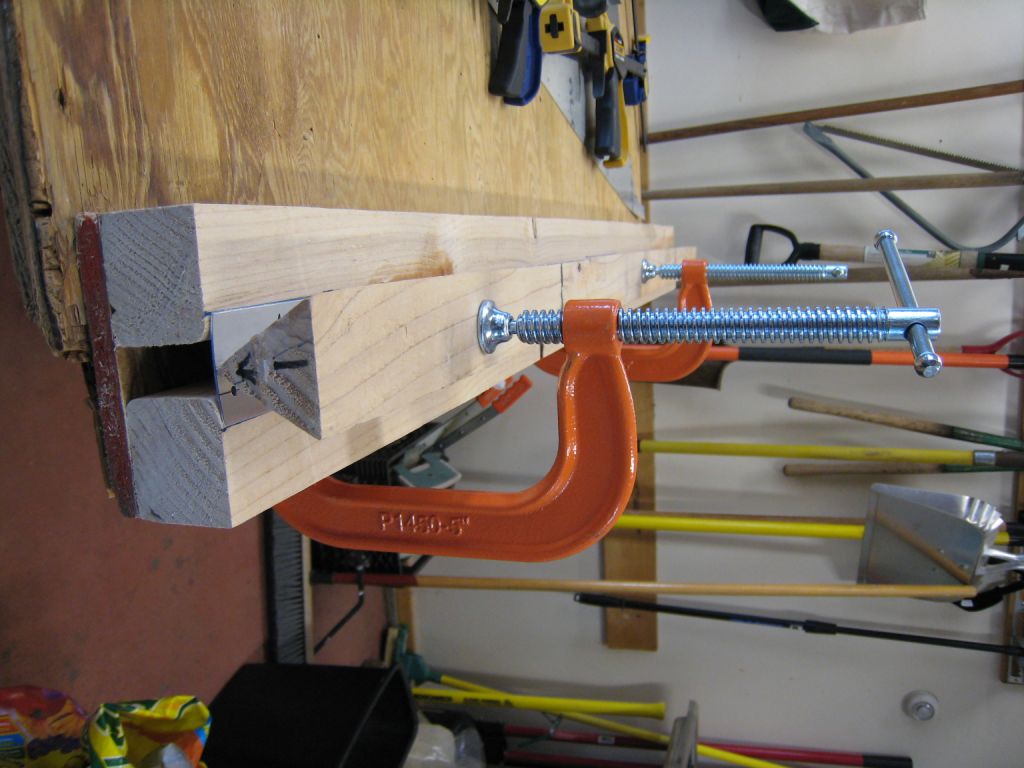

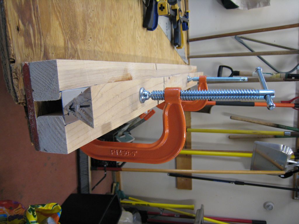

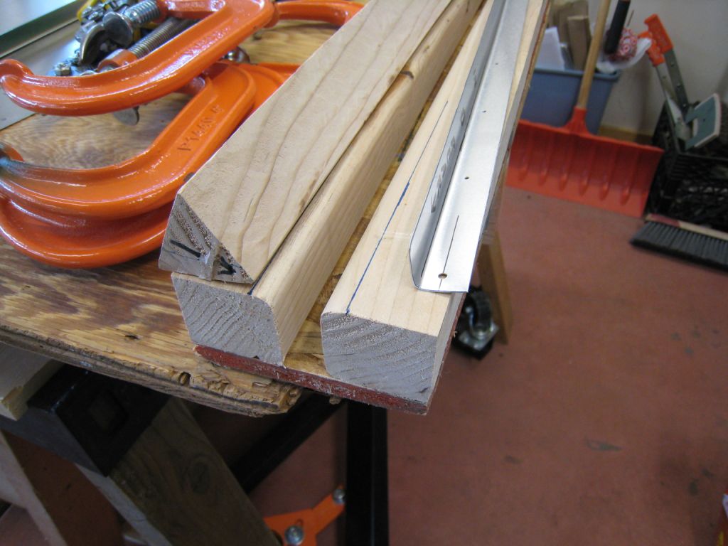

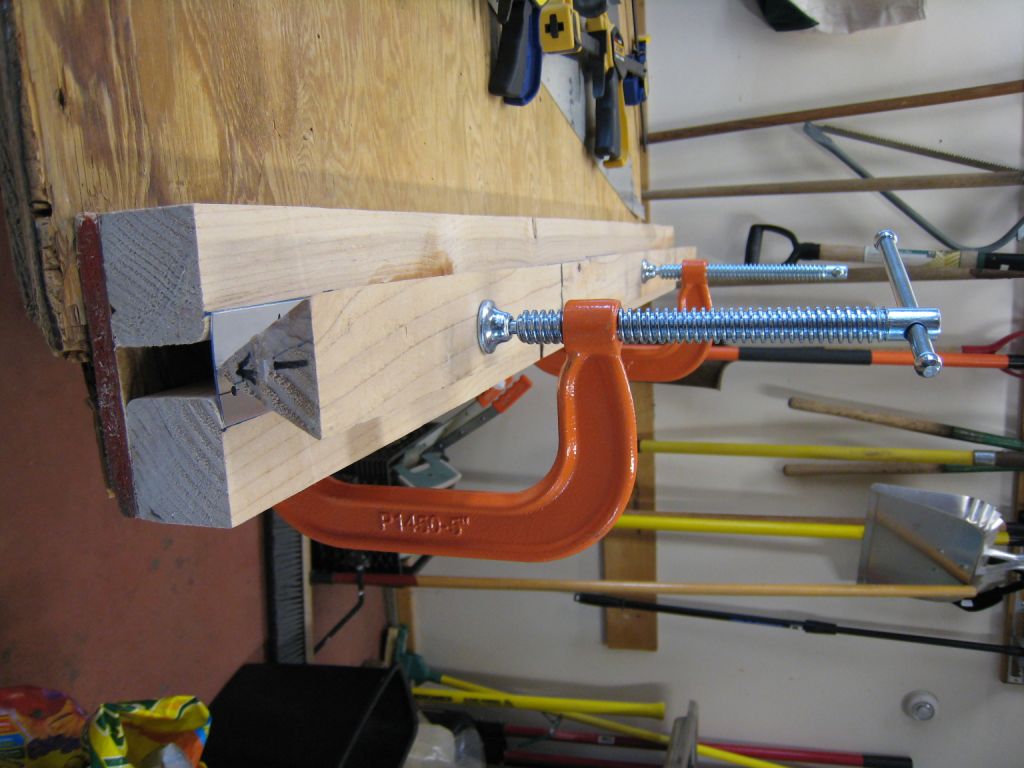

It isn't too hard to make your own standard L's in 4 foot lengths with a
simple wooden press break. Pictures attached.
-- Craig
A request: Please don't attach several hundred K of pictures to your emails.
Email is not the way to send pictures around. You can post to the Matronics
forum and attach them there, without flooding people's email inboxes with
them. Thanks.
