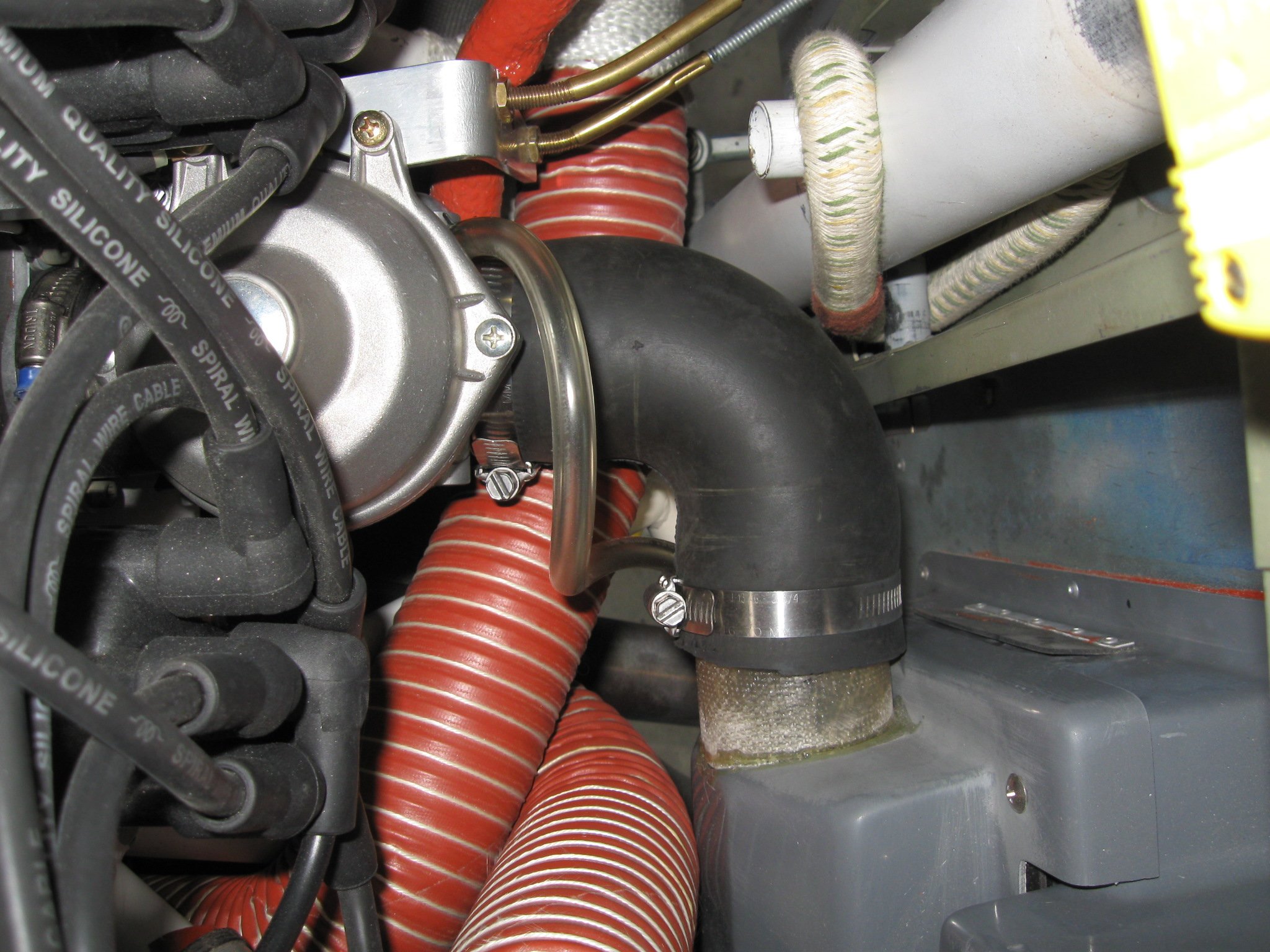

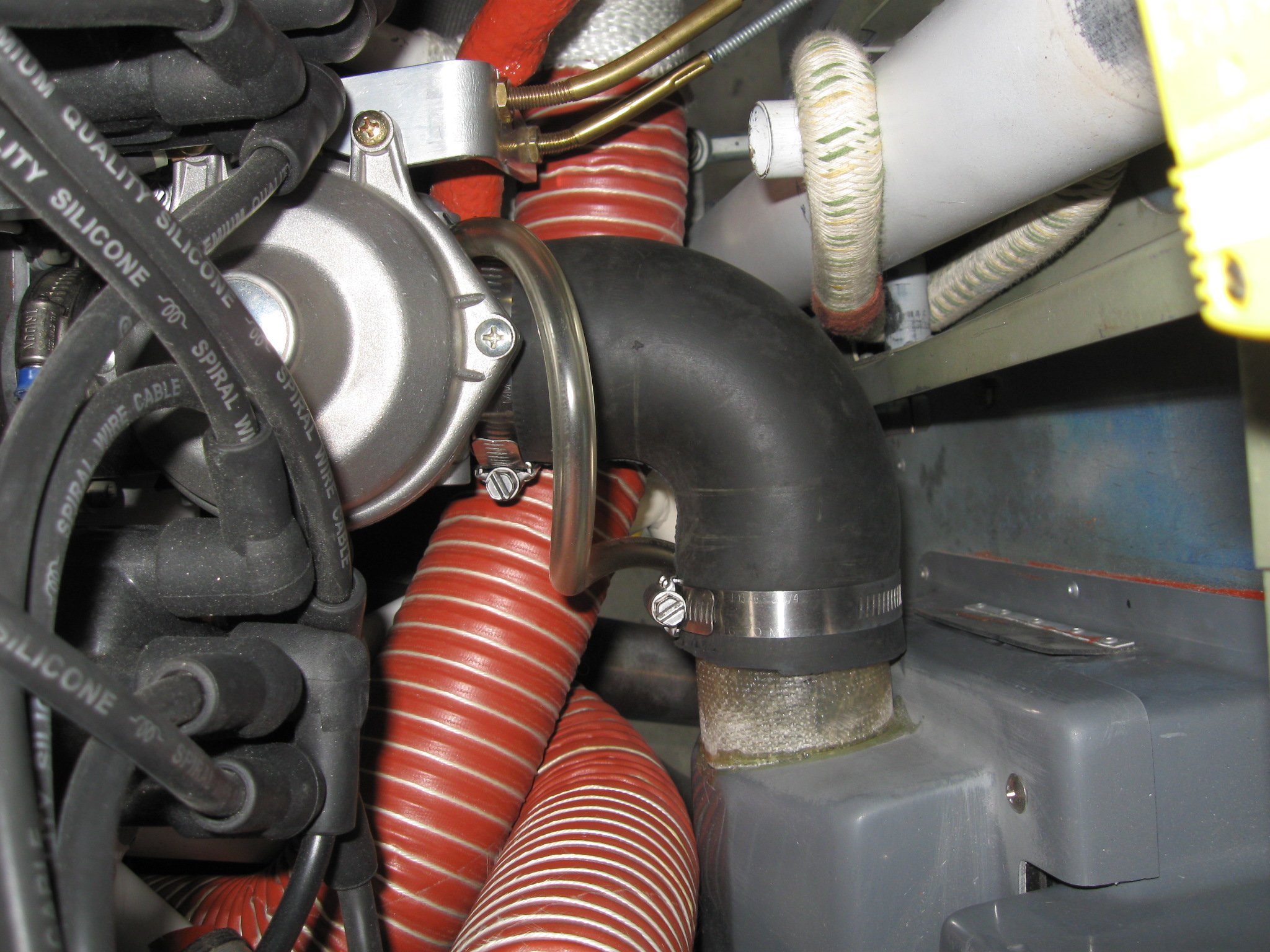

Jeff,
The Intakehoses.com 2.25" 90 degree bend hose is what I am using too. It is not as easy to install and remove as SCAT ducting, but it is working well. Picture attached.

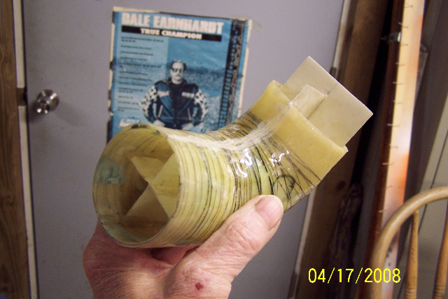

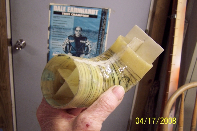

PostPosted: Thu Oct 23, 2008 5:18 am    Post subject: Cobra Head/airbox connection to the carby Reply with quote
I built my own "air straightener/divider." It was a lot of work, and
I can't say as it gave me any benefit...maybe, but I'm not positive.
Here's a picture. I started out with the curved fiberglas tube which
I built, laying fiberglas over a section of PVC plumbing. I used it
for awhile just as a curved tube, then later cut it along the
vertical axis and added the air straightening vanes, and reassembled.
