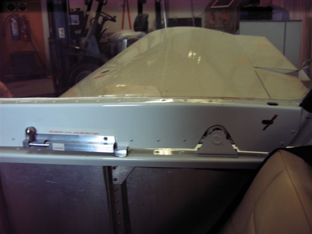

chris Sinfield
Joined: 28 Nov 2006 Posts: 270 Location: Sydney Australia
Posted: Sat Oct 18, 2008 7:31 pm Post subject: Re: Canopy Safety |
In Australia
we are recommending in the SAAA and the RAA are making it mandatory for putting in an extra safety latch or cable to all our Zodiac XL's with the older thinner Aero Plastics 80 thou canopy's. It appears that the older 2 stage locking mechanism is easy to not lock properly. This results in it only locking to the first stage and popping up just after take off.
It normally happens on the passenger side, as they don't like to slam the canopy , so lowering gently and not locking it fully.
Don't work , with the older thinner canopy if you have an accident and people need to get into the cabin to rescue you, the older thinner canopy would be easily broken by a fist, shoe or even yelling at it.. (well you would have to yell hard).
We can either have a cable system as Jan's one above or an extra lock on each side of the normal lock. If you upgrade to the newer canopy system you don't need to do this or get a Todd's Canopy as they are 120 thou.
I will try and attach some photos.
Chris.
Sydney
XL Jab3300

I'm getting really confused in the flurry of postings about the latch. Are we
saying that the old latch design is the problem, or the new latch design?

Adding to what Jay M says, the canopy latch that failed for me was the newer style. So that alone doesn't "fix" the problem.
Jay in Dallas
| | - The Matronics Zenith601-List Email Forum - | | | Use the List Feature Navigator to browse the many List utilities available such as the Email Subscriptions page, Archive Search & Download, 7-Day Browse, Chat, FAQ, Photoshare, and much more:
http://www.matronics.com/Navigator?Zenith601-List |
| Back to top |
jaybannist(at)cs.com Guest
Posted: Sun Oct 19, 2008 6:34 am Post subject: Canopy Safety |
Jim,
Neither latch is the problem. The problem is the people who do the latching.
The old style has independent latches on each side. They need to be pushed down until you hear two clicks. If there is only one click, due to mis-alignment in the installation or just not pushing hard enough, the latch is likely to come un-done. If the opposite latch has been properly latched, the canopy will not completely open. It can be re-latched independently from the opposite latch. If both latches are not properly latched, the canopy will probably open completely.
The new style latches are connected and operate together. The latches can be seen, so proper latching can be verified. However, if one side is not properly latched and comes un-done, it can not be re-latched withoug releasing the other latch. I can attest to that from personal experience!
In either case, a partially open canopy (even if it has the safety tether) should be left alone, the airplane landed and then the canopy properly latched. That is what the AMD POH says. However, it also says that the canopy will not rise more than about a foot. In my incident, the canopy rose to about 50 degrees and made the airplane uncontrollable in pitch.
Jay in Dallas

Fix a cord from the canopy bubble so you can pull it closed easily while sitting . second fit a pin on the end and mount bracket on the shelf behind to place pin in when closed . Leave 2-3 inches slack so if canopy is opened you can notice plus rescue folks can just cut it open . This way if doing a forced landing you can open the catch early , as per the doors on a plane to help getting out of a bent plane.
Sorry to hear about this accident. Hope both make full recovery.
