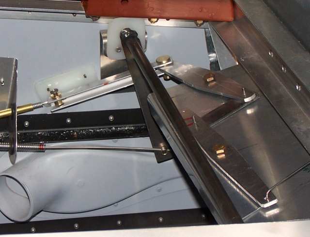

Hi Bob,
I didn't like the dual throttle in the kit, so I did a major redesign for my plane. I copied the torque tube and moved it inside the cockpit. It mounts with the arms hanging down to the bottom of the horizontal channel that runs between the firewall and instrument panel. It also mounts to brackets on both side skins. The arms are long enough that they hang down to the same level as the throttle on the engine. The throttle cable goes through the firewall at throttle height and makes its way to a new brass fitting that is only an inch long instead of the long one from the Jabiru USA kit.
I mounted the throttle knobs on the side of the cabin where my short arms can reach without leaning out of the seat. I also put the carb heat knob with the pilot's throttle knob.
All in, it was a huge change and took several weeks of effort. I do think it was worth it since the throttle is very smooth now from either the pilot or copilot side.
I can probably dig up some photos if you want them. I don't have any drawings. To build one just like mine you will need some 3/8 O.D. tubing and some flat stock to weld to it in three places. I reused the nylon bearings for the center mount location and made some new ones for the skin mount.

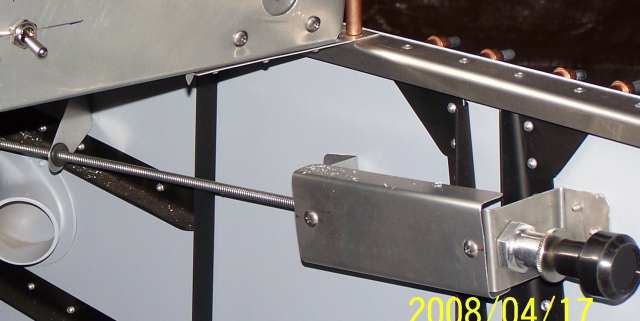

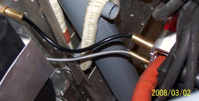

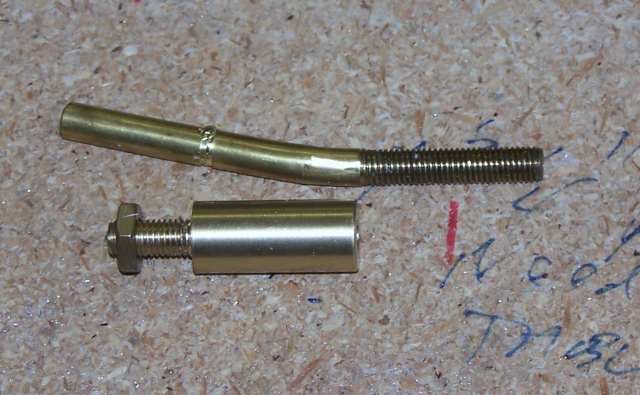

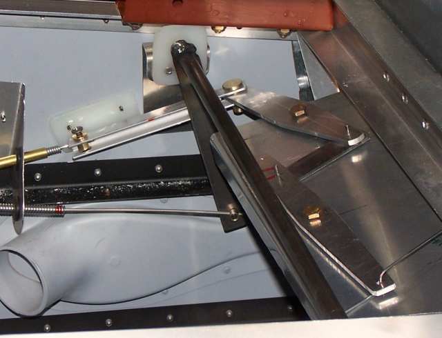

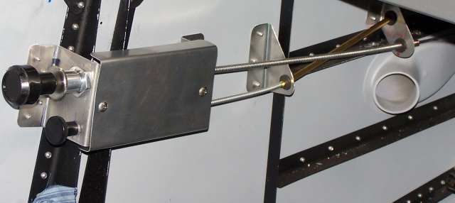

psm(at)att.net Guest
Posted: Tue Oct 14, 2008 5:20 pm Post subject: Dual throttle 601xl |
OK Peter,
Here are some pictures:
[img]cid:7.1.0.9.0.20081014181123.04e34b58(at)att.net.0[/img]
[img]cid:7.1.0.9.0.20081014181123.04e34b58(at)att.net.1[/img]
[img]cid:7.1.0.9.0.20081014181123.04e34b58(at)att.net.2[/img]
[img]cid:7.1.0.9.0.20081014181123.04e34b58(at)att.net.3[/img]
[img]cid:7.1.0.9.0.20081014181123.04e34b58(at)att.net.4[/img]
[img]cid:7.1.0.9.0.20081014181123.04e34b58(at)att.net.5[/img]
[img]cid:7.1.0.9.0.20081014181123.04e34b58(at)att.net.6[/img]
[img]cid:7.1.0.9.0.20081014181123.04e34b58(at)att.net.7[/img]

vk3eka(at)bigpond.net.au Guest
Posted: Tue Oct 14, 2008 9:12 pm Post subject: Dual throttle 601xl |
Paul,
Looks good.
Many thanks
Peter.

DaveG601XL
Joined: 27 Oct 2006 Posts: 351 Location: Cincinnati, Oh
Posted: Wed Oct 15, 2008 5:08 am Post subject: Re: Dual throttle 601xl |
Bob,
If I had to do it over again, I might do it like Paul did. I am flying now with the Jabiru FWF dual throttle system and it does work OK after a bunch of tweaks. Here are some lessons learned from my installation:
Make the throttle length from panel to firewall as straight as possible, i.e. as short as it will allow, to eliminate friction of any cable bends.
Without the forward upper skin in place, the panel and firewall flex around a lot, adding to some frustration when pushing/pulling the throttle during your assembly trails. Put some temporary bracing between them to stiffen it up.
Adding to the previous point, I added doublers to the panel and firewall where the throttle passes through to eliminate flexing there.
I angled the throttle-end adjuster down a little bit where it penetrates the firewall to reduce some of the bend where the wire exits.
I backed this same throttle-end adjuster as far rearward as I could to reduce the bend where the wire exits.
I opened up the nylon blocks to reduce friction between them and the cross rod.
I lubed the throttle cables with teflon spray lube where appropriate.
I used a drill to cone-out the throttle end adjusters both where one penetrates the firewall and well as the one that penetrates the upper firewall shelf. This gets rid of any sharp corners for the wire or cable to rub on. Be sure to get all debris out of the adjuster.
So far, after 39 flight hours, I have had no problems with the throttle system. It works relatively smoothly, but I will say that there is enough friction in the system that I rarely use the friction locks.
Good luck,
