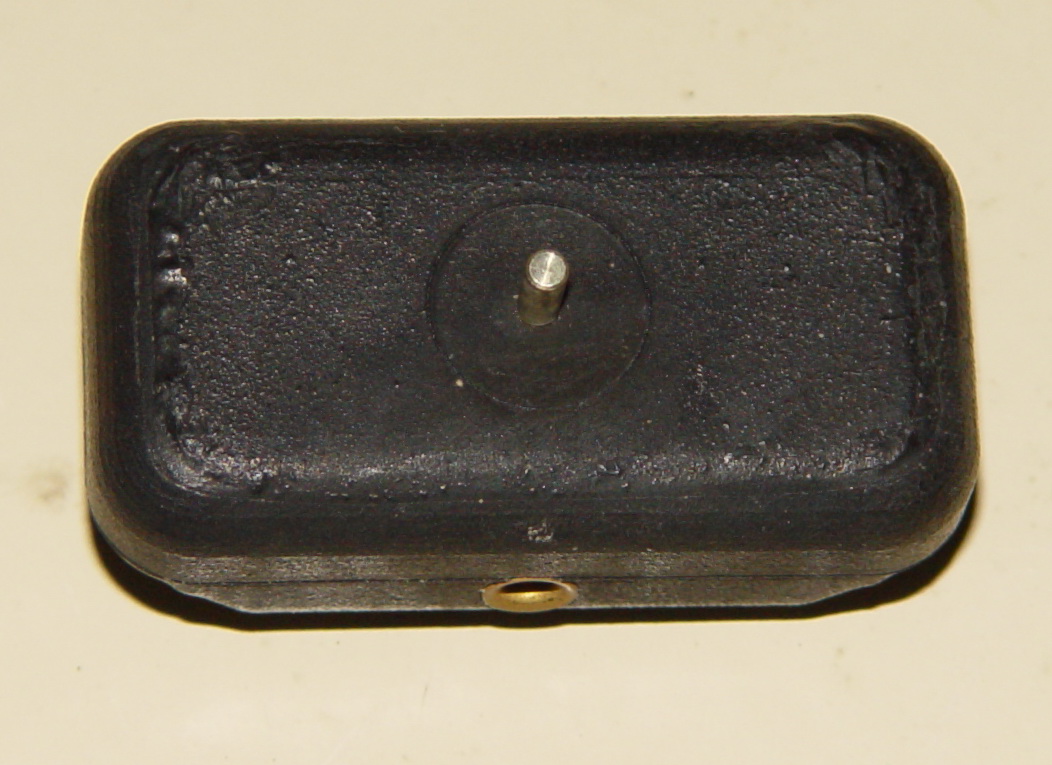

Since I am new to light sport flying I don't know if this is a direct result of using gas with ethanol or not.
I pulled my float bowls the other day and examined the floats and found one that was literally flaking apart! I took a file and scrubbed on it to remove the flaking outside plastic covering then i used my finger nail and the next thing I new my nail sunk into the foam core of the float. If I had not pulled the bowl it is possible that the flakes of the outer covering of the float could have stopped up the jets in my carbs. So that float is useless now. Luckily I had a spare on hand and have 3 more ordered.
These are bing 54 carbs

| Description: |
| Float Covering, " Paint " like material bubbling and comming off the float :( |

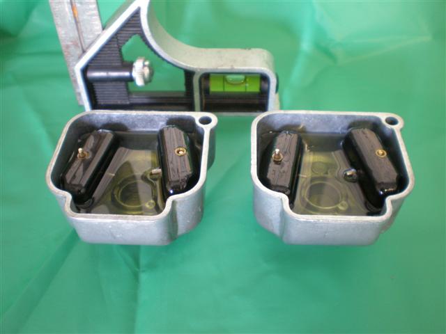

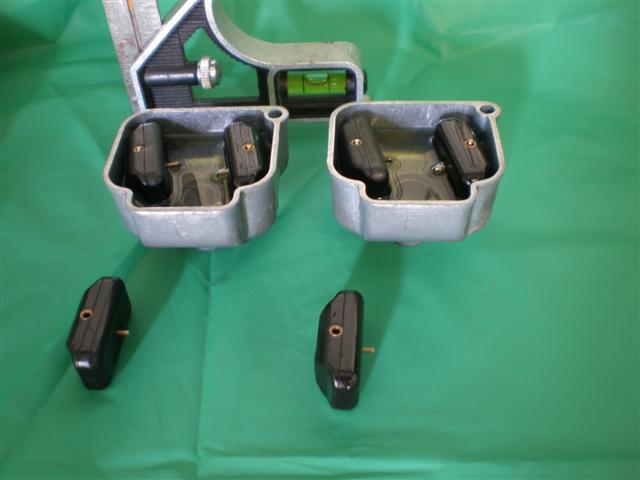

George Alexander
Joined: 10 Jan 2006 Posts: 245 Location: SW Florida
Posted: Fri Oct 10, 2008 6:19 pm Post subject: Re: Check your carb floats!! |
| grantr wrote: |
----SNIP----
After Grant's findings, pulled my carb bowls to examine the floats more closely than I do when I pull the bowls checking for stuff that ought not to be in the bowl.
Floats were not flaking and seem to be pretty solid.
However, thought I noticed one was lower in the fuel than the other. Set the bowl on a level surface and it was almost a 1/4 inch lower in the fuel. Pulled the other bowl and found exactly the same thing. The rear most float in both bowls was not sitting as high in the fuel as the forward ones.
Replaced the two that were down with new ones and all are about the same now.
Pictures are attached.
Dual carb, R503, Firestar II
Anyone want to speculate as to the reason just the left ones seem to be affected????

Posted: Fri Oct 10, 2008 8:37 pm Post subject: Check your carb floats!! |
Hi George,
When the Kolb is parked, the rear of the engine is slightly lower than the front and the carbs are tilted toward the rear. Thus the rear floats are sitting in more fuel than the front ones, albeit a very small difference. While the Kolb is sitting in storage, the fuel in the float bowls evaporates and the rear floats are exposed to the fuel longer than the front ones. They get saturated with fuel and then don't float as high as the front ones which are more dried out. I have no idea if this is the case, but it sounds good, don't you think?

George Alexander
Posted: Sat Oct 11, 2008 7:27 am Post subject: Re: Check your carb floats!! |
| WhiskeyVictor36(at)aol.co wrote: |
Bill Varnes
Original Kolb FireStar
Audubon NJ
In a message dated 10/10/2008 10:22:33 P.M. Eastern Daylight Time, gtalexander(at)att.net writes:
| Quote: | Anyone want to speculate as to the reason just the left ones seem to be affected????
Bill:
You win the prize... now I have to figure out what it is....
Your theory as to the reason is one that I had thought and also one offered up by "The Man" at THE Rotax Service Center in Central FL.
