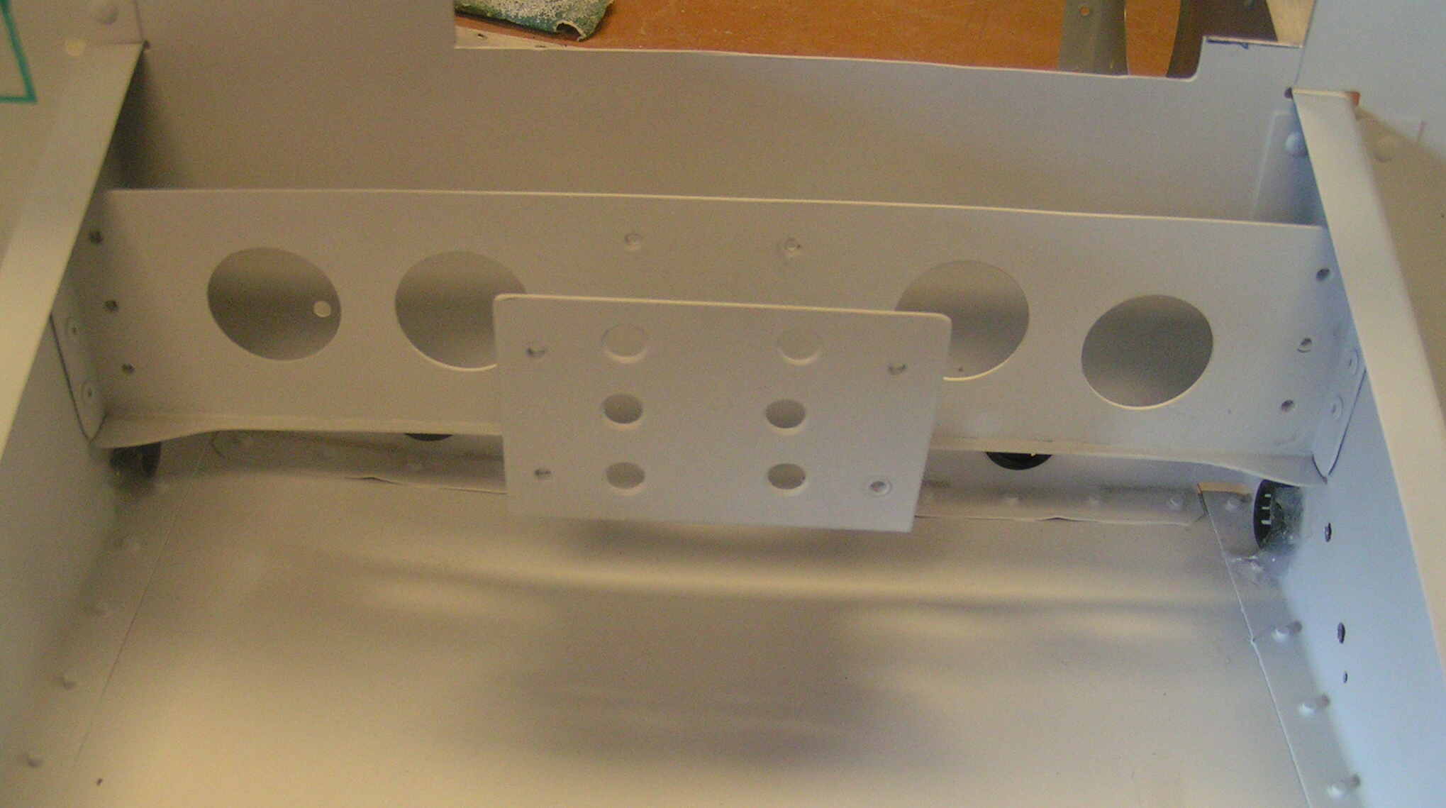

I made this bracket to support both lr3C's and a dimmer in the middle. Kind of hard to picture where this is, but the pic is the upper forward instr panel, flipped over.

I'll probably use a couple of AN3 bolts too.
I called Bill at B&C and he explained that the 6 large holes are there
to facilitate replacement installations in various other aircraft.
I just wanted to see if I was missing something - I wasn't.
and thanks for the pic Don.
