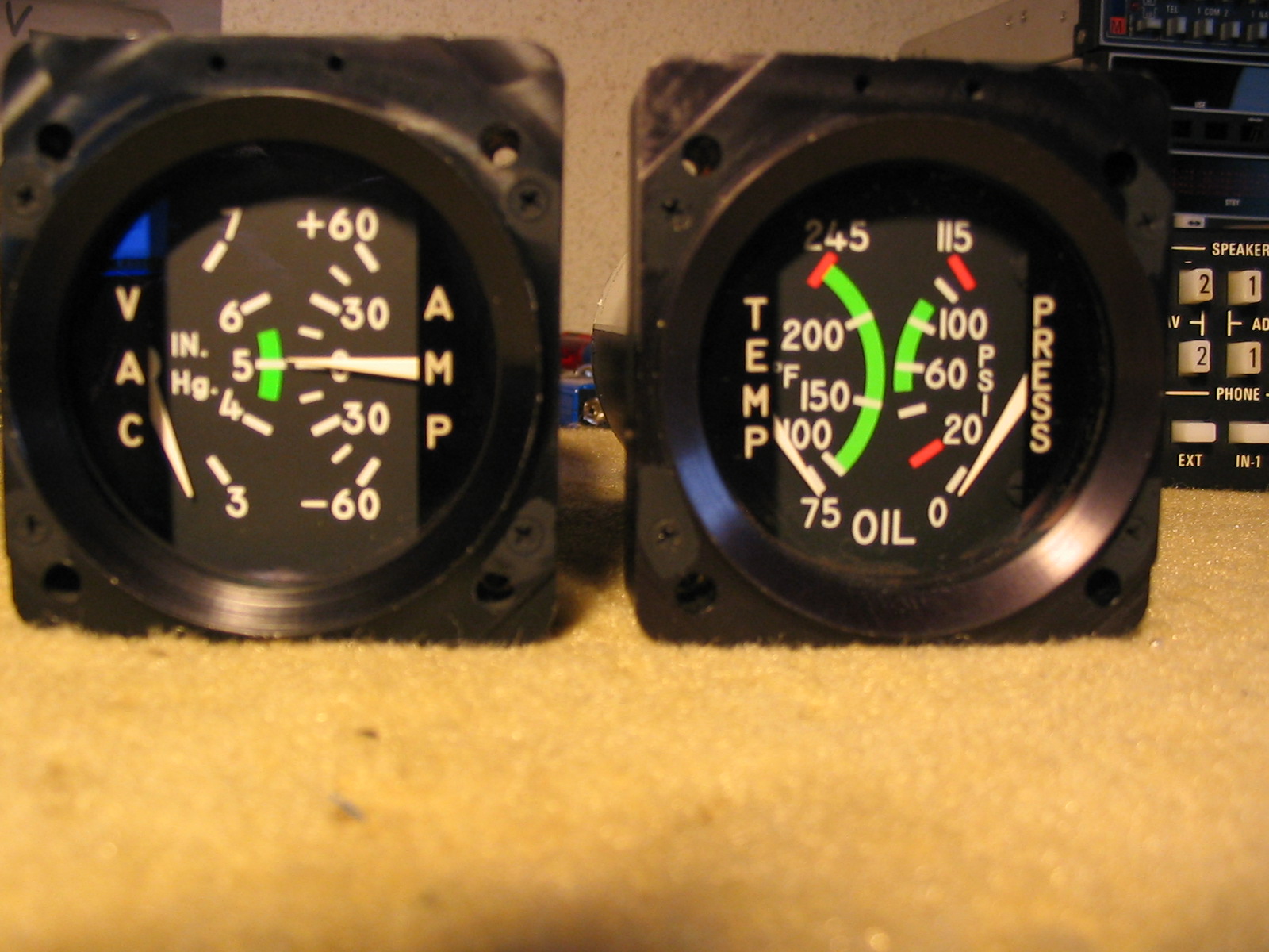

bouguy
Joined: 23 Jan 2008
Posts: 8
Location: France
PostPosted: Sun Aug 17, 2008 12:39 am    Post subject: Re: Rochester dual indicator Reply with quote
Hi Bob ,
these instruments are not old and are 2 1/4 standard dimensions ;
they are not embedded in a cluster ; look at the attachement .
so if i need to change them there will be no problem !
they are fitting the latest C172 i have seen .
if you may have information on senders it will be great ;
if not i will try to find another solution , but for the time i
try to save money .
thanks for your help ,
Boullu guy .
 Filesize:  395.22 KB
 Viewed:  742 Time(s)
nuckolls.bob(at)cox.net
PostPosted: Sun Aug 17, 2008 6:16 am    Post subject: Rochester dual indicator Reply with quote
At 01:39 AM 8/17/2008 -0700, you wrote:
Hi Bob ,
try to save money .
Understand. I was not aware that Rochester was still
building for Cessna . . . but it doesn't surprise me.
I guess I should have picked up on the magnitude of
the S-number you quoted. When I worked there, the
current production products were in the 1000's range.
I'll see what I can find out about these parts.
