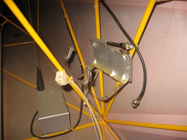

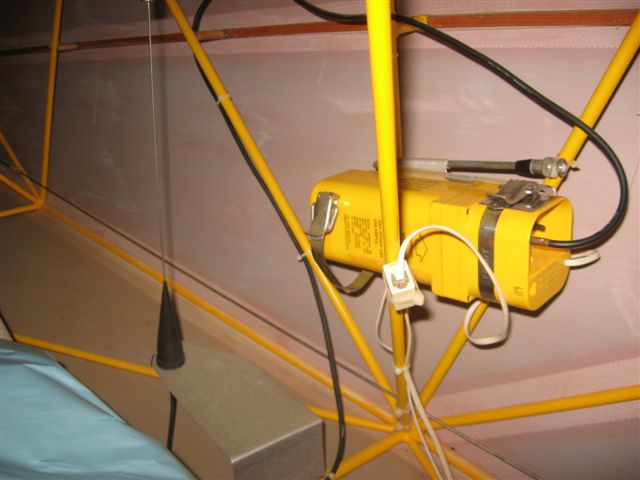

Hi Bob C  here is how I mounted my ELT in my Avid MK IV. That is the tubeing behind the seat C under the turtle deck.  Kitfox 2 tubing might be different C my Kitfox 4 project is C but the ELT could be put in the same place on it if need be in a similar fashion.  Jim Chuk  Kitfox 4 building C Avids flying  MN

 Filesize:  160.22 KB
 Viewed:  714 Time(s)
 Filesize:  157.17 KB
 Viewed:  691 Time(s)

Thanks Jim, and it looks like the same model ELT as well. The Model 2 tubing is very different yes, and the flaperon control rods travel through that area when folding/unfolding which is why I can't put storage bags or anything else there easily.

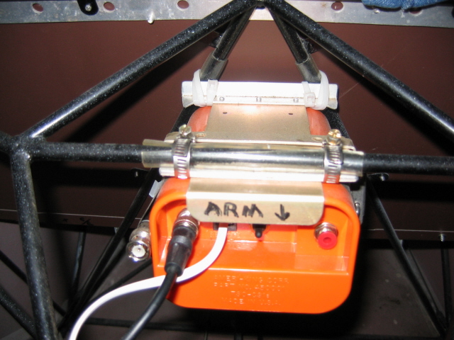

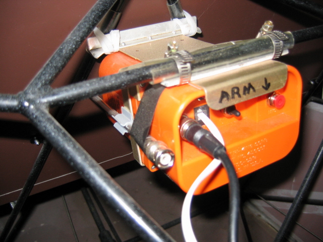

On my model 2, the ID plate is riveted to the aluminum inspection panel just below the horizontal stab on the left side. FAA considered that "part of the plane", I guess.
As for the ELT, I made a triangular mount out of aluminum angle and attached it with adel clamps at 3 points to tubing just forward of the header tank, at the mid-line behind the seats. It's accessible through the triangular opening in the cloth liner covering the area just behind the seat.

Anyway, here's pics of my install, I'll have to change to 406 I guess.

That's what I did, on the pilot's side. It seems to be a good location and
easily accessible. The only problem I am having now is mounting the antenna
- it's supposed to be a minimum of 5ft from the radio antenna and since that
is dead amidships it doesn't leave many options. I was thinking of mounting
it about 6" from the radio antenna using the same plate, and figuring that
if the ELT goes off automatically in a crash I will be in no shape to be
using the radio anyway, and vice-versa. If I'm capable of using the radio I
can just turn the ELT off, if not - it will work as it should.
But I'm also reluctant to add more drag, do I really need that 2nd antenna?
Does everyone with and ELT have a dedicated external antenna?
For the inspection tomorrow I have connected the ELT to the antenna and put
the hand-held antenna on my radio, which is a hand-held anyway. I won't be
using the radio for a while so can consider options after I start flying
again.
Bob Brennan
1991 UK Model 2 Kitfox
Rotax 582 with 3 blade prop
Wrightsville Pa

Good to see lots of you using the same cheap model. And I found it without even posting a request!
I see you have the antenna mounted internally. I considered that but what about the metallic UV-resistant coating that goes on before the color coat of paint? I would think that would be like broadcasting inside a Faraday Cage ie not a "good thing"

You must be going the amateur built route for registration ? How did you attach the mounting plate to the tubes? I think in AC 43.11 there might be a requirement fora certain G force that it can withstand. your MDRA inspector will know best.

Hi Dave, I wasn't really looking for a noise, it was a statement modelled on
an old philosophical question.
I truly hope that COPA is successful but It's not looking good.
In any case the rack is clamped to the fuselage using Adel clamps, and the
antenna is internal because the manual allows for it. I agree that the
silver coat may impede radiation somewhat, but it seems to work ok.
