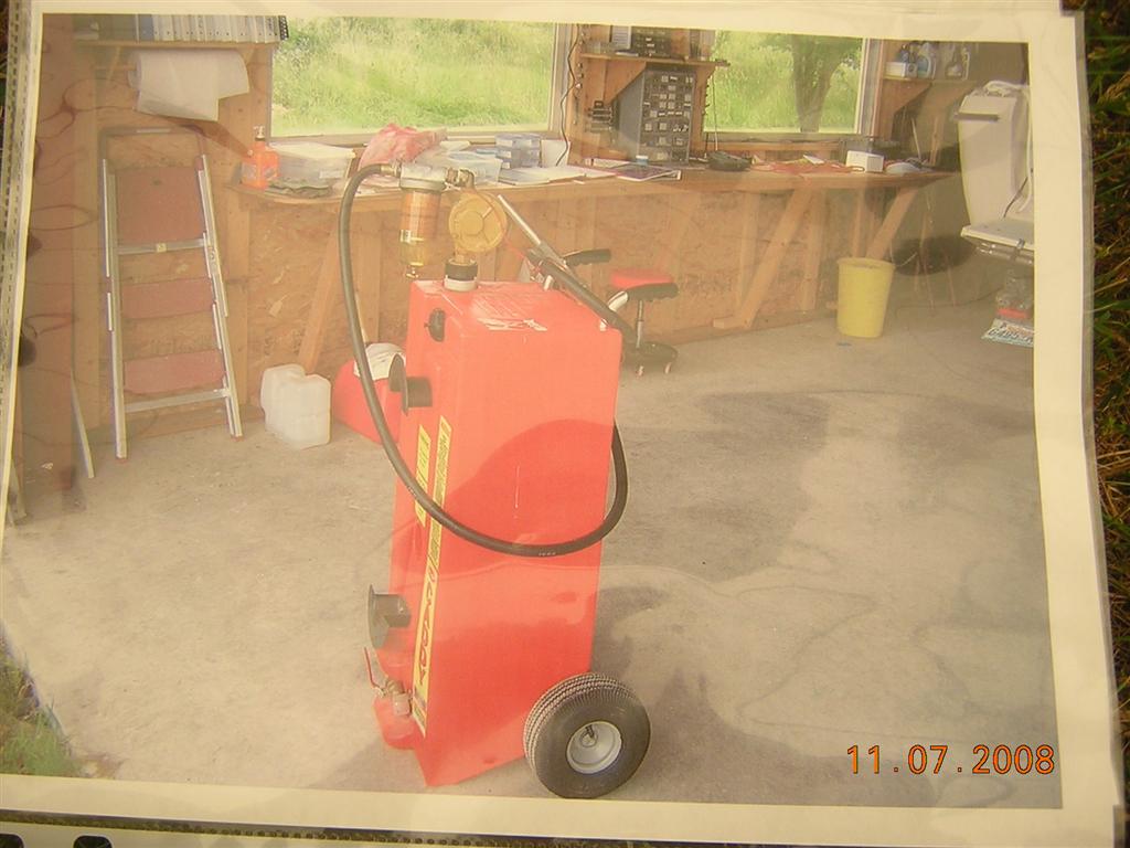

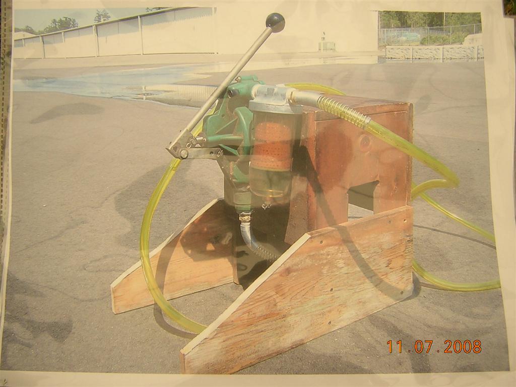

Craig
Donald Hall gave a talk about fuel systems at the Arlington Flyin. He
said that he has been using mogas for 20 years with the two pump systems
shown in the attached photos. He said that the large gascolators on the
pumps was very important to keep crud out of the gas tank. These photos
are my photos of his prints, so, they are not the best. My impression
was that he brought gas to the airplane in 5 5-gal containers and pumped
from there.
Pump_2 is an adaption of a commercial unit with an electrically driven
pump. If you Google something like "gas caddy" you'll find items that
look like pump_2 (without the gascolator), but they are not cheap.
Terry
