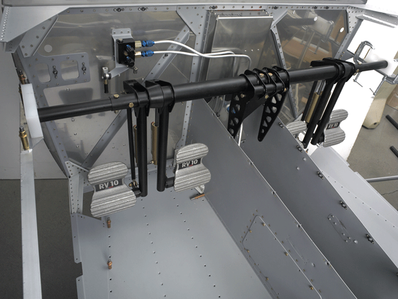

Bldgrv10450(at)comcast.ne
PostPosted: Tue Jul 01, 2008 12:35 am    Post subject: Rudder pedal mounting Reply with quote
Dave
I didn't use any spacers on mine. I do however have an alternate center support bushing and mounting bracket that attaches to the stock firewall support bracket, not shown in the photo.
Feedback and questions are welcome however please be understanding, I am typing one finger / left handed from rotater cuff surgery last week.
Paul Grimstad
RV-10 450
Portland, Or.

drfred(at)suddenlinkmail.
PostPosted: Tue Jul 01, 2008 6:23 am    Post subject: Rudder pedal mounting Reply with quote
Paul :
Great looking set of pedals for the 10. Hope your recovery is
progressing well.
Fred Williams.

PostPosted: Tue Jul 01, 2008 6:42 am    Post subject: Rudder pedal mounting Reply with quote
Wow, now that is what the factory should have designed. And the cables are concealed within the tunnel. Reminds me of building hot-rods. Is the foot pressure stiffer than stock?
Nice photo.

So when are you going to share (i.e. market) those beauties with the
rest of us ???????
Deems
and the brake cylinders and plumbing are 'hidden' on the back side!!!!!!
PostPosted: Tue Jul 01, 2008 8:12 am    Post subject: Rudder pedal mounting Reply with quote
Deems,
There is one builder that should be installing a set very soon. I will be
working closely with him on the details.
Marketing effort is slowly underway, for now we are just happy to be back to
building our 10 kit and working on pedal design for the RV6,7 & 9.
Additionally, I have several pedal sets sold and we are planning a small
production run. The system cost is $1,795.
Paul Grimstad
RV10 450
Portland, Or.
