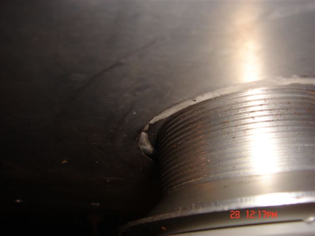

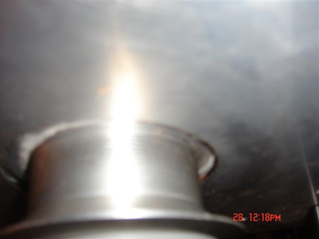

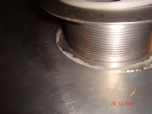

I didn't do a good job of describing the problem. The reason that the caps are not flush with the skin is that the filler tubes, which are screwed into the tanks do not screw down far enough. The filler tubes have a beveled shoulder at the top, and the top of the tanks are not beveled. The cap and top of the filler tube extend each extend up beyond the outer skin

Here are photos of the fuel neck with the cap on. It shows the bevel or flange at the top of the fuel neck, but there is no corresponding bevel in the top of the fuel tank hole. It screws in, but stops at the bottom of the flange.

Looking at your pics my hunch was correct... you have the skins too close to the tank. I have the same caps you do and if you only use one row of cork on the bottom you will have close to a 10 to 12 mm gap between the tank and the top of the skin then you build around the filler neck with a couple of layers of cork to make up the difference and to level out the top of the neck. I will be building mine in a week and it takes me 2 weeks to finish them so I will post some pics on my web site.
