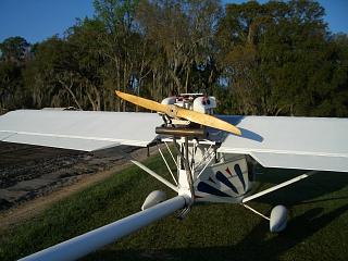

Pat,
Noise is a problem.Here is a picture of my home made exhaust system.Also requires sealing the fuselage tube to keep exhaust from coming up the tube.

.Here is a picture of my home made exhaust system.>>
Hi,
I had something on those lines in mind. Did it accomplish anything?
Pat

Pat,
Would you prefer the truth or do you want me to tell you how much it helped?I lined the entire cabin and over head center cover with 1/2" denso foam sound control foam.Doesn't weigh much and now I can actually use the intercom at 2700 rpm,but not at full throttle.It's not the engine,it's the prop.It sounds so good at 1800 I wish it would fly at that rpm.I really thought that a geared engine would get the prop noise down to a tolerable level,but I can't address that.I think Mr. Pike has made some cabin mods that may be more productive in suppling cleaner air flow to the prop,which may reduce noise.Like John said,I guess I'll just have to get OVER it and enjoy the flight!
