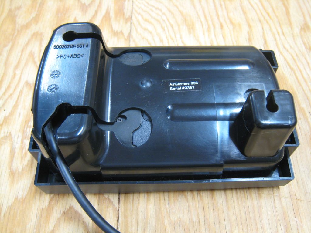

anyone with a air gizmo with a garmin,what did you use for power plug to the garmin?
i dont know what to use to get the power to it without running cables in front

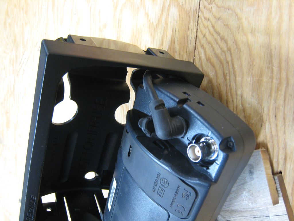

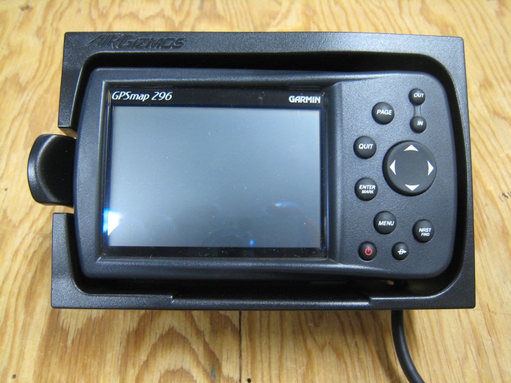

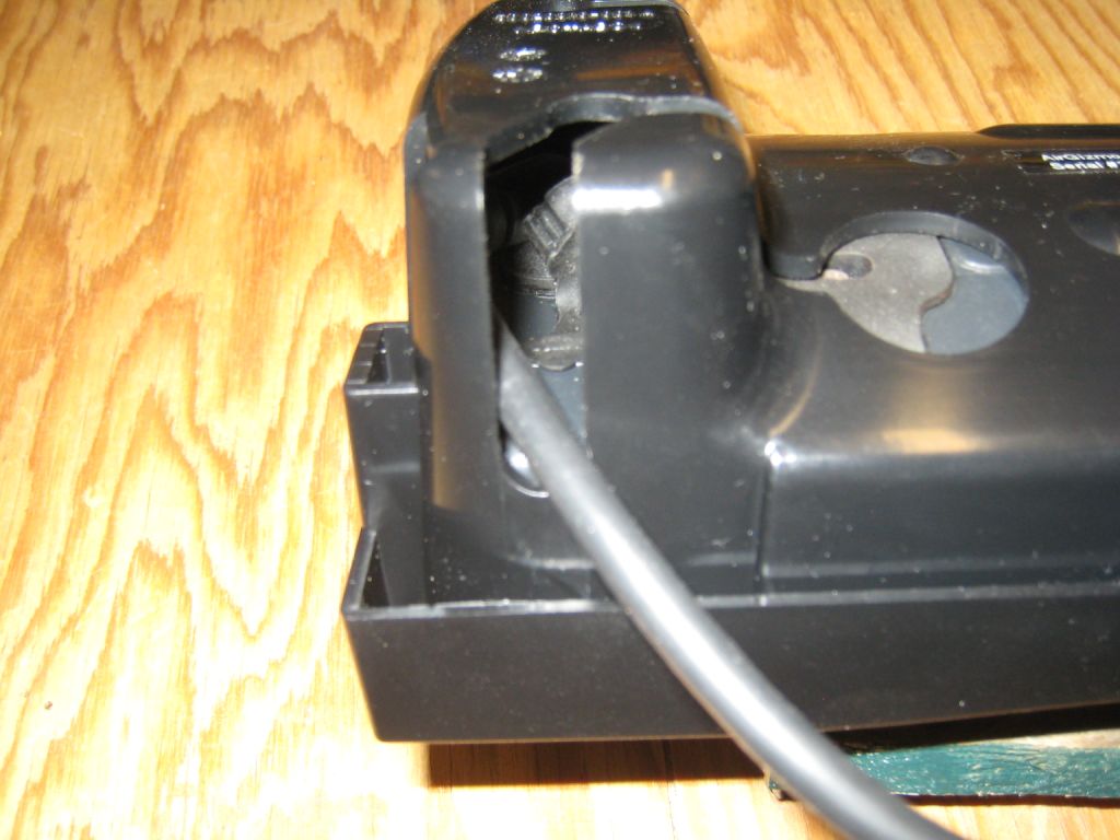

My 296 fits fine with the cable shown in the attached picture. This is the older "396" dock before Air Gizmos redesigned it to accommodate the extra cable on the 496. The p/n of the cable I use is 010-10513-00. It ends in bare wires. Info here:
https://buy.garmin.com/shop/shop.do?pID=1083
-- Craig
