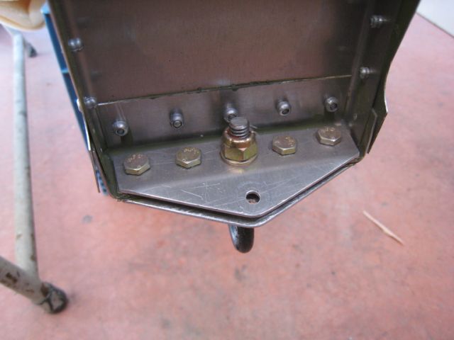

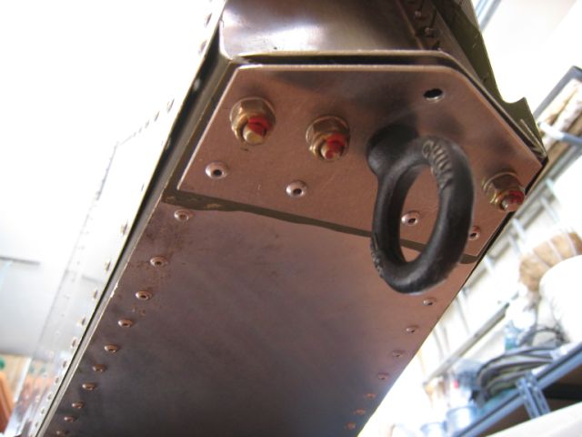

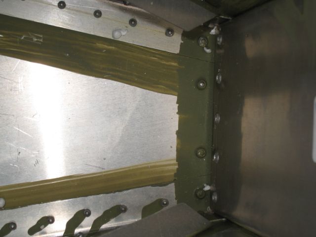

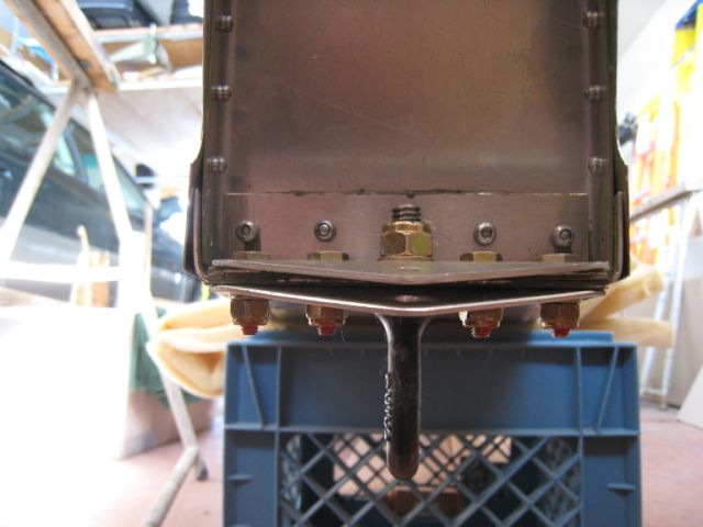

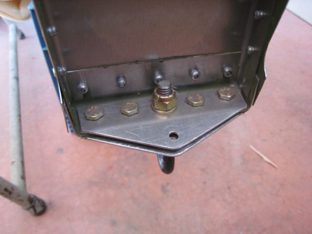

OK so assuming that the prints are incorrect on the number of A5 rivets it says 6, someone has confirmed with Zenith that the correct # is 4, is the number of bolts still 4 as indicated in the drawings? Two are shown in the manual.... Yes, I understand the drawings take priority over the manual and not to count the x's for rivets. Anybody mind taking a look at their QB kit? How is Zenith installing them these days?

PostPosted: Sat Feb 23, 2008 11:23 am    Post subject: Bottom Rudder Bracket attachment Reply with quote
Take a look at these shots of my QBK.
-- Craig
