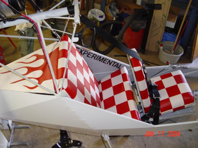

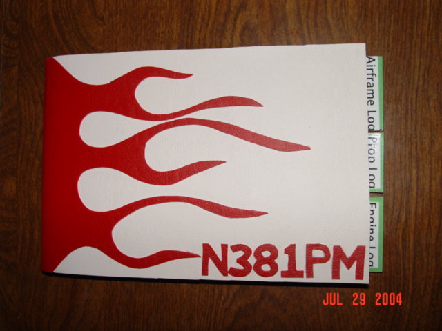

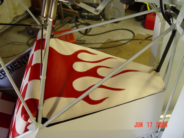

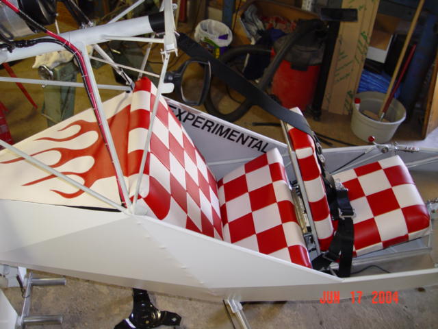

PostPosted: Sat Feb 02, 2008 2:20 pm    Post subject: Re: covering Reply with quote
I will be enclosing the whole thing ( one of these days )
But, till then ... This is how I did mine....
The " Flame " cover , is Velcro'ed ....and lifts easy for refueling...
Gotta Fly...
Mike & "Jaz" in MN

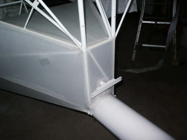

PostPosted: Mon Feb 04, 2008 9:57 am    Post subject: covering Reply with quote
My thinking is, as a propeller swings close to the fairing it may slam air
against one edge of the fairing.
Mike W
Mike W:
Seems like some 4130 tabs welded to the rear verical fuselage tubes would
have been ideal for attaching a sheet metal or fiberglass fairing. Already
got the fabric on though. ;-(
I had mine covered, flown 100 hours, when the fabric fairing I had
originally designed and fabricated got beat to death by the prop. I didn't
have any choice but drill the vertical tubes to rivet the aluminum fairing
in place. Don't forget the tube seal. Mine has performed well.
I think I would design and build the tail fairing straight. Over the years
I have done a lot of experimentation with stuff, attempting to overcome
adverse yaw in the mkIII. Of all the experiments I have done, an oversized
rudder trim tab works best. All the other stuff was a waste of good time
and effort.

PostPosted: Mon Feb 04, 2008 2:03 pm    Post subject: Re: covering Reply with quote
A question about the covered cage section:
Is the fabric wrapped around the outside of the frame and then curved around the metal tube and glued onto its backside inside the cockpit or does it only get glued to the metal tube itself?
As far as streamlining the the cockpit, and having done actual streamlining experiments in a wind tunnel(not on a Kolb) I can make the following comments:
The streamlining behind the cockpit would be most beneficial for reducing drag and smoother airflow to the prop if it ended sharply instead of a blunt end that will create vortices.
Even offset to a sharp point would be better than straight and can be done to the side that would help counteract P-Factor a tiny bit. (Depends which way your prop is turning)
However the tip of the prop may be doing 450 mph at full throttle and at that speed the prop probably does not care much about a few small vortices, although you may reduce prop noise a tiny bit.
On the other hand streamlining behind the cockpit/seat would likely have some tangible benefits from a drag reduction point of view and just plain looks nicer.
If I was doing it I would go with the sharp point fairing behind the seat.
