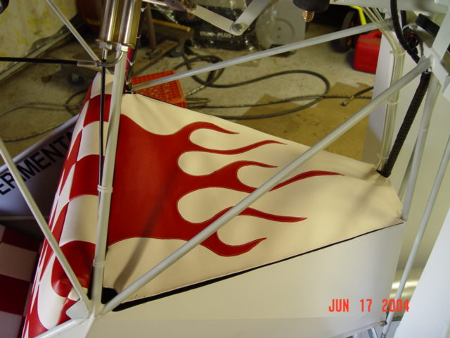

I will be enclosing the whole thing ( one of these days )
But, till then ... This is how I did mine....
The " Flame " cover , is Velcro'ed ....and lifts easy for refueling...
Gotta Fly...
Mike & "Jaz" in MN
Building Buttercup...

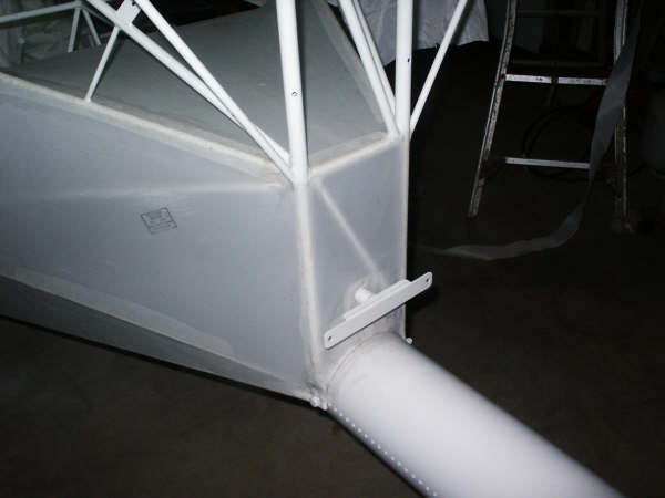

For the moment I just wrapped the end of the fuselage with fabric. Since my engine/prop is removed, I don't know the clearance for building a fairing, yet.
My intention is to build either an aluminum or fiberglass fairing, once the prop is replaced. To be honest, I'm not real sure how much clearance there should be, between the fairing trailing edge and the prop blades. Any recommendations, you'ze guys??

My thinking is, as a propeller swings close to the fairing it may slam air
against one edge of the fairing.
Mike W
Mike W:
Seems like some 4130 tabs welded to the rear verical fuselage tubes would
have been ideal for attaching a sheet metal or fiberglass fairing. Already
got the fabric on though. ;-(
I had mine covered, flown 100 hours, when the fabric fairing I had
originally designed and fabricated got beat to death by the prop. I didn't
have any choice but drill the vertical tubes to rivet the aluminum fairing
in place. Don't forget the tube seal. Mine has performed well.
I think I would design and build the tail fairing straight. Over the years
I have done a lot of experimentation with stuff, attempting to overcome
adverse yaw in the mkIII. Of all the experiments I have done, an oversized
rudder trim tab works best. All the other stuff was a waste of good time
and effort.
_________________ John Hauck
Titus, Alabama |

A question about the covered cage section:
Is the fabric wrapped around the outside of the frame and then curved around the metal tube and glued onto its backside inside the cockpit or does it only get glued to the metal tube itself?
As far as streamlining the the cockpit, and having done actual streamlining experiments in a wind tunnel(not on a Kolb) I can make the following comments:
The streamlining behind the cockpit would be most beneficial for reducing drag and smoother airflow to the prop if it ended sharply instead of a blunt end that will create vortices.
Even offset to a sharp point would be better than straight and can be done to the side that would help counteract P-Factor a tiny bit. (Depends which way your prop is turning)
However the tip of the prop may be doing 450 mph at full throttle and at that speed the prop probably does not care much about a few small vortices, although you may reduce prop noise a tiny bit.
On the other hand streamlining behind the cockpit/seat would likely have some tangible benefits from a drag reduction point of view and just plain looks nicer.
If I was doing it I would go with the sharp point fairing behind the seat.

Mike,
For aerodynamic purposes, it's best to minimize the transition angles
that the air has to follow - if the angle is too great, the air flow
will separate (as in wing stall) and you will loose the benefit of the
fairing. In the case below, the angle on the right side might be a bit
steep, depending on how long your fairing is. For a given length, the
shallowest angle would be achieved by a symmetrical fairing. When I
worked on pneumatic aircraft systems, we tried to keep angles of sharp
transitions (i.e. the angle from one surface to the next along a
streamline) to less than 7 degrees, but that was probably conservative.
The prop clearance you need highly depends on the prop. The IVO prop
needs a lot of clearance because it flexes so much. (I think they
recommend at least 5"). Also, as you pointed out, the airflow near the
prop is somewhat complicated, so I think you would want some separation
in order to minimize vibration due to interaction of the prop and airframe.
Dan G

I'm fairly familiar with the design requirements of a smooth flowing airfoil. Without my (Ivo)prop in place, I can't quite tell what shape that fuselage trailing edge fairing would actually be. I think I was more musing, rather than actually suggesting a specific shape.
As a propeller blade is swinging past this fairing, would there be any advantage at all if the fairing has a "more angled" edge?? I guess that would depend on the distance to the fairing and the angle it has to swing past.
I just walked out to my shop and took a look at the area in question. The aileron tube (and corresponding hardware) really interfere with the ability to buiild a very effective fairing. Plus, the fact is you don't get much room to build something terribly fancy. I think this is one of those cases where you do the best you can...and call it good.
Now, those wing strut end-fairings Uncle Craig built....those would really be nice to have!!
Mike Welch
