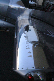

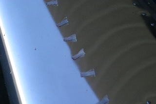

Andy Shontz:
You asked;
"One thing, it appears as though on landing the nose comes down pretty
quick. I think other people have noted this one their XLs as well. Is
it fairly difficult to hold the nose up once the mains hit?"
I assume the XL is similar to the HDS and it was impossible to hold
the nose up on ours after touchdown. We solved that problem by
placing VG's on the bottom side of the horizontal stabilizer. With
the VG's there, you could aerodynamic brake down to about 20 mph.
Your other question:
" I was thinking a tail skid of some sort might be a good idea when I
get around to building the fuselage, to not only protect the fuselage
but also the rudder."
The HDS had a very effective tail skid in the tie down ring. I
discovered how effective it was when I failed to ask my BFR check
pilot how much he weighed. I had planned on 170# and after grinding
down the tail skid on takeoff I found he weighed 240#.
Stan
p.s. Let the flames began.

You'll find the details of my flight test with VGs on my 601 HDS in the archives. They are well worth the money.
Dave Austin 601HDS - 912, Spitfire Mk VIII

For info on the HDS wing with VGs have a look at http://www.stolspeed.com/content.php?id=57

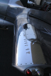

Terry:
How many VG's? I believe there were 42 VG's on each side. I used the
same spacing and template on the underside of the stabilizer as I did
on the wing so there would have been about 2.5" between them. They
were placed at 10% of the chord. The below photos are of the wing.
Guess my neck was already stiff from working upside down applying them
so I skipped the photos.
Stan

driving the nose wheel to the ground.
The elevator, of course, is designed to bend the air flow so that, by
pulling back on the stick, the force exerted by the stabilizer/elevator
can be changed from the upward force that would exist with a neutral
elevator, to a net downward force. But, if I interpret Stan's results
correctly, the unmodified zodiac elevator is incapable of holding the nose
up after touch down. But, Stan's addition of VGs to the underside of the
stabilizer, increased the effectiveness of the elevator on Stan's
airplane. Then he could hold the nose up until he slowed to 20 mph.
So that's what it looks like to me.
My understanding of VGs is that they function by causing the laminar
boundary layer over an airfoil to transition to a turbulent boundary
layer. Turbulent boundary layers (for reasons I do not understand) stay
attached better than laminar boundary layers. And by staying attached, the
airflow over the airfoil exerts a net lower pressure on the bottom of the
stabilizer/elevator (think Bernoulli's law), thus effectively pulling the
tail down (and the nose up).
There are a couple of other effects in play here.
One is that, on the ground, the plane will rotate around the mains, rather
than around the cg. The cg is forward of mains, so the moment arm of the
stabilizer around the center of rotation is shorter when the plane is on
the ground. So moment from the force produced by the stabilizer will be
less than the moment produced by the same force when the plane is flying.
So, on the ground, a greater downward force is needed to raise the nose
than when flying.
The second is that, when the plane is flying, the wings must cause the
airstream aft of the wings to deflect downward (to balance the upward lift
on the wings). So, the horizontal stabilizer sees an airstream that has a
net downward velocity. If the horizontal stabilizer is to generate a net
upward force at cruise, then it must be inclined upward at a great angle
than would be necessary if the airflow were horizontal. On the ground, the
wings still try to deflect the air flow downward. But the ground is in the
way. So the airstream the horizontal stabilizer/elevator sees will be
flowing nearly parallel to the ground. The horizontal air flow on the
ground should further increase the upward force generated by the
So, why is Stan's result important to me, since zodiac's have been landing
just fine for years, plunking their nose down on the runway right after
touch down? One reason would be soft field takeoff and landing capability.
In a 152, a skilled pilot can land on the mains, and keep the nose up,
until, maybe 20 mph or less. And with full up elevator one can taxi a 152
with the nose way up in the air, thus reducing the nose wheel loading. I'd
like to be able to imitate that with my zodiac on some of the back country
airfields here in western Montana. So, I think Stan's result is pretty
exciting.

Yes, the forces exerted by the stabilizer and elevator are generally
downward. Only when you push on the stick is there an upward force
from the elevator, and you don't tend to do that often. I figure
that means the leading edge of the stabilizer should be slightly down
compared to the trailing edge. I haven't yet set my stabilizer in
place so I am not sure how the design calls out this angle.
If you use tricycle gear configuration then the main wheels must be
behind the airplane's CG. If not, the tail will slide along the
runway rather than the nose gear meeting the runway. When landing,
the transition from controlling rotation around the CG to rotation
around the main wheels happens as you described nicely in your fist
message yesterday. Since the forces were in balance and probably
nicely trimmed out just before touching down it is the amount of
nose-down force caused by the relationship between the CG and the
main wheels that makes this whole story work. If the main wheels are
too far behind the CG then the nose will come crashing down as the
weight of the plane is transferred from the wings to the
wheels. This problem is more pronounced if the CG is at the front
end of the envelope.
You can spend a lot of time getting the CG to work for flying
conditions, and this has little impact on the behavior of the plane
when the wheels are holding the plane up. It is more important that
the flying stability is correct than the landing dynamics are
comfortable. That means (to me) that the way to correct the landing
situation is to move the wheels rather than moving the CG. For this
tendency that some (not all) Zodiacs seem to have to force the nose
down quickly on landing the solution seems to be to move the main
wheels forward. I don't know how much movement is needed, but the
first step is to mount the main gear with the flat edge forward to
make the wheels move a little forward of the position they would have
if the flat edge is mounted facing aft. If this isn't enough to fix
the landing difficulty then it starts getting a lot harder to change
the plane to get nicer landing behavior.
The other side of the main wheel vs. CG question comes in when you
have 250 pound folks standing on the step behind the wing to get into
the plane. If the wheels are positioned nicely for the landing
dynamics to work out then the plane will tend to drop to its tail
when the big guy (or gal) tries to get in. As with chemical and
electrical engineering, airplane design is a game of trade-offs.
I hope this discussion helps us understand the landing issue. My
plan is to use the flat side of the main landing gear mounted forward
and hope for the best.
