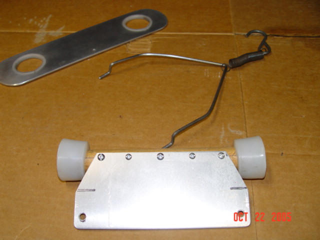

I use mine to keep the wing secure in the transport mode....
Gotta Fly...
Mike & "Jaz" in MN
PS I would also like to secure them to each other in flight for a little
extra strength...
