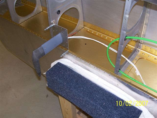

PostPosted: Sat Dec 22, 2007 6:57 am    Post subject: Gretz Pitot Instructions Reply with quote
Patrick,
I’ll borrow a quote from John Cox for you on this “Make sure you take off your builder hat and put on your repairman/serviceman hat…”.
Although not technically that difficult to install think about maintaining it after installation. I did not think about install or location when I cut the holes for my bracket which I ended up putting it in the stock Van’s pitot location. It worked out ok but I had several technical hurdles to overcome.
The copper tube coming out of the pitot tube itself came straight up into the aileron torque tube requiring a healthy bend to maintain clearance while the tube moved fore and aft. The mounting locations for the circuit board in this location are sub optimal for ease of wire installation and maintenance due to the aileron pushrod and bellcrank parts. Think about threading the wires up through the pitot tube hole and guiding them into their install location on the circuit board and then tightening the miniature screws. You also have to secure the aluminum pitot line to the copper line through an inspection hole after installing the bottom wing skins.
Pictures of my installation can be found here: [url=http://www.sinkrate.com/rv10/pics.asp?f=wings|pitot]http://www.sinkrate.com/rv10/pics.asp?f=wings|pitot[/url]
I ended up making short length wires and connectors that I could attach to the circuit board prior to closing up the wing. I used a locking 2 wire molex plug for the power wires and dean’s plug for the thermistor wires. My thoughts were to make the actual installation of the tube into the finished wing easier. One thing to think about too is what happens to moisture that may accumulate on the wires? The circuit board should be on the top side of the wing so all wire runs coming out of the unprotected holes are not subject to water droplets running down the wires and into their attach points. I am considering encasing the wires in silicone but have not yet done that.

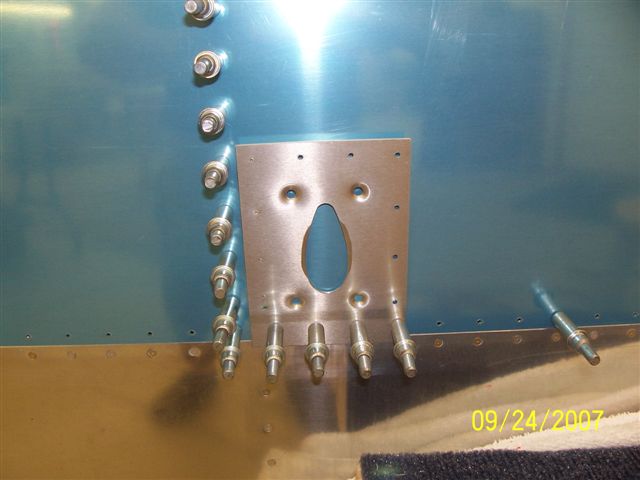

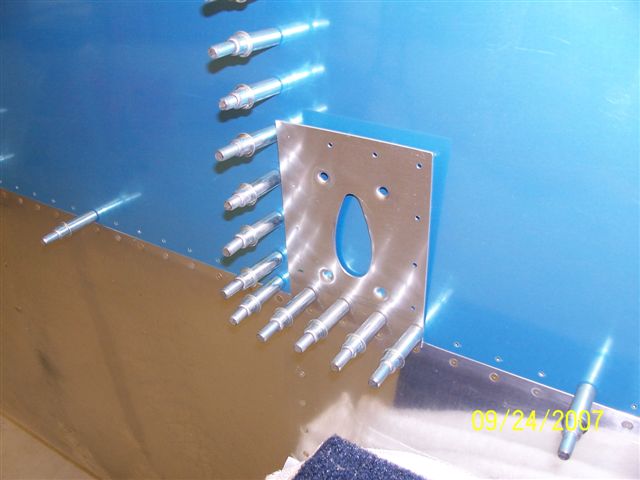

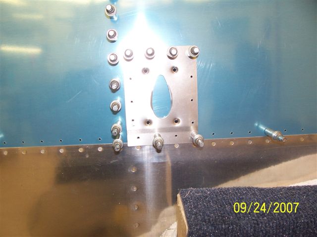

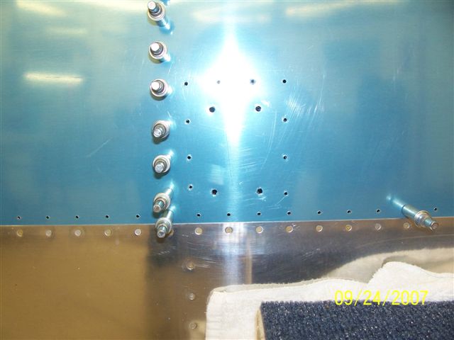

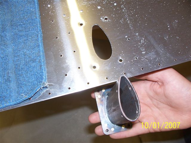

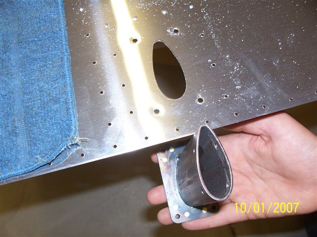

PostPosted: Sat Dec 22, 2007 6:52 pm    Post subject: Gretz pitot instructions Reply with quote
I used the mount for a template and drilled and traced for the hole after clecoing it over the skin. Then I used my step drill to enlarge the mount hole. Then trimmed the hole to the line with my dremel. I mounted the thing in the bay just outboard from the aileron inspection cover. The circuit board is mounted to the inspection cover itself. Makes the wire connections easy to get at.

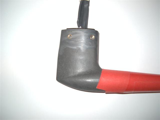

PostPosted: Fri Dec 28, 2007 7:25 am    Post subject: Gretz Pitot Instructions Reply with quote
Yes grind away… It is really soft material so “grind” lightly. I actually used the scotchbrite wheel on my benchtop grinder. Go slow and keep test fitting it to the mount as I imagine “adding back” material is a PIA. The attached photo shows what mine looks like after modifying. I recall most of the removal of material was the aft edge and then thinning it a little starting roughly in the center of the screw holes and going forward. I remember having to remove material a lot farther down from the screw holes than what you would think when looking at the mount holes. You can see the color difference in the photo.

PostPosted: Fri Dec 28, 2007 7:47 am    Post subject: Gretz Pitot Instructions Reply with quote
Yep, just like Ben, I ground mine slightly. In my case it didn't
seem to require a heck of a lot of work. I used a file and checked
it often until it fit and the holes lined up. All in all, the
Gretz pitot was very simple to mount. I can't say how well it keeps
ice off, as I haven't been in bad ice, but I can say that it seems
to operate as intended. Once it warms up, the light goes out,
and it cycles as necessary. It should be warm enough to keep ice
from sticking.
If anyone has more questions or thinks I f’d something up please let me
know!
-Ben Westfall
#40579
N109LB (reserved)

DAVELEIKAM(at)wi.rr.com
PostPosted: Fri Dec 28, 2007 8:22 pm    Post subject: Gretz Pitot Instructions Reply with quote
I had to grind a bit off the pitot where it slides into the mount. I used the scotchbrite wheel and took a small amount off at a time until it fit snug. Pretty straight forward.
