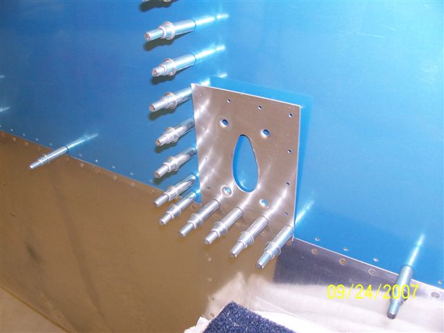

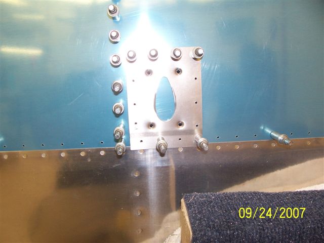

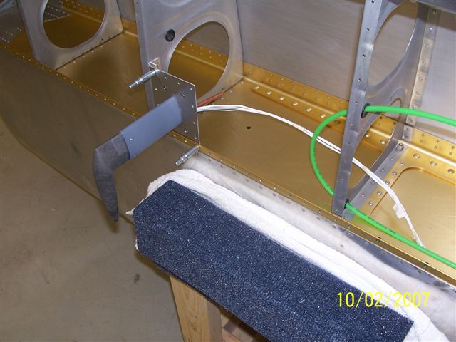

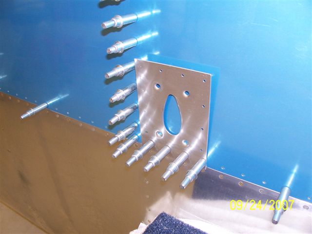

Posted: Sat Dec 22, 2007 6:52 pm Post subject: Gretz pitot instructions |
I used the mount for a template and drilled and traced for the hole after clecoing it over the skin. Then I used my step drill to enlarge the mount hole. Then trimmed the hole to the line with my dremel. I mounted the thing in the bay just outboard from the aileron inspection cover. The circuit board is mounted to the inspection cover itself. Makes the wire connections easy to get at.
Dave Leikam

Although not technically that difficult to install think about
maintaining it after installation. I did not think about install or
location when I cut the holes for my bracket which I ended up putting it
in the stock Van’s pitot location. It worked out ok but I had several
technical hurdles to overcome.
The copper tube coming out of the pitot tube itself came straight up
into the aileron torque tube requiring a healthy bend to maintain
clearance while the tube moved fore and aft. The mounting locations for
the circuit board in this location are sub optimal for ease of wire
installation and maintenance due to the aileron pushrod and bellcrank
parts. Think about threading the wires up through the pitot tube hole
and guiding them into their install location on the circuit board and
then tightening the miniature screws. You also have to secure the
aluminum pitot line to the copper line through an inspection hole after
installing the bottom wing skins.
Pictures of my installation can be found here:
http://www.sinkrate.com/rv10/pics.asp?f=wings|pitot
I ended up making short length wires and connectors that I could attach
to the circuit board prior to closing up the wing. I used a locking 2
wire molex plug for the power wires and dean’s plug for the thermistor
wires. My thoughts were to make the actual installation of the tube
into the finished wing easier. One thing to think about too is what
happens to moisture that may accumulate on the wires? The circuit board
should be on the top side of the wing so all wire runs coming out of the
unprotected holes are not subject to water droplets running down the
wires and into their attach points. I am considering encasing the wires
in silicone but have not yet done that.
