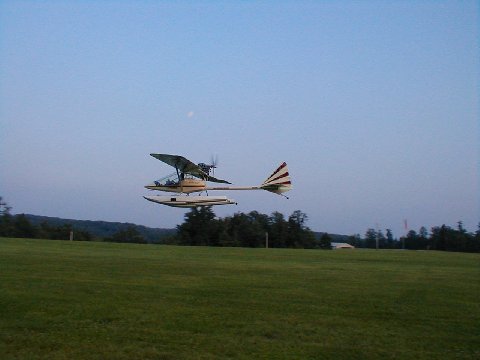

PostPosted: Sat Dec 22, 2007 5:35 am    Post subject: Mission Specific Reply with quote
Click here: 20 Aqualane Dr, Winter Haven, FL 33880, USA - Google Maps
150 feet, Glassy Water, No Pig Here
My Playground, Notice all the lakes and also Lakeland Airport to the west. Click on the map link above.
By the Way, Very few aircraft of any kind can be off and gone in 150' on Glassy water.
Steve B
Firefly 007/Floats

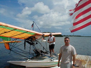

Steve Boetto
Joined: 11 Jan 2006
Posts: 365
PostPosted: Thu Dec 27, 2007 7:20 am    Post subject: Mission Specific Reply with quote
In a message dated 12/26/2007 9:39:59 P.M. Eastern Standard Time, d-m-hague(at)comcast.net writes:
I like the idea of the mono float for the US, to keep the spray off the prop.  One thought I had was two floats (so you get the 60#) very close together, with a solid web between (almost like a tunnel hull racing boat).
Ray,
EP Dalton in KEY West offers a splash guard for the quicksilver Sprint 2 just as you described
Steve
Firefly 007/Floats

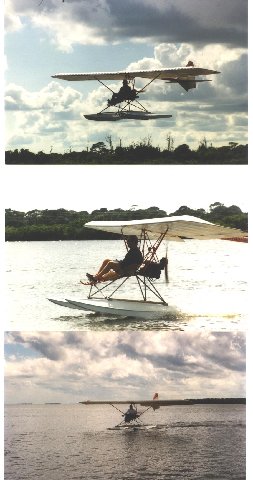

Steve Boetto
Joined: 11 Jan 2006
Posts: 365
PostPosted: Thu Dec 27, 2007 7:25 am    Post subject: Mission Specific Reply with quote
Dana,
This is a shot from a few years ago of the Factory Xtra flown by Bryan Melborn on Boetto/Melborn Experimental Amphib Floats. Kolbs look great on Floats.
Steve

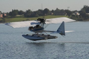

Steve Boetto
Joined: 11 Jan 2006
Posts: 365
PostPosted: Thu Dec 27, 2007 7:39 am    Post subject: Mission Specific Reply with quote
As far as I can see, there is no mention of mono floats, just "30 lbs per float". In the case of flying boats, it's still 30# (plus the 10 for each outrigger).
I like the idea of the mono float for the US, to keep the spray off the prop. One thought I had was two floats (so you get the 60#) very close together, with a solid web between (almost like a tunnel hull racing boat). You could still add outrigger floats if necessary.
I still think I'd rather go into, say, a plowed field with non amphibious floats than straight wheels. There are quite a few videos on youtube of seaplanes landing (and even taking off!) on wet grass.
-Dana
Dana, Have you done any water flying, There is a major difference in Seaplanes (MonoHull) and Floatplanes.
Water Handling
Looks
Flight qualities
I personally like the look of a Floatplane and everthing that goes with it. Mono floats added to land plane tend to look Goofy.
Rare photo of Ultrastar on floats
Steve
Firefly 007/Floats
See AOL's top rated recipes and easy ways to stay in shape for winter.
 Filesize:  30.69 KB
 Viewed:  409 Time(s)
Dana
Joined: 13 Dec 2007
Posts: 1047
Location: Connecticut, USA
PostPosted: Thu Dec 27, 2007 10:16 am    Post subject: Mission Specific Reply with quote
Water Handling
Looks
Flight qualities
Rare photo of Ultrastar on floats...
That DOES make a nice looking floatplane!
Sadly, I have done no float flying, other than as a passenger years ago, and a number of R/C seaplanes over the years. I'd like to change that though... and the airport I'm currently flying from is right on the river and has a seaplane ramp. I agree that a mono float would look goofy on a high wing plane, but with the twin float spray shield it wouldn't be an issue (i.e. there'd be no point to a mono float). I'd be interested to know how the Ultrastar behaved on floats... quite well, I imagine.
-Dana

Steve Boetto
Joined: 11 Jan 2006
Posts: 365
PostPosted: Thu Dec 27, 2007 6:01 pm    Post subject: Mission Specific Reply with quote
In a message dated 12/27/2007 1:17:48 P.M. Eastern Standard Time, d-m-hague(at)comcast.net writes:
-Dana
According to my friend it was very quick off the water and flew very nice.
