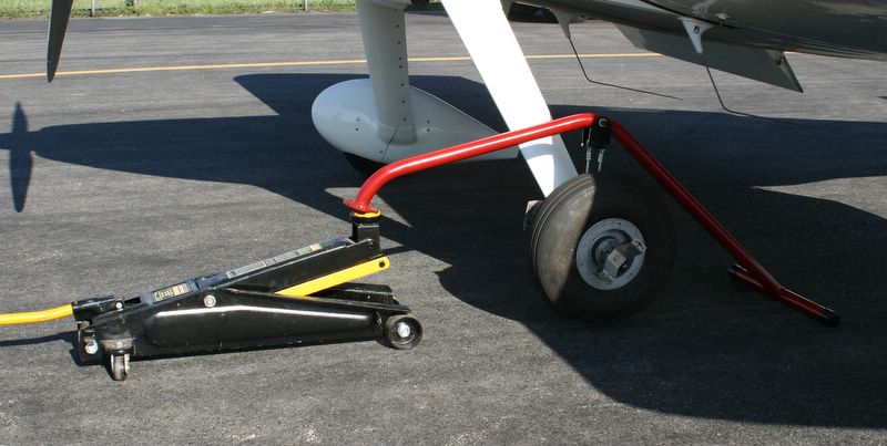

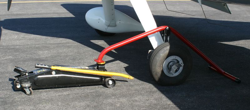

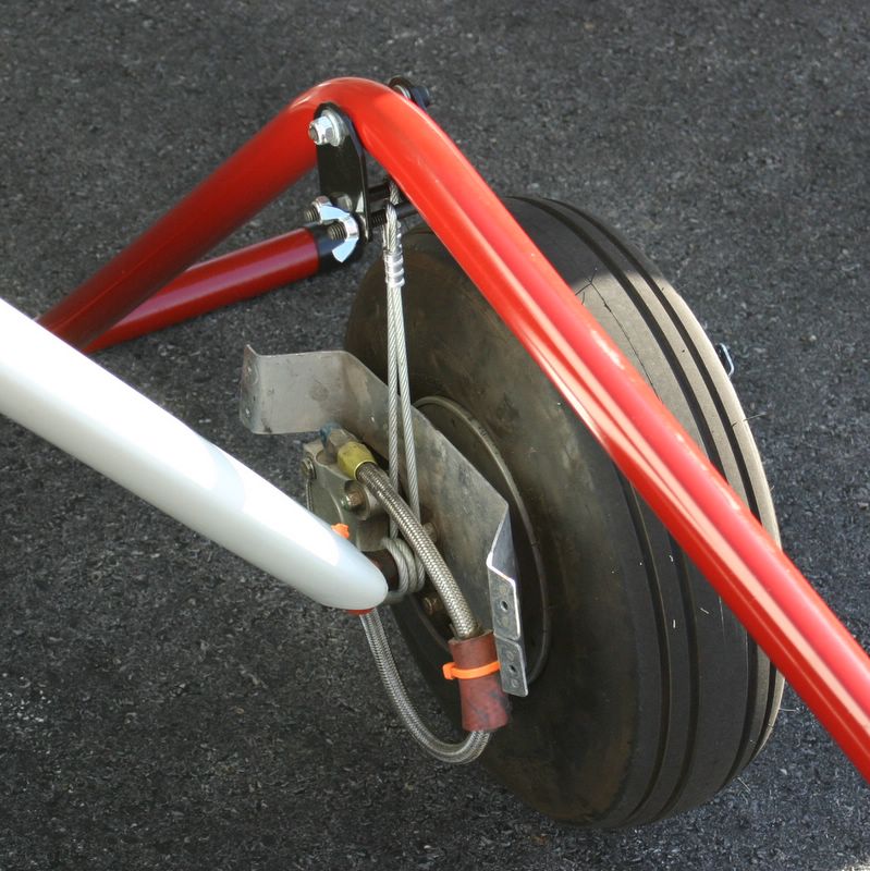

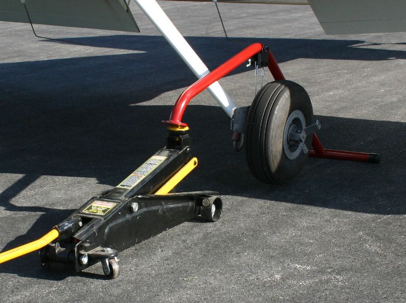

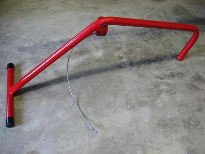

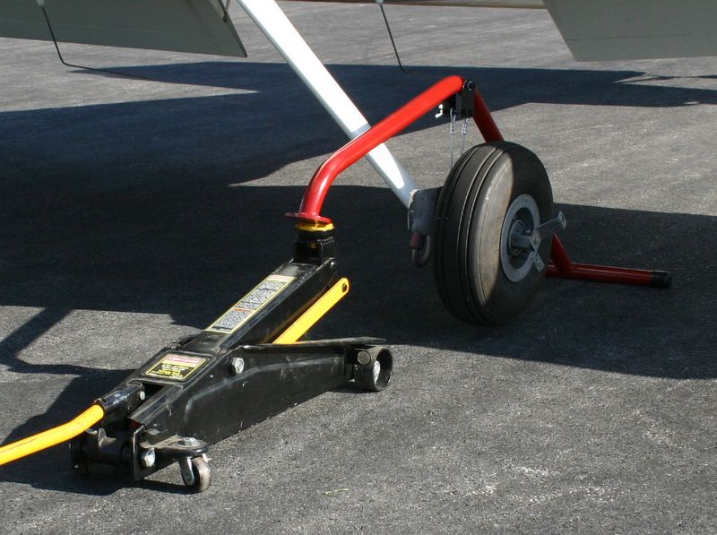

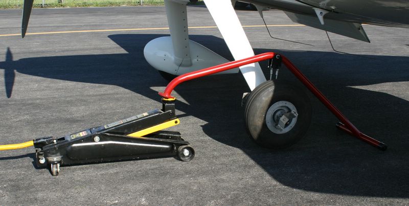

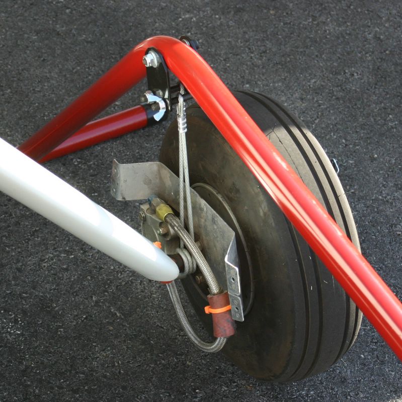

PostPosted: Mon Oct 22, 2007 12:23 pm    Post subject: Gear Legs wheel replacement Reply with quote
Dave,
I got this somewhere. Whoever came up with it should realy get the credit
but I don't know who that is. It seemed simple enough to duplicate that's
what I planed to do.
John D.

mike109g6(at)insideconnec
PostPosted: Mon Oct 22, 2007 12:53 pm    Post subject: Gear Legs wheel replacement Reply with quote
Brown tools or Avery sells it. I just saw it.
Mike H

PostPosted: Tue Oct 23, 2007 5:14 am    Post subject: Gear Legs wheel replacement Reply with quote
Yes,
Works as advertised. I got one of these a week ago and was able to easily change a tire with no swapping of jacks, blocks and so forth.
While its an expensive little bugger, im hoping between my use and loaning out to buddies, it will pay for itself.
No reason why it would not work on all kinds of planes too. The pipe in the axle method requires a hollow axle. This gismo does not.
Link to site here that sells the "handy Jack". Site d/l time is ridicules for some reason.
http://aviationtechproducts.com/html/products_pics.html#RVJACK
Best,
Mike
