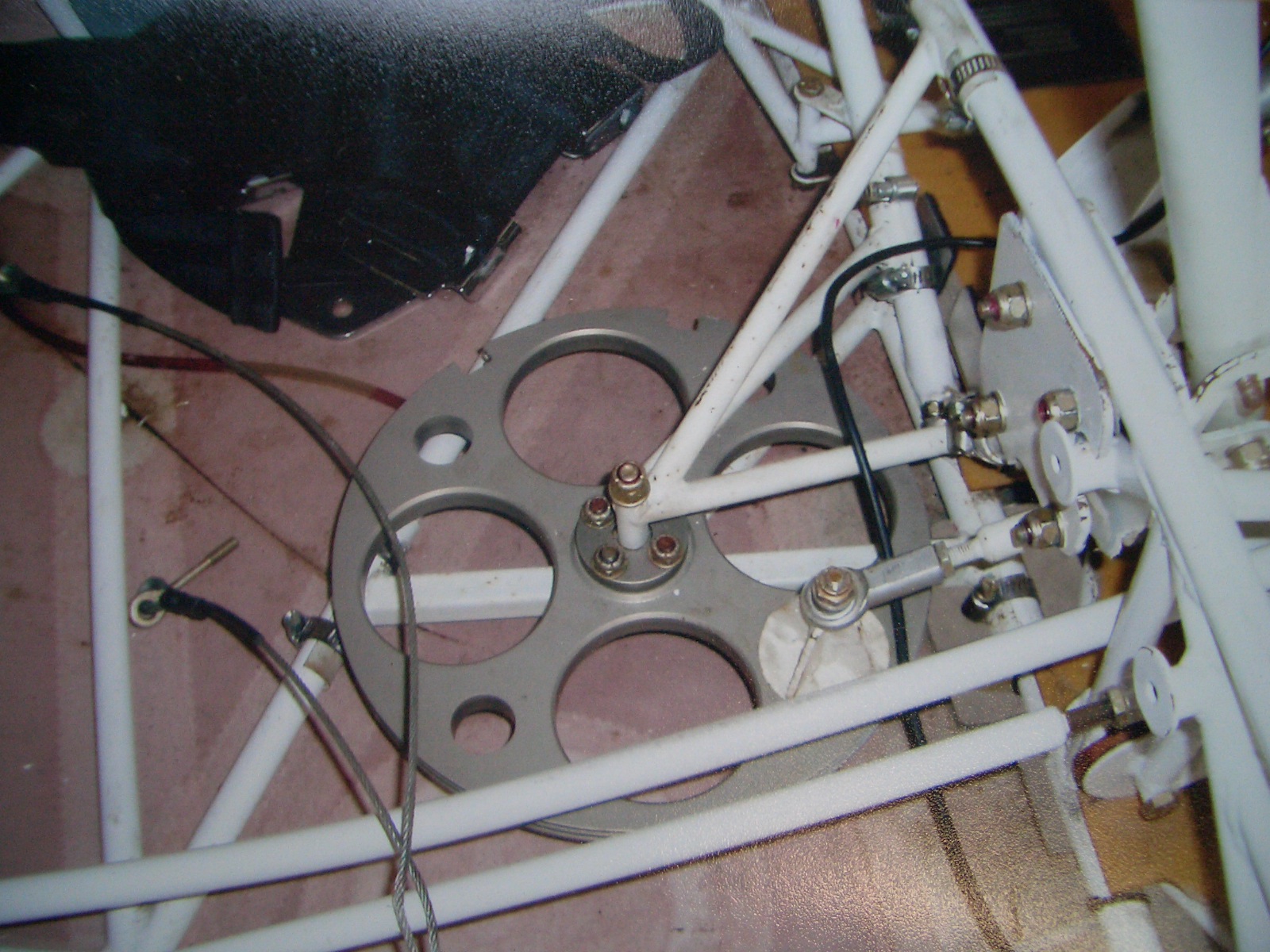

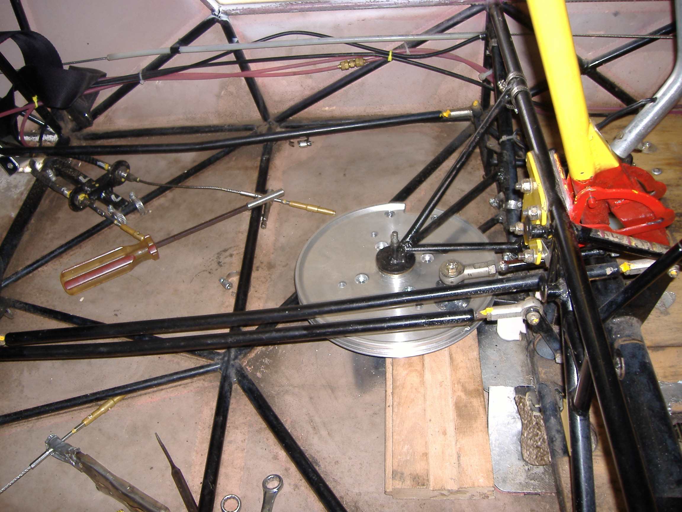

The Johnson bar goes to the left of the elevator rod.
I enclosed pic of my Bull wheel set up i made from scratch for my aerocet 1100s .
Mine all attaches with hose clamps, no drilling of tubes needed.
Picture of Kitfox Bullwheel setup

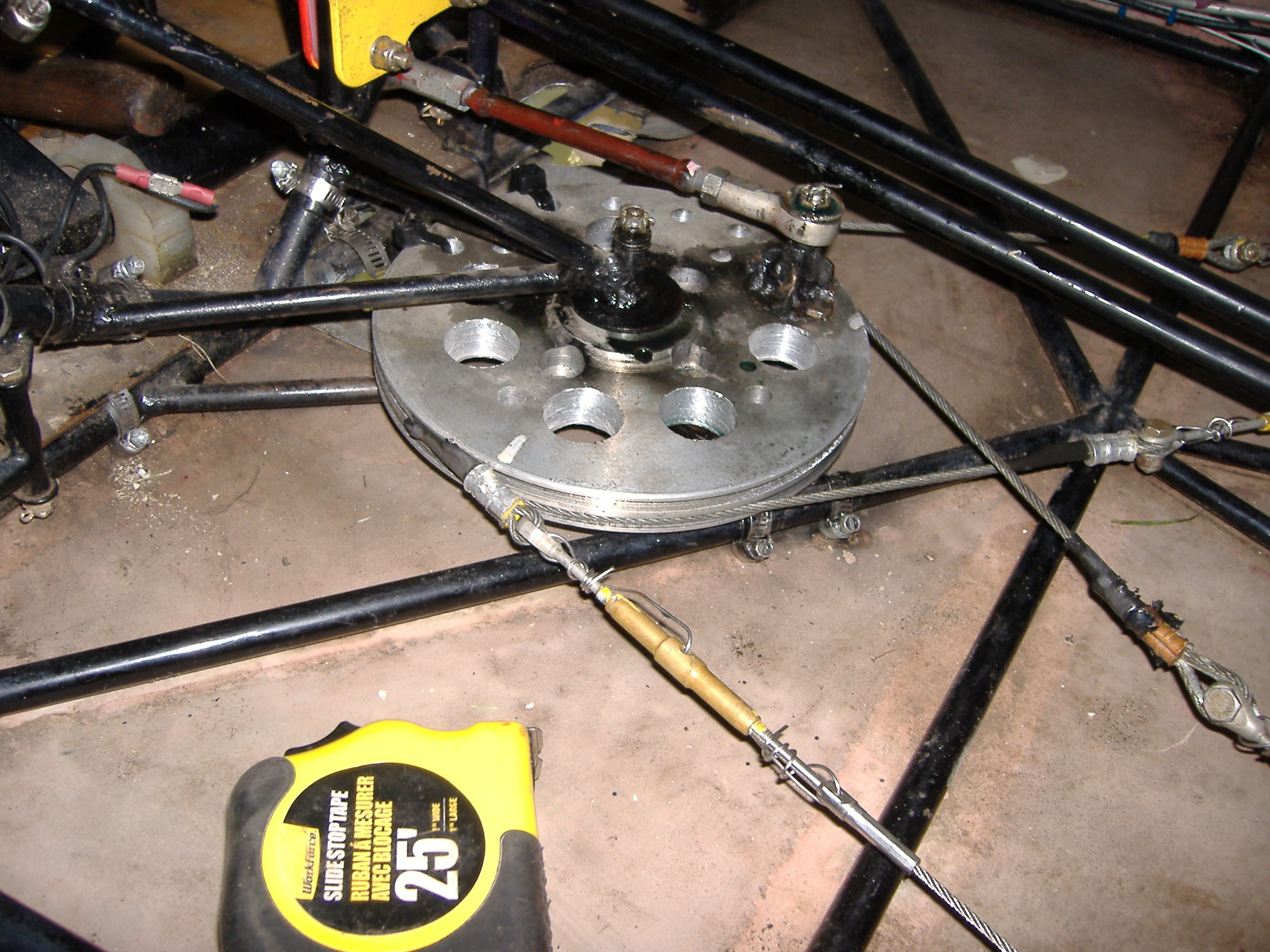

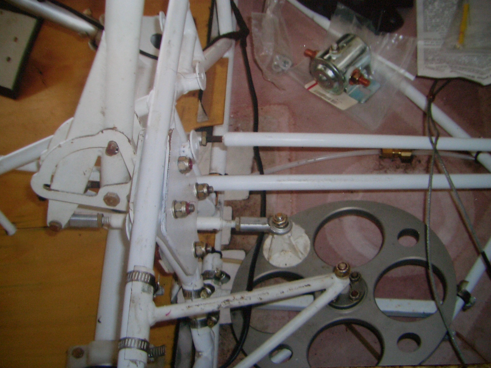

will send you some pics I have

Thanks...those pixs really helped....couldn't figure out where those cable brackets went till now...this is a neat setup....everything is inside the struts and floats....WOW

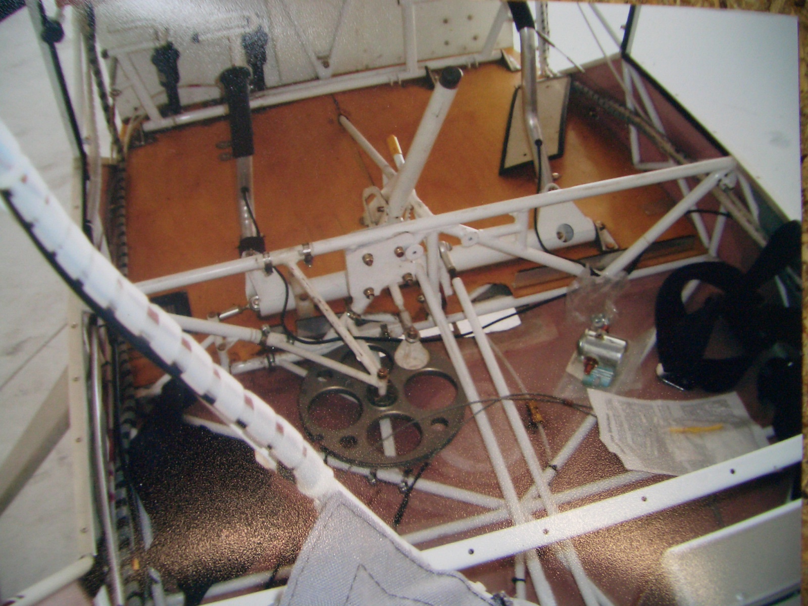

Larry here is another pic for you
Aerocet 1100 Amphib gear

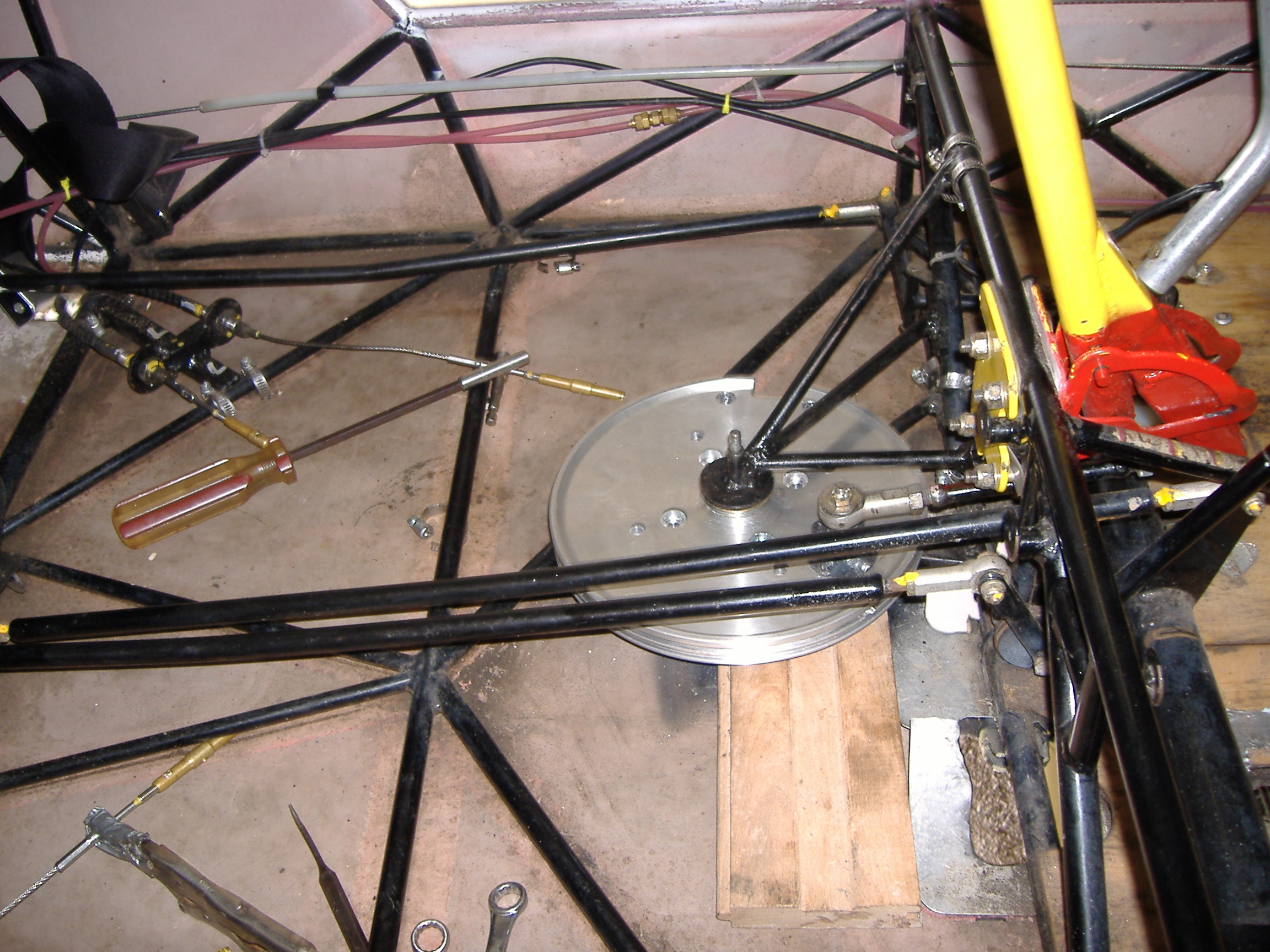

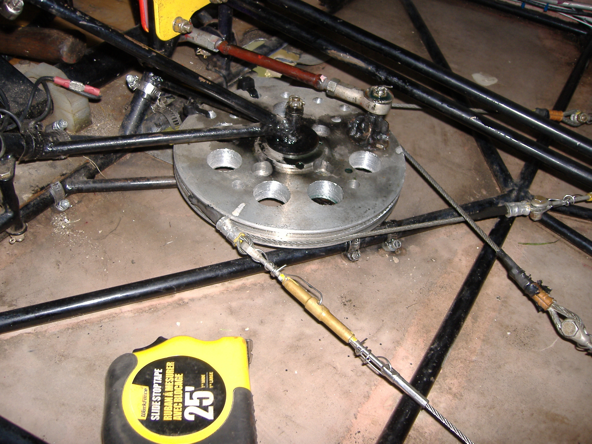

A few more...
 Filesize:  581.48 KB
 Viewed:  741 Time(s)
 Filesize:  580.86 KB
 Viewed:  739 Time(s)
 Filesize:  581.31 KB
 Viewed:  740 Time(s)
