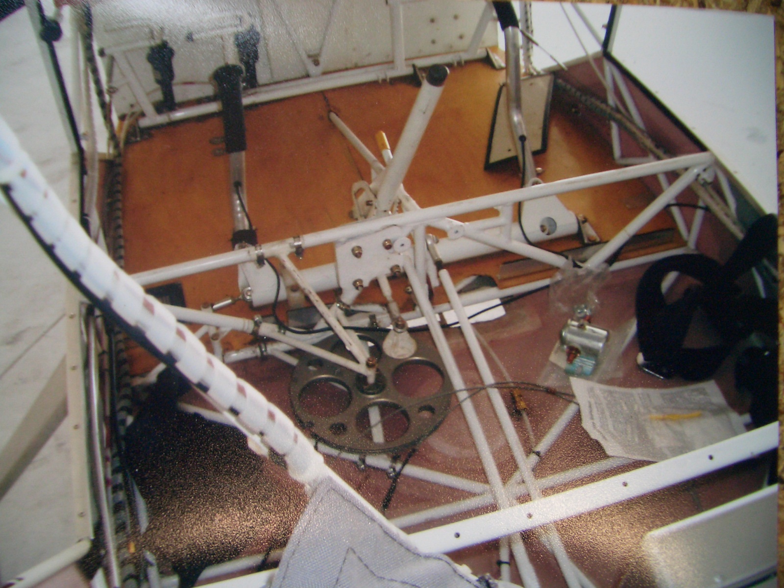

Have these off another kitfox...now adding to mine....I have the manual ones with the bar. Biggest challenge is how and where to mount the control bar in the cockpit. Any help/pixs/measurements would be appreciated. If you know alot about these, please call and I'll have you talk to the a&p helping me

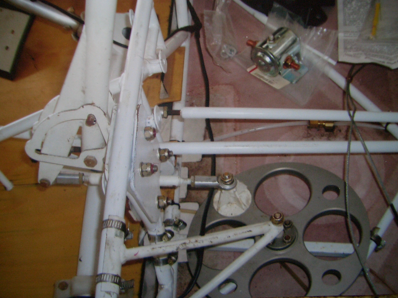

The Johnson bar goes to the left of the elevator rod.
I enclosed pic of my Bull wheel set up i made from scratch for my aerocet 1100s .
Mine all attaches with hose clamps, no drilling of tubes needed.

thanks for the reply....still need more info....where could I download an install pdf file .....???
more pixs of the cockpit installation please....have the bullwheel....

will send you some pics I have

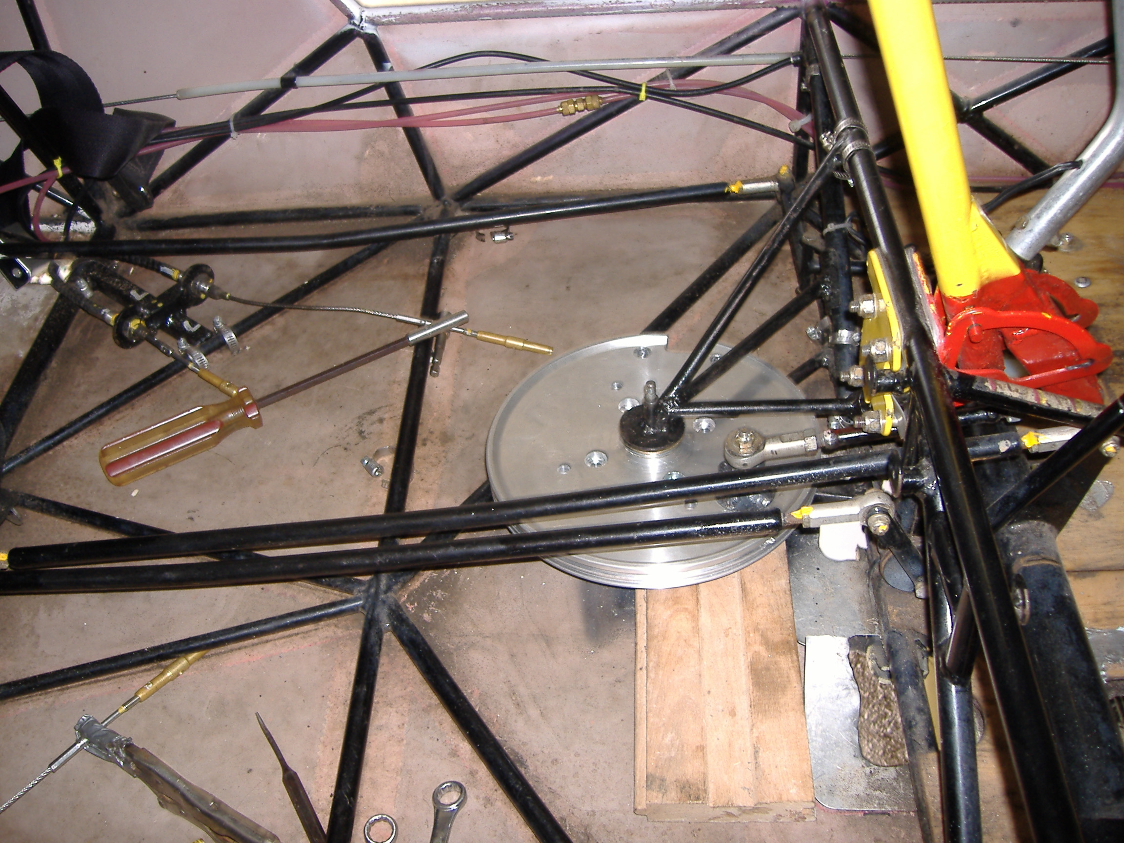

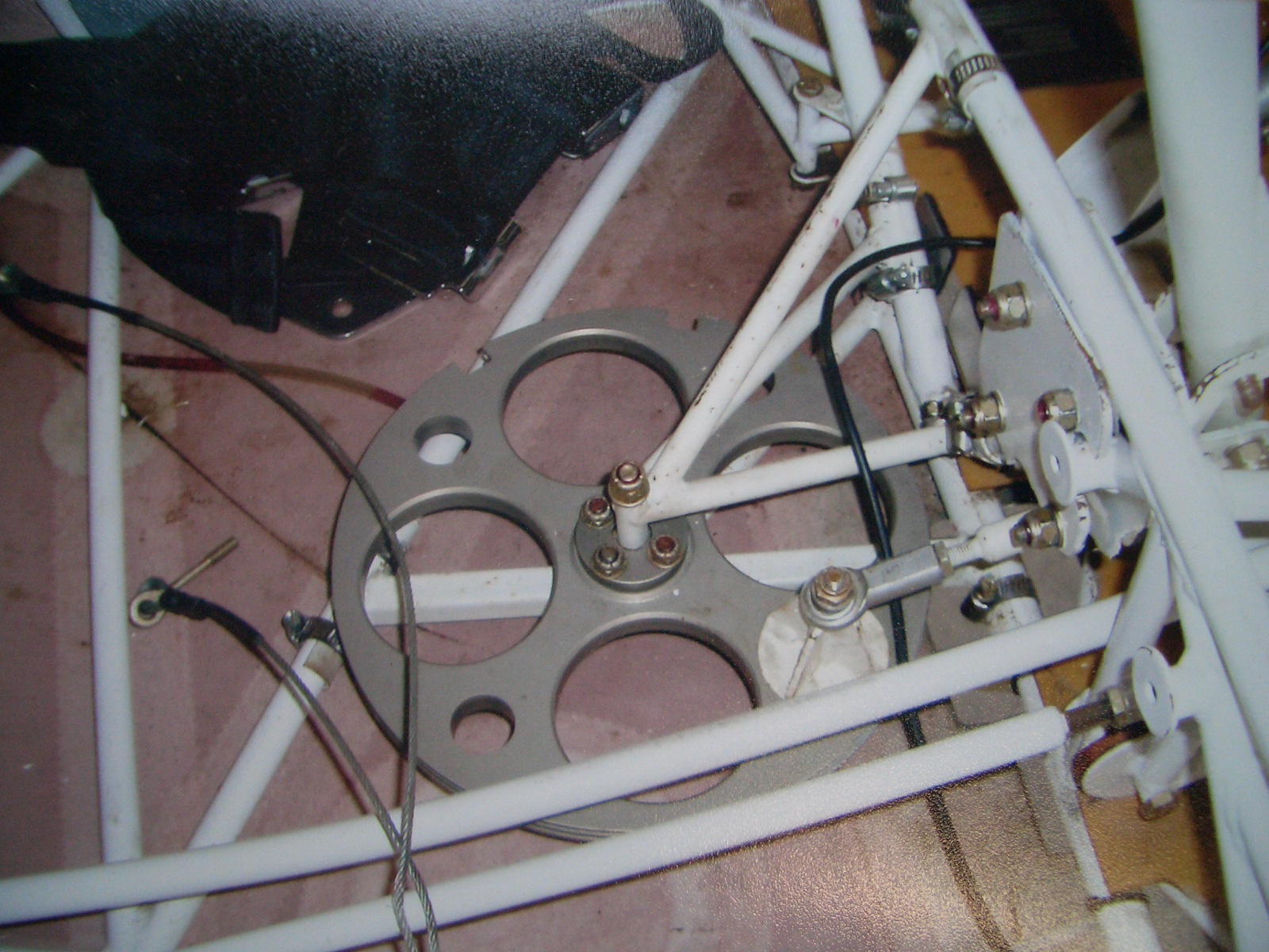

Thanks...those pixs really helped....couldn't figure out where those cable brackets went till now...this is a neat setup....everything is inside the struts and floats....WOW

Larry here is another pic for you

A few more...
