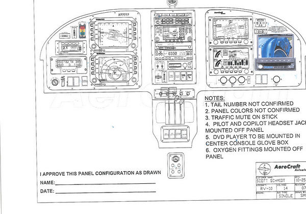

Has anyone installed one of the Lancair panels with the Throttle quadrant?
I am looking for pictures of one.

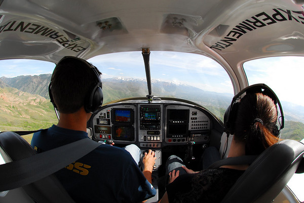

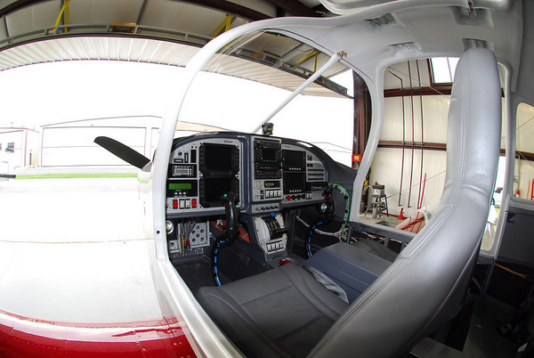

PostPosted: Tue Sep 04, 2007 1:42 pm    Post subject: Lancair Panel Reply with quote

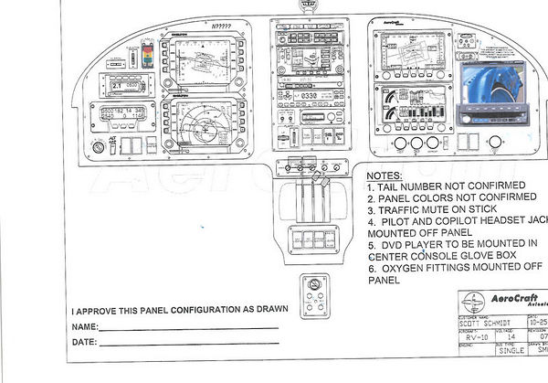

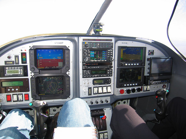

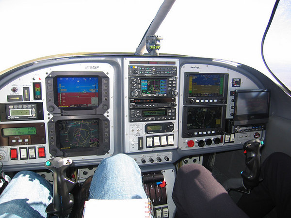

Here are a few. Let me know if you want more offline. I moved the console back about 1" from what
the stock setting is to give my hand more room between the throttle and dimmer knobs. This
also meant all new custom cables for the throttle.

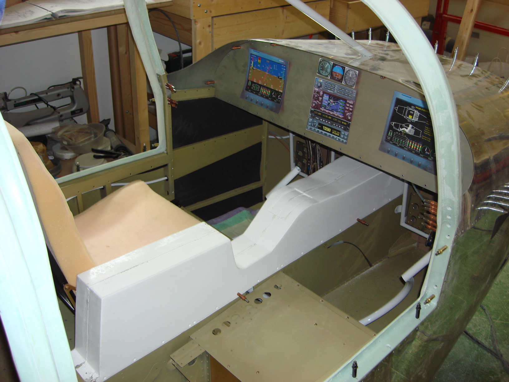

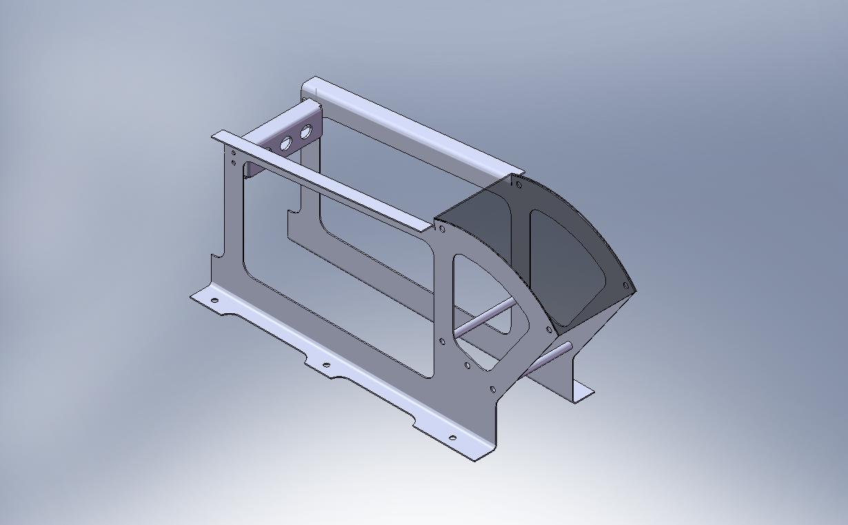

PostPosted: Wed Sep 05, 2007 11:33 am    Post subject: Re: Lancair Panel Reply with quote
Scott,

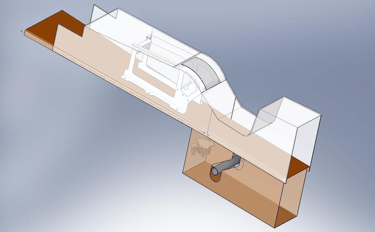

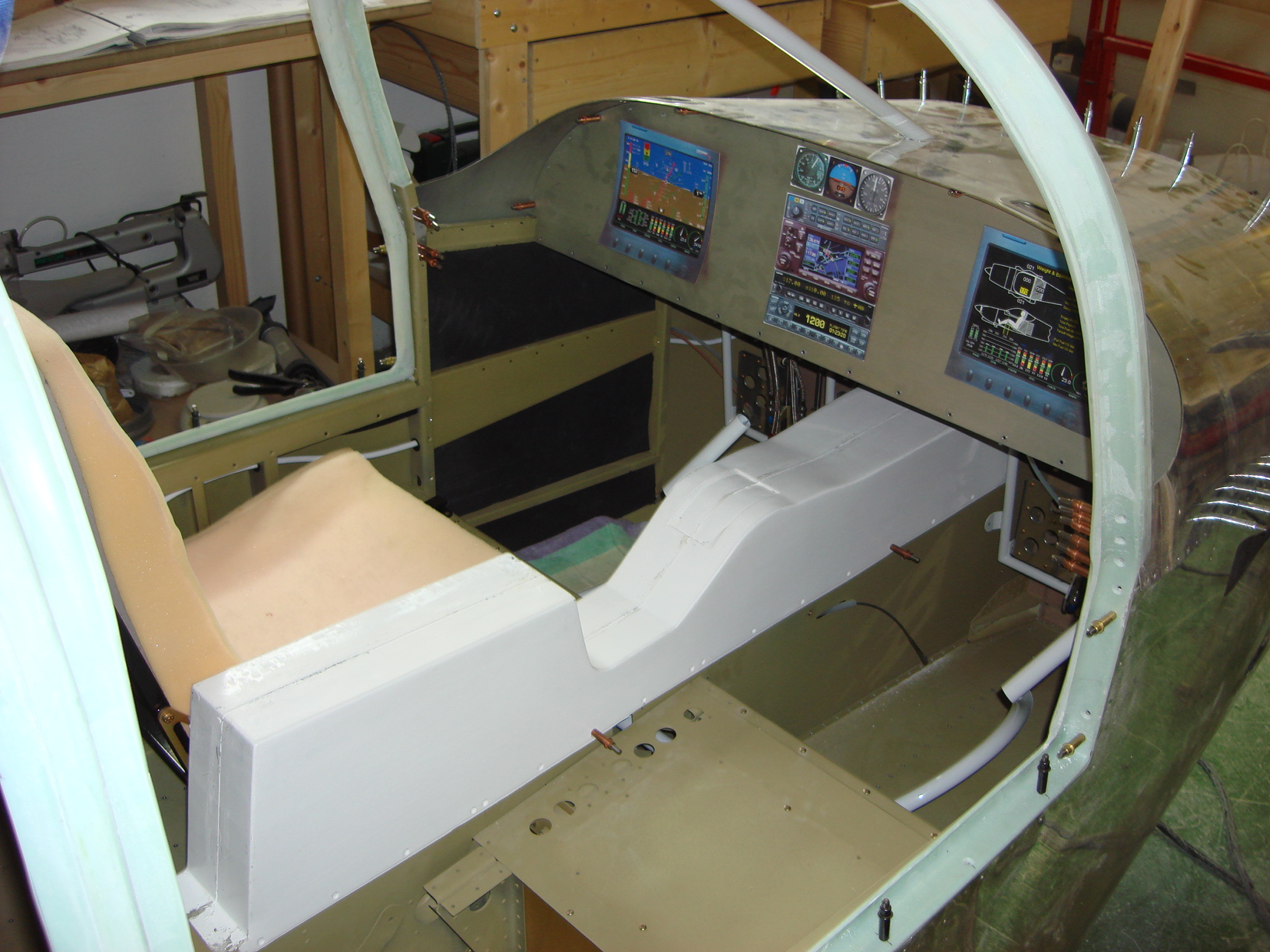

where can I order the cables for throttle, Mixer and Prop to the length required?
I use the center console from Henkjan so this puts the throttle at least 3 inches back. I also had to construct new mounts for the throttle quadrant (see attached CAD pictures).
Michael

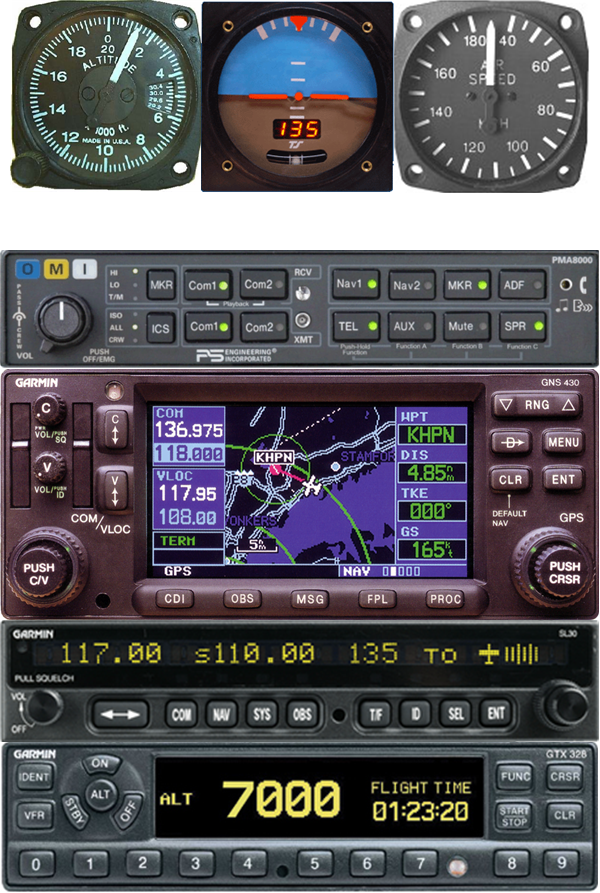

PostPosted: Wed Sep 05, 2007 1:29 pm    Post subject: Lancair Panel Reply with quote
Michael,
John Cox has offered several builders assistance in getting custom cables
made. Check with him.
On another note...
In looking at your panel mockup in one of the pictures it appears we are
planning a very similar panel. Are your paper printout instruments to
scale? How did you do that? If the graphics are already to scale that you
have can you email me the files to print maybe?

PostPosted: Wed Sep 05, 2007 5:10 pm    Post subject: Lancair Panel Reply with quote
Michael,
Based on the position of your avionics stack you may want to check the clearance with the middle bracket. The depth of the Garmin 430 with connector is 11 inches and if you leave your stack in that position, you would have to cut a LOT of the middle bracket away. The Garmin 330 is also lengthy at 11.5 inches. The distance between the instrument panel and the middle panel is 9.5 inches. For this reason, I left the middle bracket untouched and put my avionics stack just to the right of it.
http://wcurtis.nerv10.com/91Panel/index.html
http://wcurtis.nerv10.com/08fuselage/fuselage31s.html

PostPosted: Wed Sep 05, 2007 5:16 pm    Post subject: Lancair Panel Reply with quote
Lancair supplied me with a few different panel designs and I then started taking pictures off the Internet, imported them into Photoshop and started laying different ideas out.
I used Photoshop to reduce different pictures from the Internet.
I think my final version with Lancair was v.14 by the time I was finished.

PostPosted: Wed Sep 05, 2007 5:19 pm    Post subject: Lancair Panel Reply with quote
What I did was hook up the cables that Van's sent me to the engine side and then measured the additional length I would need to tie them into the throttle quadrant.
I called Van's direct and they took the old cables back, and ordered new custom cables. They said it could be 4 weeks but showed up in about 10 days.
Scott Schmidt

PostPosted: Wed Sep 05, 2007 10:50 pm    Post subject: Re: Lancair Panel Reply with quote
Thanks for the advice guys,
I actually just pinned some pictures of my desired avionics on the panel to get a more realistic feel while making plane noises Wink
I am currently designing my panel also in the 3D CAD system but once I have a virtually solution I will transfer it into scale pictures and put it into the cockpit. I had to wait until I can sit in the plane to really feel the distance and ergonomics.
I bought the VP-200 and in Osh and now have to see where I will put it.
Maintenance accessibility is important, how many times did you guys (flying) had to open the tunnel so far and what for?
Michael
Since I got some requests about the avionic stack pictures I attached the file for printout. However I don´t know if this is to scale because it is a Visio file originally.
www.wellenzohn.net

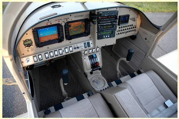

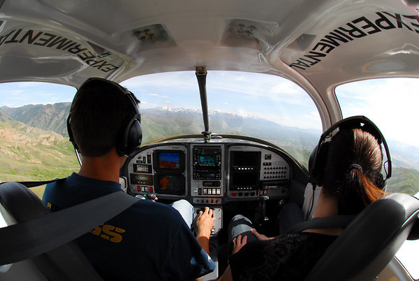

PostPosted: Fri Sep 07, 2007 11:49 am    Post subject: Lancair Panel Reply with quote
Rob,

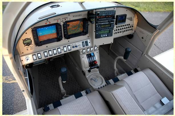

The attached photo of an early Lancair panel with a quadrant is from Tony Sustare of Accuracy Avionics.
John
