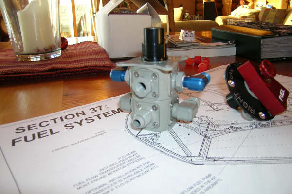

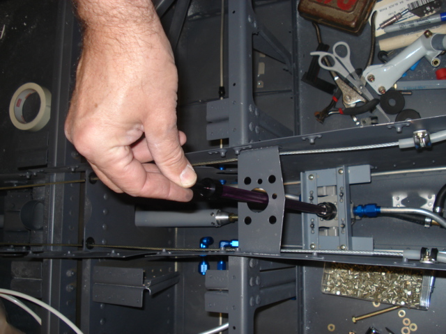

I also used the Andair setup, just in Duplex form. Like Tim I would
recommend using the 12" extension, this makes it very easy to place the
valve at the bottom of the tunnel and freeing up allot of room for the
SCAT tubing to pass through.
You can see in the attached photos, specifically 134 what Tim was
talking about needing to get the valve level so that the extension will
pass through the upper whole in the tunnel. I made the bracket at the
bottom with a cross support that way I could use washers to adjust the
fore and aft angle on the extension.
In the 405 photo you can see the different fittings offered from Andair,
in hind sight there are several things I would have changed on my
original order from Andair, as it was a bit of trial and error in the
beginning. On their website http://www.andair.co.uk/ , the automated
configuration tool does not show all of the optional fittings in
building the valve, you have to call for these, but what I ordered was a
duplex and you will only need a single, but the important part is to go
to the accessories page and get the EF20 for your two side fittings and
then use the MF20 for your feed to the bulk head
http://www.andair.co.uk/system/index.html with these fittings installed
it makes it a very simple and clean install and you can use single
flared fittings at each location rather than having to use
adapters/elbows etc.

I need to weigh in on this one. I have an Andair valve installed in
our Glastar and we did have an issue with their Female Pipe Thread
inlets. I am installing an Andair valve in my RV-10 but with the
following note.
In the glastar, like the Rv-10, a 90 degree turn is needed after
exiting the valve. To do this we installed 90 elbows (AN822), AN flare
to male pipe thread. We had a terrible time getting the pipe threads
to seal with the proper clocking of the elbows. We tried many types of
sealant including the highly recommended Fuelube, Finally the only
thing that seemed to work was a product called Blue-Block which is much
more viscous than other sealants I've used and rated for gasoline. It
worked from 1999 till our conditional inspection in Nov of 2006. I
found that these fitting were still weeping fuel. I removed the
fittings and changed them over to the new modular 90 degree cast AN-6
series fittings that Andair now makes, thus completely eliminating the
tapered pipe thread connections from the system. (now flared AN
connections bolt right up to the Andair Valve heading in the right
direction).
The engineer in me though says, what caused these pipe threads to not
seal? Upon inspection of the old andair female pipe thread modular
adapters I noticed that the threads did not seem to be cut deep enough
into the part with respect to engaging the tapered thread. I believe
that this was causing the male pipe thread part (elbow) to bottom out
within the Andair part instead of allowing the joint to get suitably
tight by the tapered geometry.
So the lesson in my book is to check your fittings before assembly and
ensure they can fully engage.
On my RV-10 fuel valve I am using the one with the straight extension
and the cast 90 degree modular elbows.
Bob Newman

You may have a point there. I *think* when I trimmed off the
nose of the fitting and re-cut more threads on that, that I
also pulled off the andair female NPT fittings (using the
4 screws), and used a tap to tap the threads slightly
deeper there too. I am not 100% sure of this as it's been
a while, but I believe that's the case. This allowed me
to thread the elbow closer and further into the valve.
It's not uncommon in dealing with some NPT stuff, so I didn't
maybe make as big a deal of it as some might. I just
prefer all my threaded fittings to fit with a few turns
holding them together. I do think those andair fittings
would be ideal if they can be used in the application though.
Also, I believe Neal had it right with the valve part number
that would be nicer to use than what I did. You guys building
later in the cycle are lucky to have such improvements. Gosh,
I almost wish I was still in the building process.

You are right Tim, I had the same issue, if a builder were to use the
female NPT fittings, and try to fit in 90degree elbows on both sides the
valve assembly would be too wide to fit in the tunnel, this was the
issue I ran into and is why I then had to order the fittings Andair had
with the 90 degree already in it, you could also use the banjo fittings,
that way you would get a full 180 degrees of movement for placing the
lines exactly where you wanted them.
