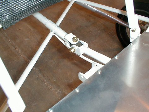

here is the old U-Joint.

| wow! never knew there was a tiny U-Joint in there. Looked them up
in AC spruce.
| Paul Petty
Did you look at the prices???
Wonderful.. this is what's on my FS II's linkage... Mine's a pre-TNK FS II finished in 98.....
So, is this a joint that has hazards and needs replacement or ?

I think it is just not as precision as what they are currently using. On the
other hand, it only needs to work in a Kolb, not in a watch...
Richard Pike
MKIII N420P (420ldPoops)
Ok, just curious if it was an AD that I needed to call Kolb about or something like that...
The plane has about 500 hours on it and hasn't seemed to have problems with this joint, so I was just wondering if it was something that just hadn't been updated but needed to be.....

I installed two of the new style U-Joints in my firestar when I rebuilt it a couple years ago and they are not cheap and not rubber coupled

All, Go to McMaster.com page 1121. At the top of the page is a picture of several different u-joints. The one on the left is what you'd find if you cut off the protective bellows of that AN unversal joint. They have bellows for these and for a given size can save you a few bucks over ACS.
