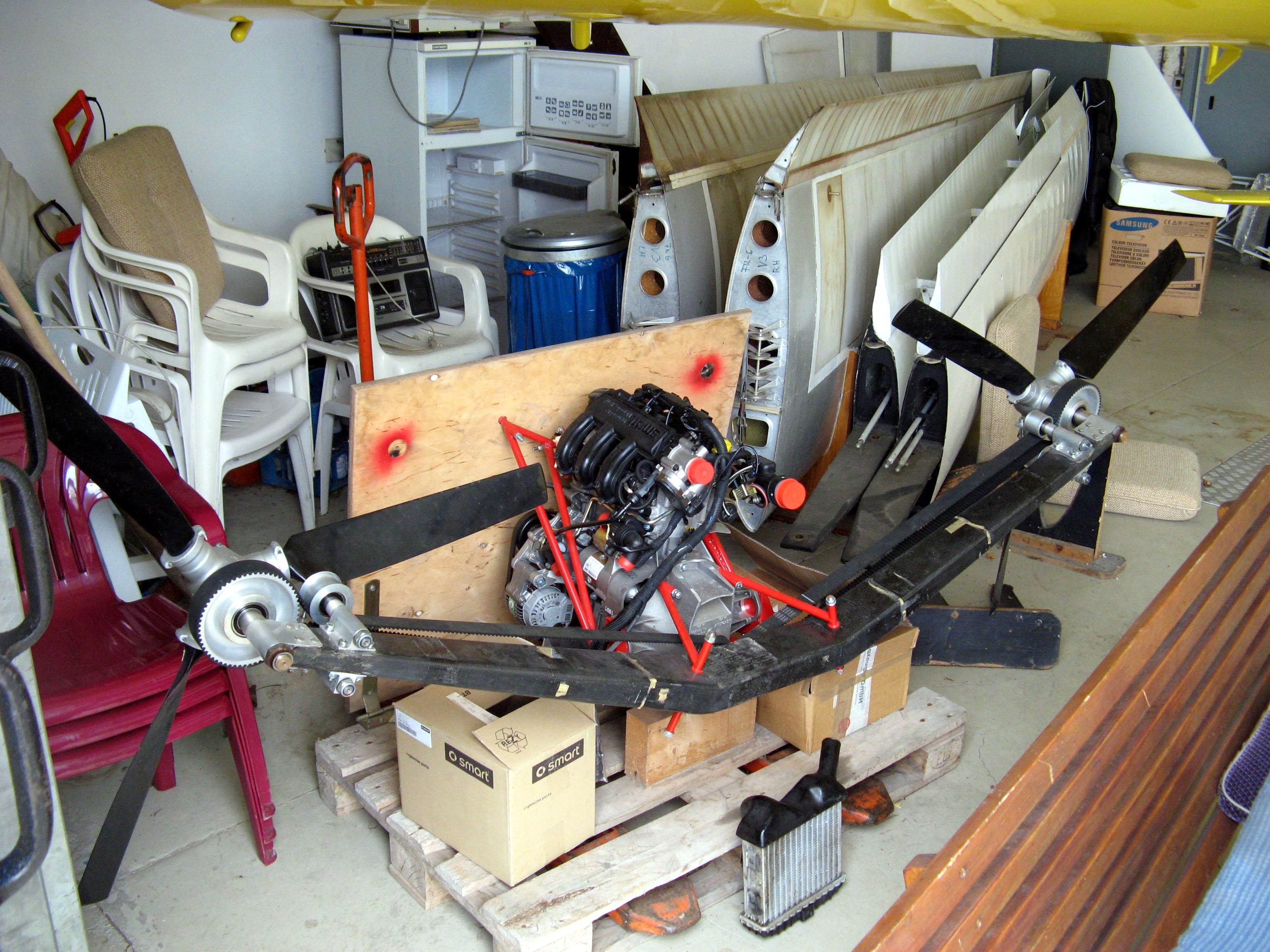

Now who was it that wanted a twin engine Kolb ?
Well OK, Not a twin but single engine driving twin props.
Interesting eh ?
David.

Interesting... what is it, what's it for?
-Dana

Some innovative design work there. Nice engine mount. The engine is
from the Daimler smart car,
3 cyl, 4 stroke , ??HP The problems of redrive and harmonics are
well taken care of. Hard to transmit
harmonics of any magnitude back through a belt that long. In
addition the props are in cleaner
air than if directly behind or front of the engine. The tail boom
can be located directly behind the
cabin even in pusher mode.
looks like a kraut mind at work :}
BB

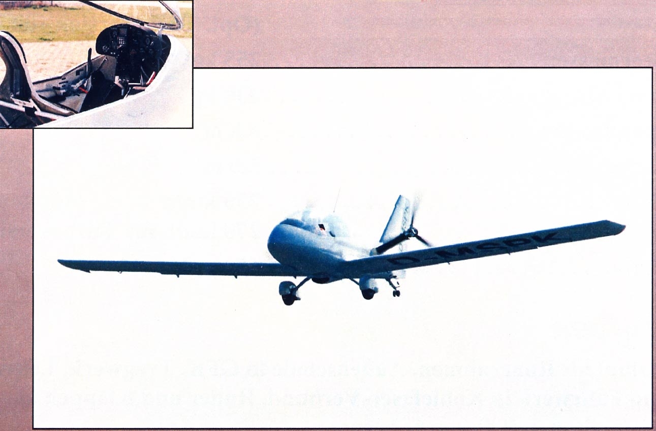

Slick BB got it ! The engine was developed from the 'smart' city car, a 700cc 3 cylinder turbocharged engine producing around 80HP at 5250 RPM with a 2.1 : 1 reduction belt drive and its quiet ! http://www.ecofly.de/english.htm
Thought it might be quite suitable for a Kolb, but it's also quite pricey at around €11,000 = US$ 14,500. Their flight tests say it equals or outperforms the Rotax 912 in all phases of flight.
The twin prop drive idea is for a pusher design the same guy was developing with the props out in clean air. I've added a photo from a brochure so it's not too good quality, just FYI.
Now who was it that was going to put two engines on their Kolb ?

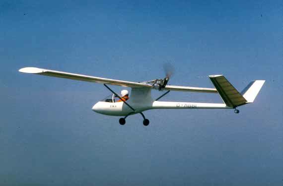

PostPosted: Mon May 28, 2007 4:11 am    Post subject: the things you find on the hangar floor ! Reply with quote
Mr Funk also designed this in 1984
Has a familiar look about it
BB do not archive
